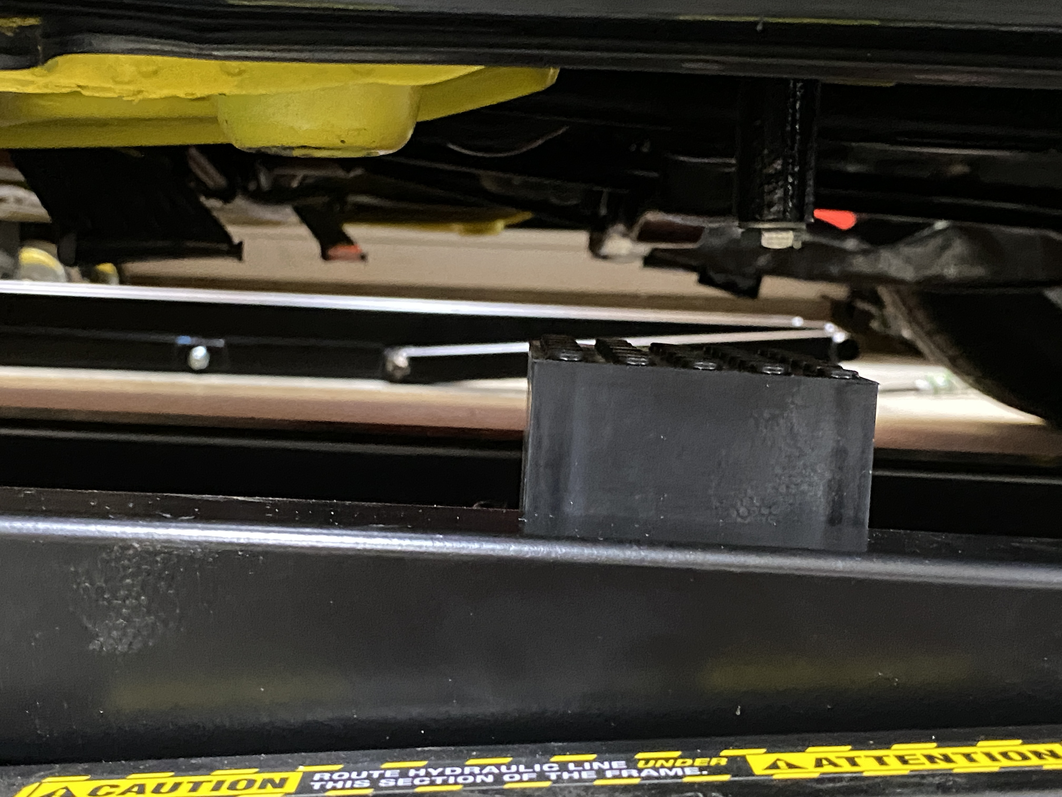

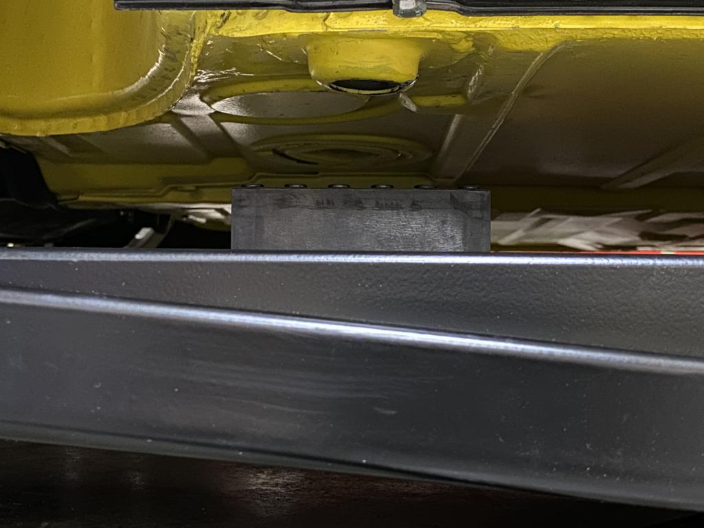

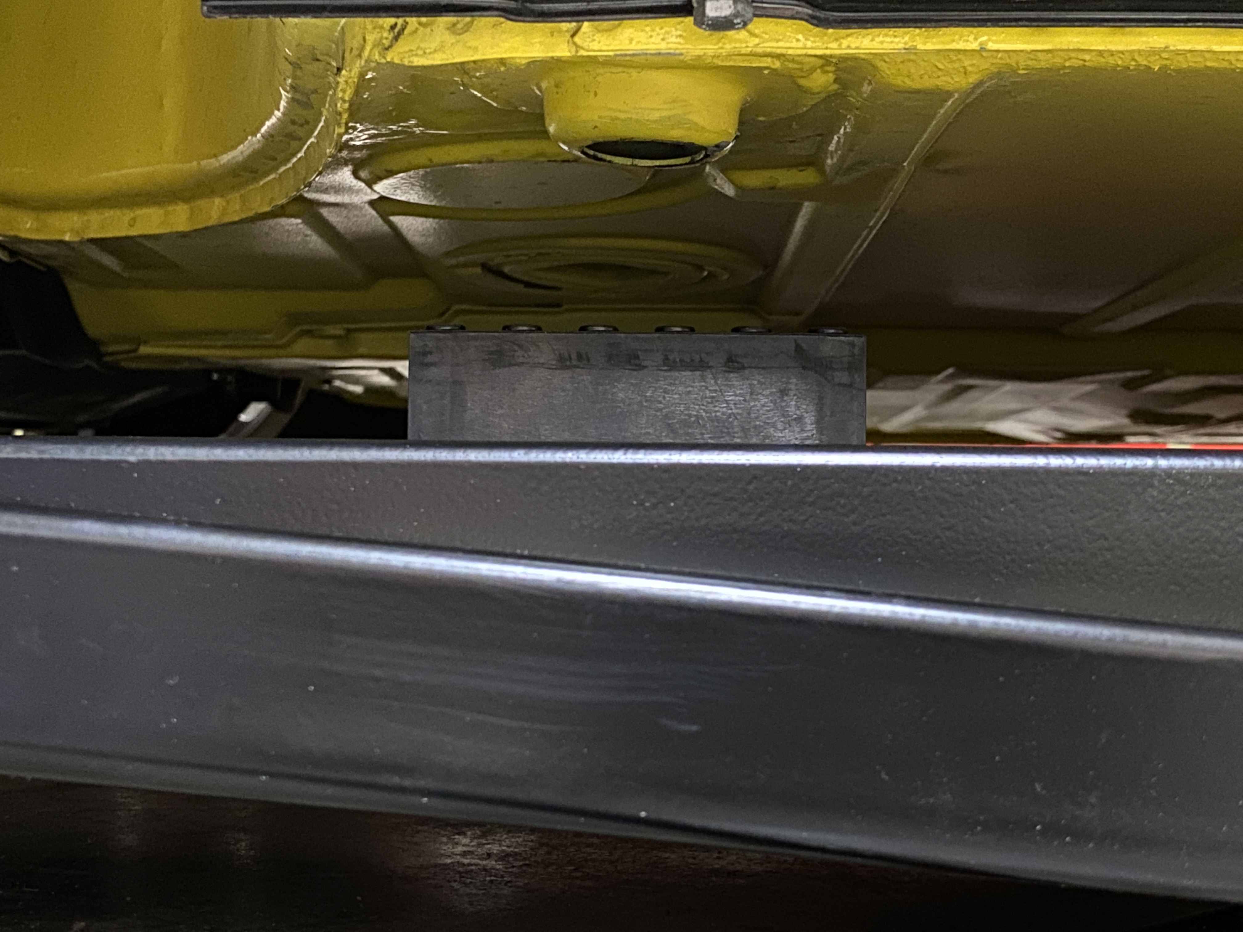

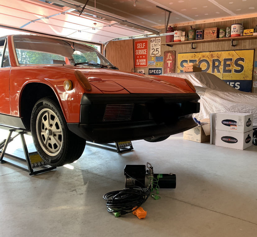

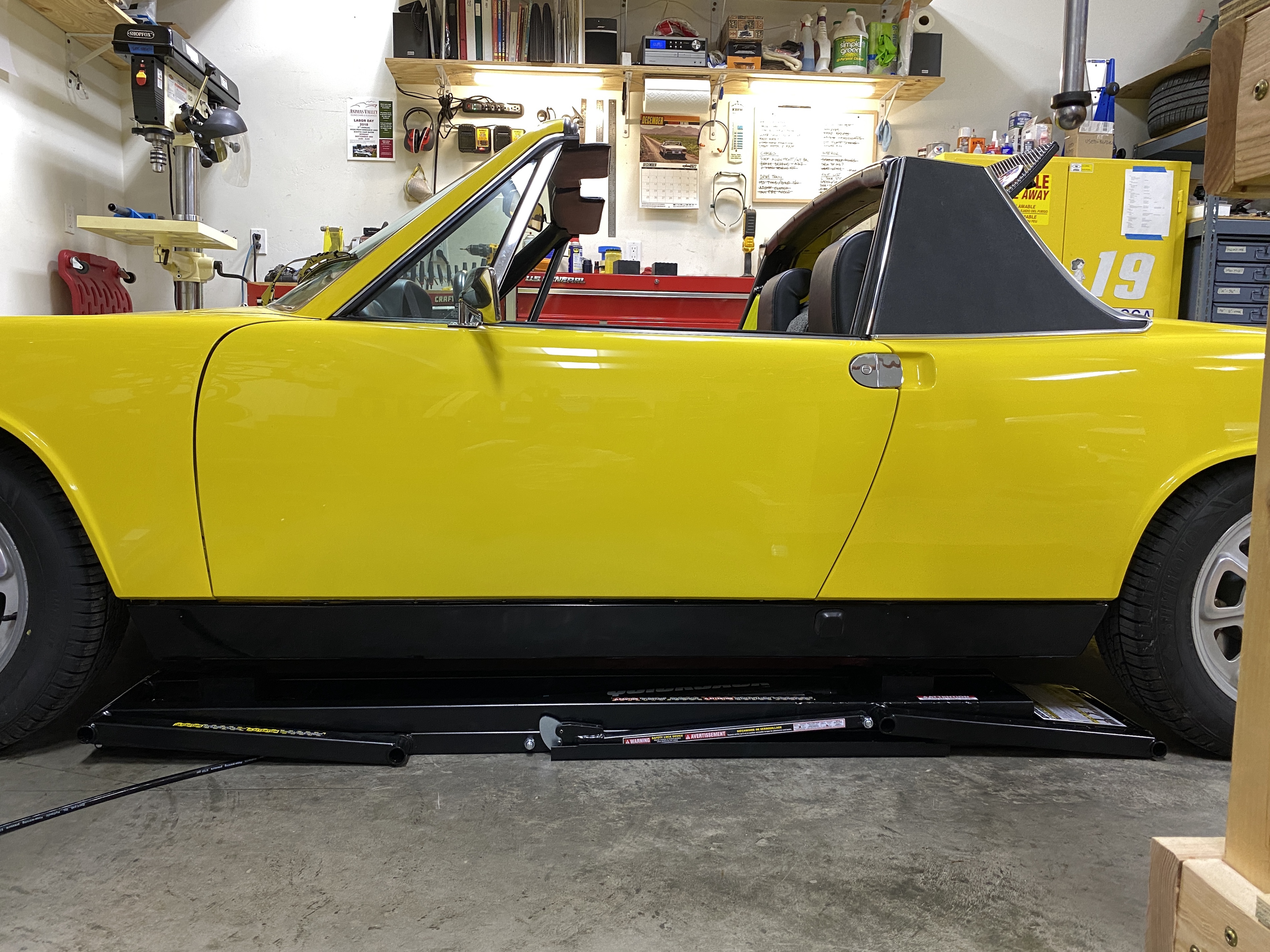

I recently got a Quickjack 7000 TLX. I need the long X model to reach the jack points on my other vehicles. But I have failed to lift the 914.
My first attempt had the Quickjacks in the "official" positions, i.e. with the lower base pivots forward. Note this is not what I consider safe for 911s and probably for 914s, since the car center of gravity can end up outside (behind) the end of the lower base.

bkrantz   But the rear jack point is far forward of the lift...   Dec 12 2022, 08:41 PM
bkrantz   The front jack point and pad look OK. But I could...   Dec 12 2022, 08:42 PM

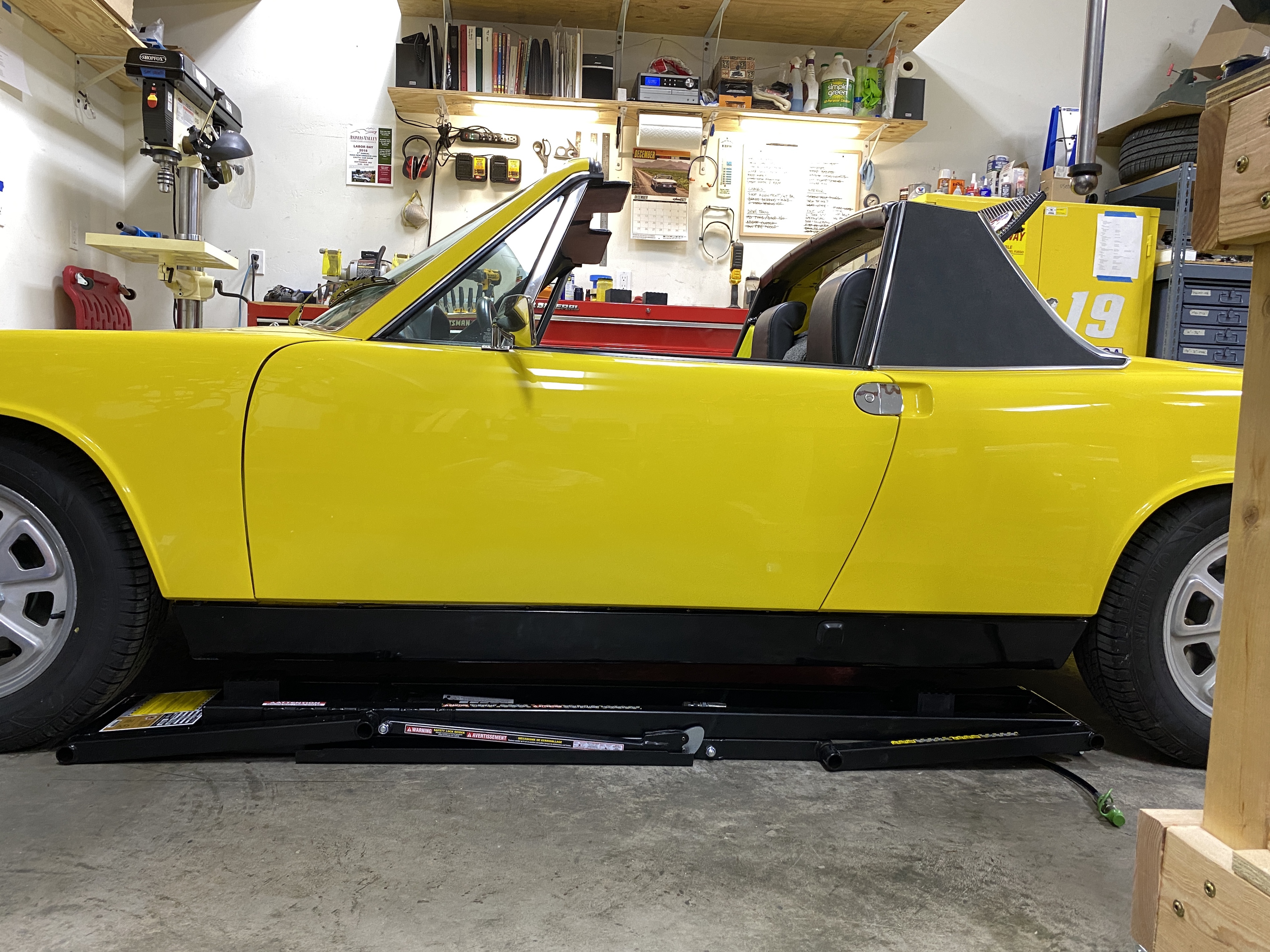

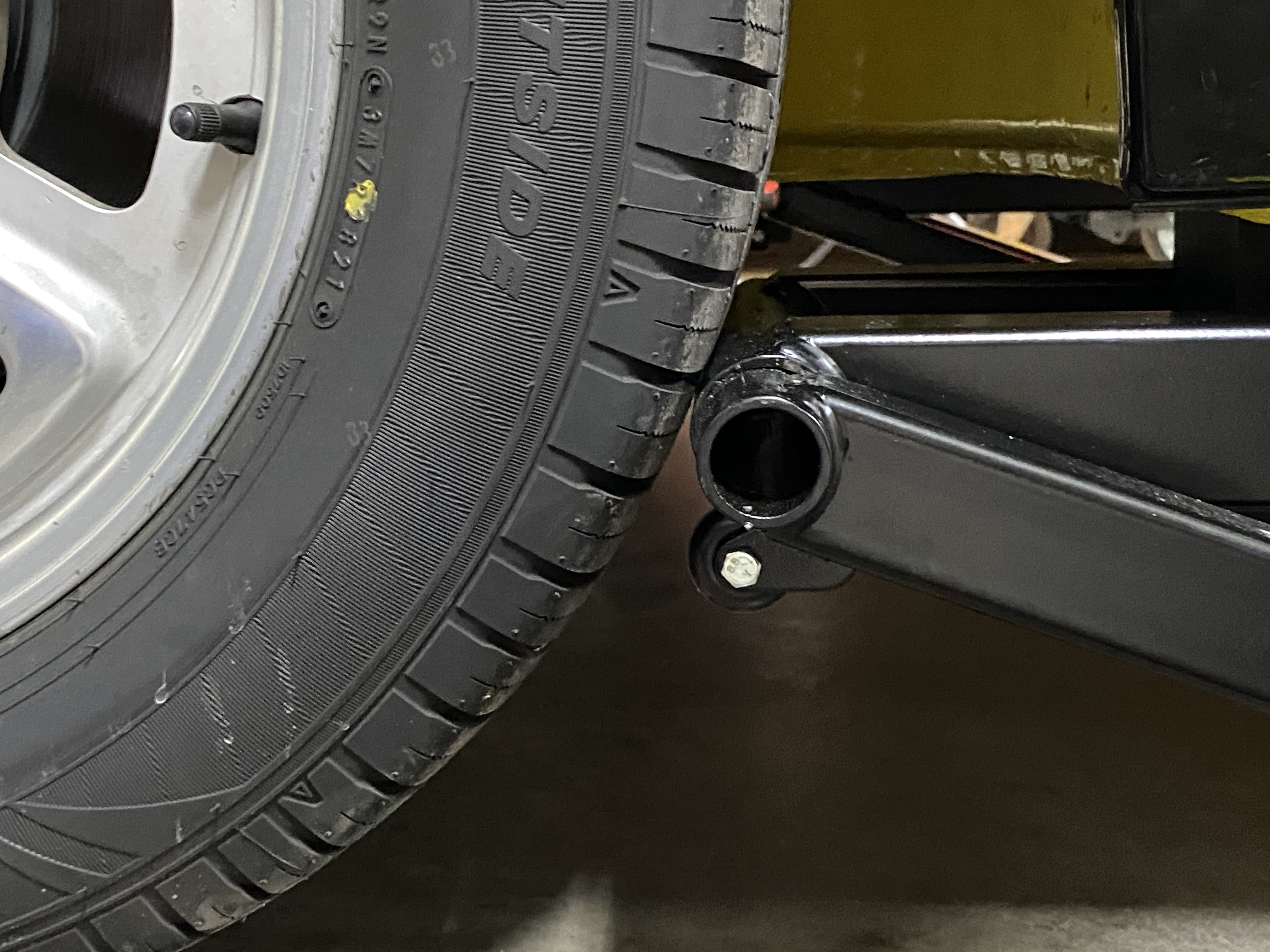

bkrantz   I then swapped the Quickjacks from side to side, s...   Dec 12 2022, 08:43 PM
bkrantz   Again, the front lift pad is OK.   Dec 12 2022, 08:44 PM

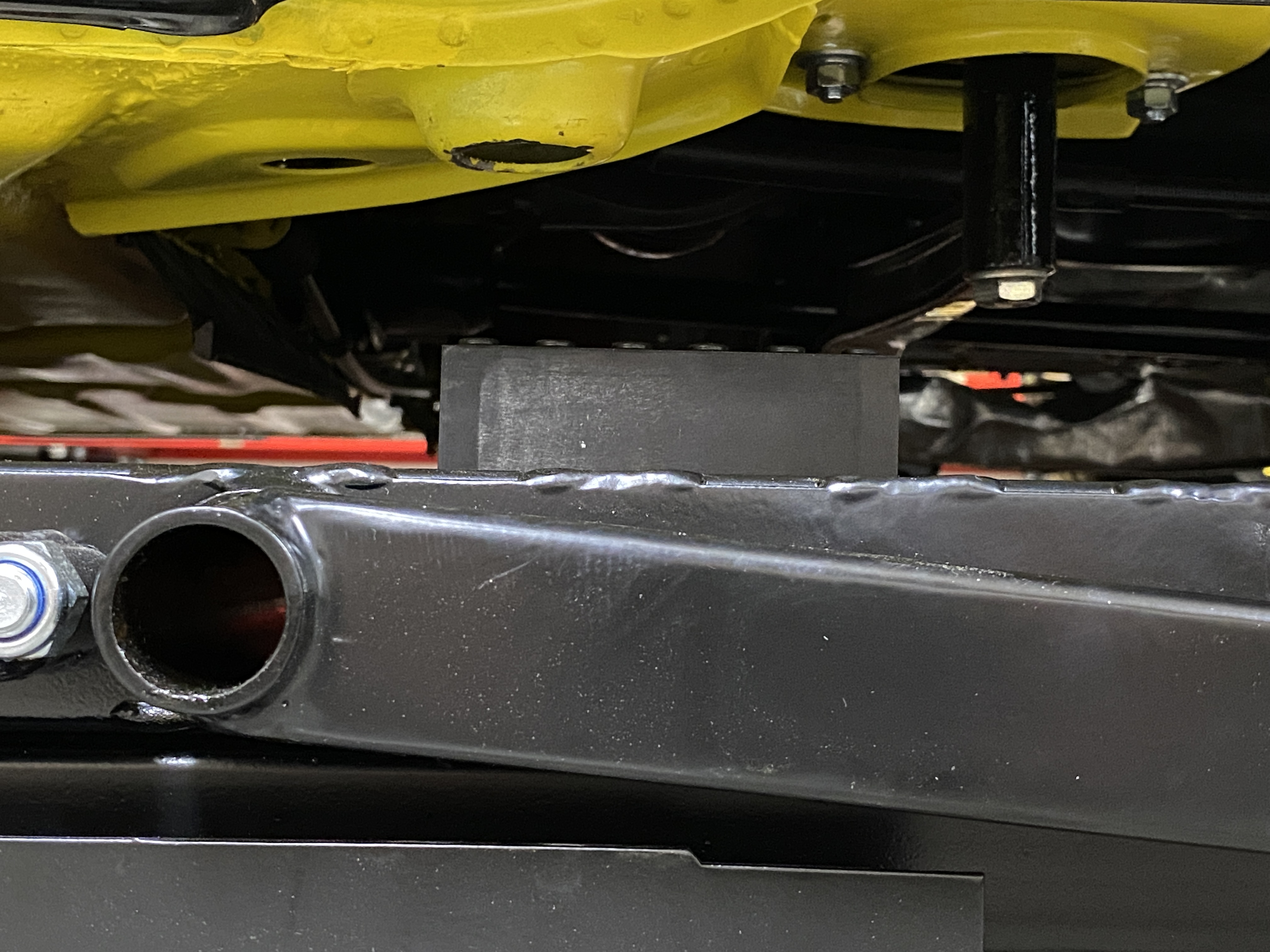

bkrantz   And the rear lift pad, as far forward as possible,...   Dec 12 2022, 08:45 PM

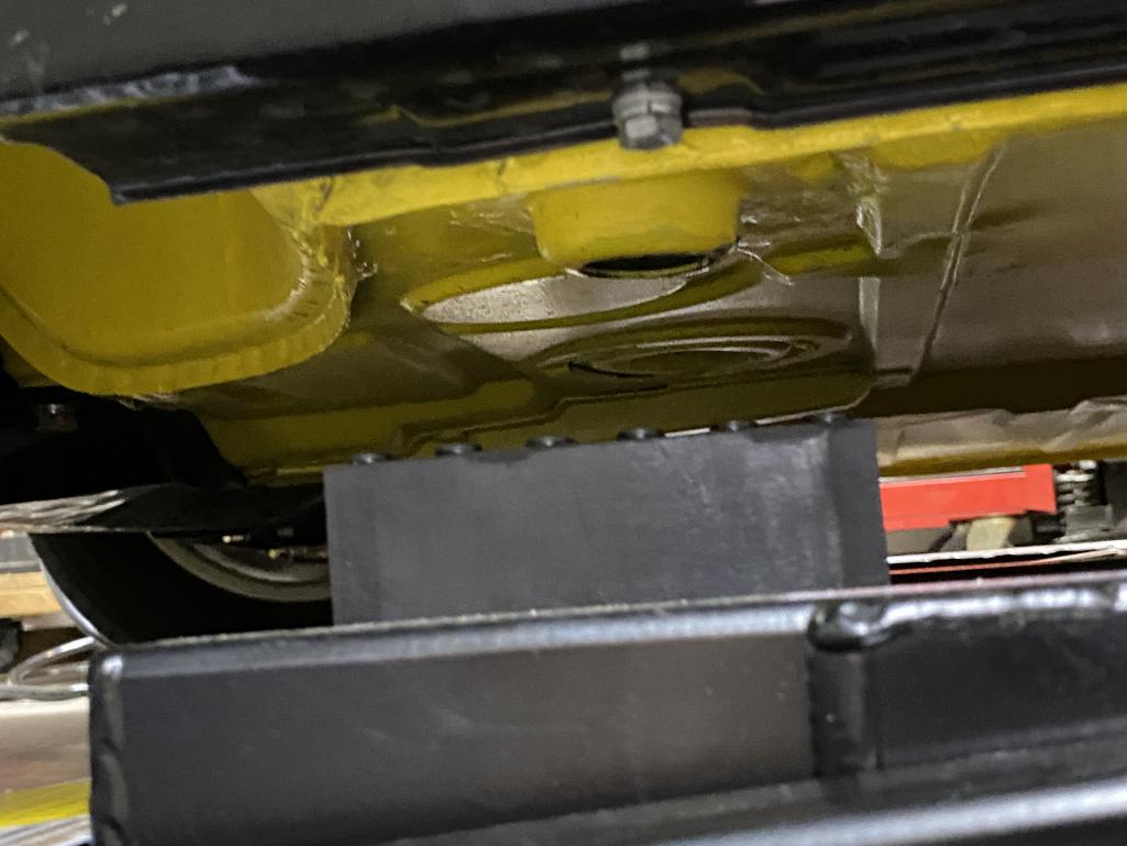

bkrantz   But as the car lifts, and the suspension drops, th...   Dec 12 2022, 08:49 PM
76-914   Bob, It has been pointed out to me that those aren...   Dec 12 2022, 09:29 PM
mepstein   Bob, It has been pointed out to me that those are...   Dec 12 2022, 09:38 PM
Robarabian   You should have the pinch weld rubber pads. You ca...   Dec 12 2022, 09:37 PM
Freezin 914   I have the QJ 5000, it is tight by the wheels, but...   Dec 12 2022, 10:05 PM
914sgofast2   I have the 5000 model too and it is finicky to get...   Dec 12 2022, 10:21 PM
bandjoey   Do not try to flip the lift sideways. As it lifts...   Dec 12 2022, 10:32 PM
SirAndy   You can use the engine crossbar ok. Only if it is...   Dec 12 2022, 10:53 PM
peteinjp   You can use the engine crossbar ok. Only if it i...   Dec 13 2022, 05:18 AM
mlindner   On both front and rear I use a larger board over t...   Dec 13 2022, 05:26 AM
Retroracer   Seconded (thirded?) for NOT putting any significan...   Dec 13 2022, 08:22 AM
