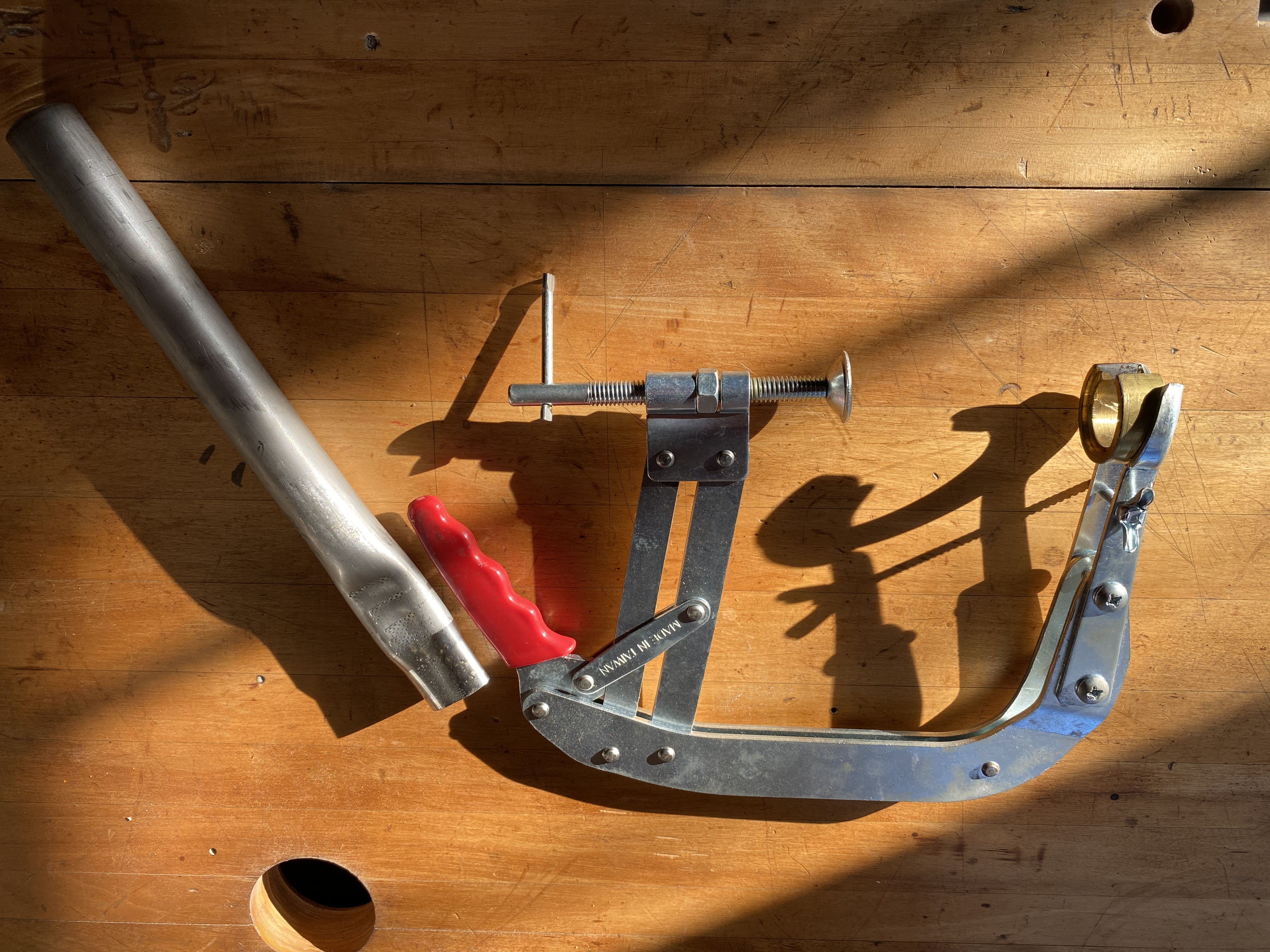

barefoot
post Dec 16 2022, 03:22 PM
Posts: 1,505
Joined: 19-March 13
From: Charleston SC
Member No.: 15,673
Got this on Amazon
I made a spacer to fit out retainer better & had to make an extension handle to get enough leverage even for stock single springs, but it worked fine.
