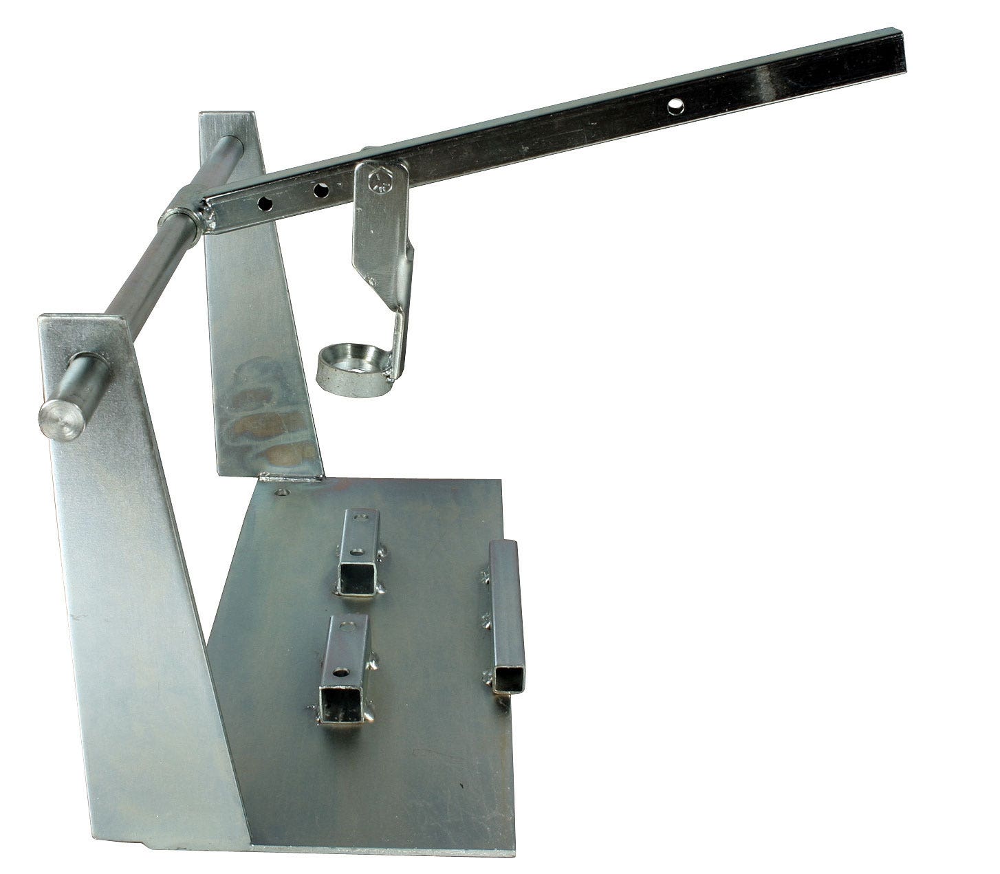

nathanxnathan
I've used style they say is for type 1 on type 4 heads plenty of times. It would be nice to have one that's similar to the factory style, as the bench top ones are bulky to store compared to the ones that bolt to the rocker studs.
IPB Image

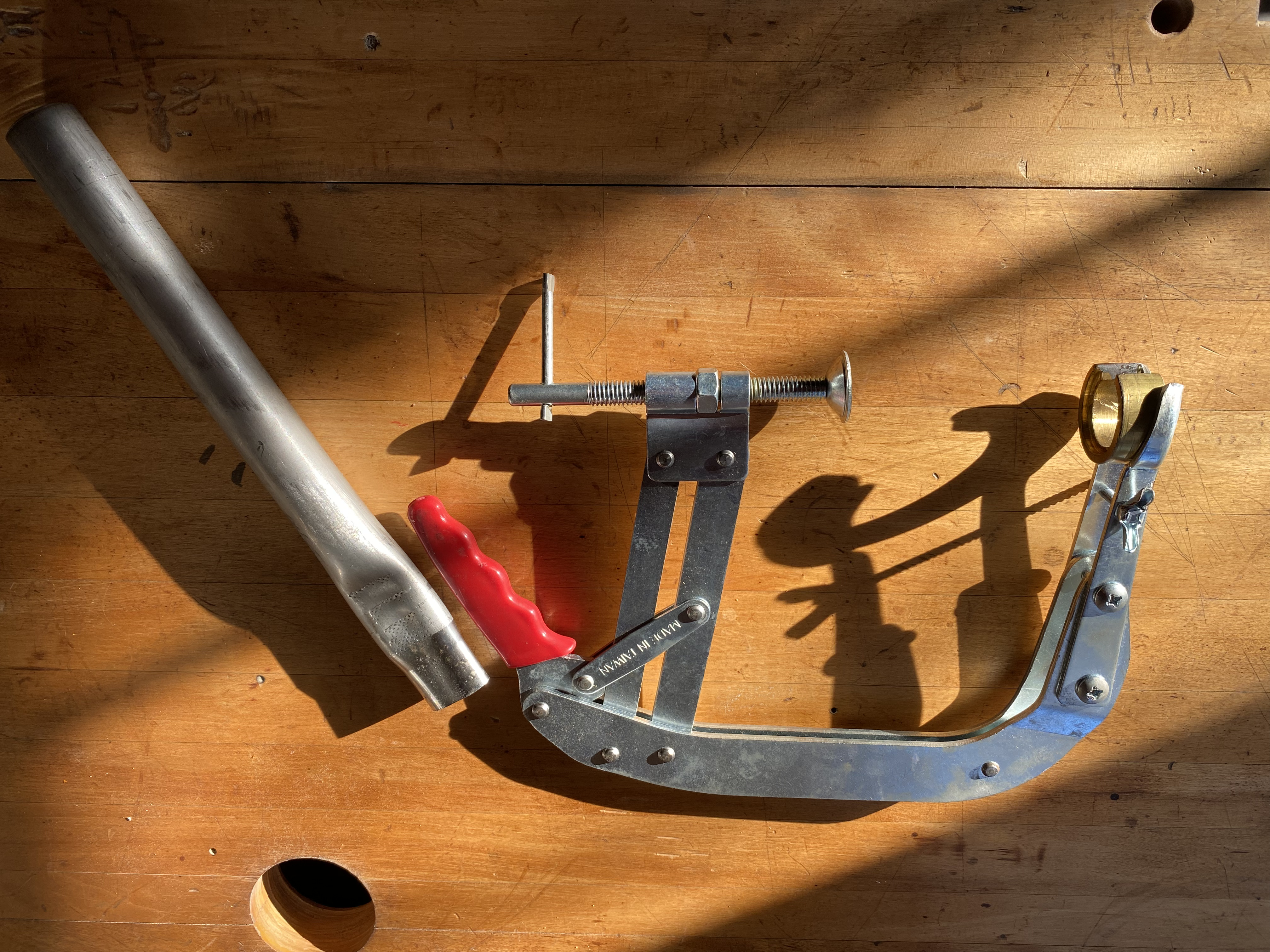

barefoot
Got this on Amazon
I made a spacer to fit out retainer better & had to make an extension handle to get enough leverage even for stock single springs, but it worked fine.
