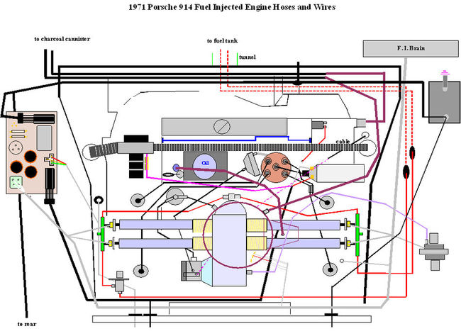

and am drawing a diagram of all the engine hoses and wires
i'll post it when completed
is there a basic drawing of just the electrical wiring of just the engine area?
thanks

(IMG:http://www.914world.com/bbs2/uploads_offsite/www.surfacezero.com-27003-1686094033.1.jpg)
this is just a test run
for a drawing i made
as i could not find any
similar drawing on the internet
feel free to critique it
i also have it on PDF
but don't know how
to upload the file
oh, i did figure it out
and, the PDF file is much
clearer than the photo
i still have some refinments
to make, so will update
this post when done
thanks
DrexAttached File  914_engine_area_diagram_2.pdf ( 34.35k ) Number of downloads: 152

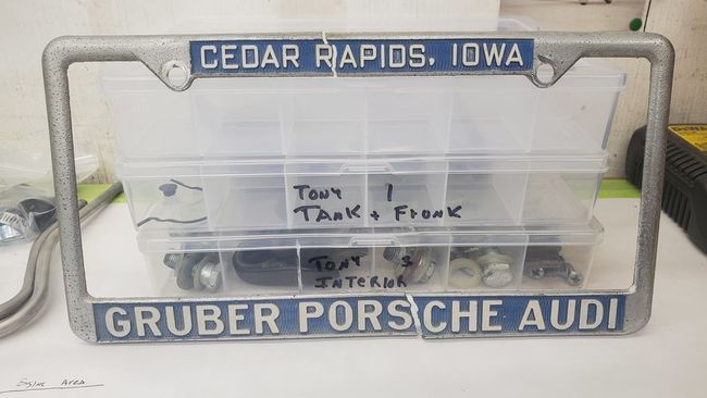

(IMG:http://www.914world.com/bbs2/uploads_offsite/www.surfacezero.com-27003-1686132713.1.jpg)
like this one!
unfortunately, it was broken when i bought the car
But...it is repairable
and i plan to have it restored and use it

QUOTE(Drex @ Jun 7 2023, 03:11 AM) *
like this one!
Drex
Yes Dave, that is the one! Guard it with your life!!!
(wish there was a way to make copies)

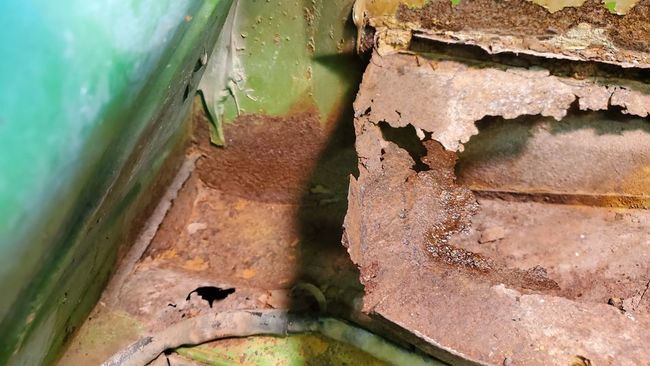

(IMG:http://www.914world.com/bbs2/uploads_offsite/www.surfacezero.com-27003-1686412001.1.jpg)
hell hole
some damage but not as bad as i thot it would be
Drex

QUOTE(Drex @ Jun 10 2023, 09:46 AM) *
hell hole
Drex
We have seen much worse, as in non existent metal in the "hole"
How are the long's?

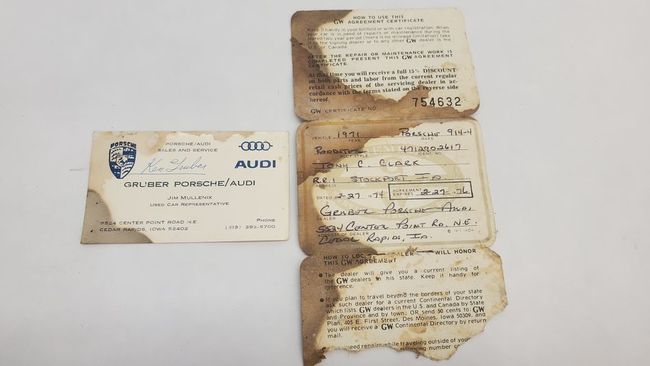

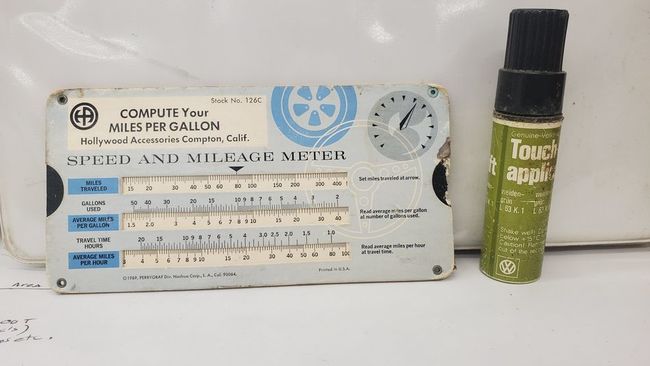

couple of items i discovered in the driver's pouch
D Rex

QUOTE(Drex @ Jun 11 2023, 11:40 AM) *
(IMG:http://www.914world.com/bbs2/uploads_offsite/www.surfacezero.com-27003-1686505561.1.jpg)
D Rex
Very cool and old school to boot. I brought a 1970 Dodge power wagon home several years ago, had one of these mileage calculators and some other goodies including every service record from day 1.
Not many of these time capsule examples around anymore.

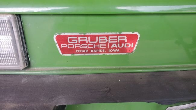

QUOTE(Drex @ Jun 11 2023, 06:30 PM) *
I’m torn on dealer stickers like this.
Sort of cool from a vintage standpoint.
Personally, I’m baffled that people let a dealer place their free advertising (including license plate frames) on a new car that they just paid for. I have yet to encounter a dealer that is my friend and looking out for my best interest (IMG:style_emoticons/default/shades.gif)
Used to be more commonly accepted but I still see plenty of it on modern cars. (IMG:style_emoticons/default/confused24.gif)

QUOTE(Superhawk996 @ Jun 11 2023, 05:56 PM) *
We let them continue this practice, "free advertising" for them.

QUOTE(Superhawk996 @ Jun 11 2023, 06:56 PM) *
That is exactly my feelings on the license plate frames advertising the dealer. Remember in the old days some dealers had metal name tags riveted or screwed on to the trunk lids?

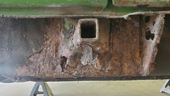

(IMG:http://www.914world.com/bbs2/uploads_offsite/www.surfacezero.com-27003-1686599992.1.jpg)
Superhawk996
You've convinced me with your excellent braking dissertation!!
I kinda like the dealer stickers
They remind me where my old friend/accountant bought this car
and that my son and I play golf at the National Airport Golf course near Cedar Rapids
Of course, if I have the car repainted, they'll be gone
Just curious though, are points subtracted off in judging contests with these stickers?
Not that I would ever be foolish enough to enter one of these.
Picture is of the right rocker panel
Most, except for the Jack Plate Support, is pretty solid
The left Jack Plate Support is in better condition
I did insert a rod and gently lifted...then used a jack
They both were very solid
I'll probably weld in new replacements anyway
Should I order new ones, or fabricate my own as they will be hidden?
The very bottom of the Hell hole is pretty solid as well
so will probably replace the metal with holes
and install a new battery mount
Thanks for all your 914 advice
