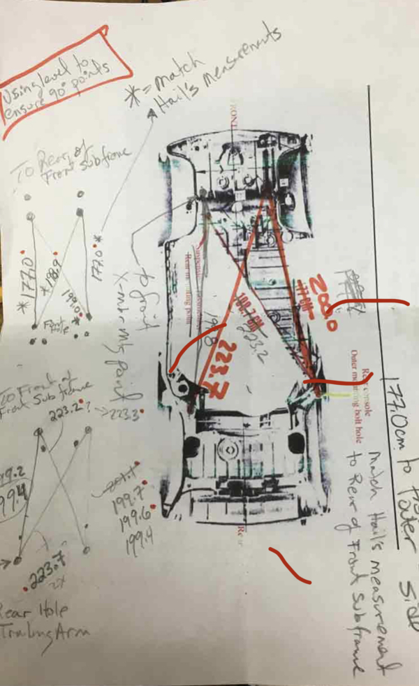

If there is rust in the hell hole or longs that would be a deal breaker unless it were virtually free.
You can find underbody reference dimensions in a couple places:
http://www.914world.com/specs/underdims.php
Or look at Jeff Hails thread - lots of info buried in there somewhere around pages 9-11
http://www.914world.com/bbs2/index.php?showtopic=76791
You want to find the graphic like this one. I used Jeff’s measurements as reference and they matched my chassis within a couple mm here and there (disregard my chicken scratch) you just want his clean graphic as reference since OEM measurements reference an imaginary center line that isn’t easily measured to.

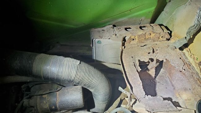

here is a picture of the rear trunk area
again, it probably doesn't tell one much
it is -7 F here in central Iowa with winds up to 45 mph
so not good weather to be inspecting an old car
thanks again

So since you know the family, has it been in their ownership the entire life of the car? If so, can you then verify the original mileage and the story of it having been in dry storage for 40 years? This would make a difference to me. Given the answers to those questions, it is likely to be a very low mileage car with minimal rust.
I would ask to remove the rockers(you might need to drill out the pop rivets on the top...you might also need some PB Blaster and an impact driver on the bottom screws). As previously mentioned you need to check out the hell hole, floor pans, and areas behind seats. In a perfect world, they would allow you to remove the seats and back pad to check out those areas.
Does it still have factory FI? That along with the fact that it looks like Willow Green would also go a long way with me. Also, does it run? Does it turn over? Does it spin freely? I personally think you might have a diamond in the rough here....especially knowing up front that it's gonna take some time & money to get it back to the way you want it. Bonus: you helped bring an old friend's car back to its former glory.
