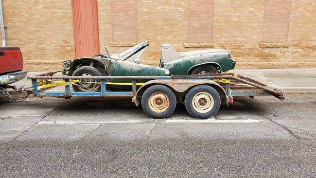

Finally got my F350 fixed
Required two valve cover gaskets being replaced
Houston....we have a problem!!!!!
with the parts car that is
Had a heck of a time getting it off the trailer
being's the bottom had dropped out
....but with jacks and two by fours and my
trusty winch...we got it off and into my garage
Drex
(IMG:http://www.914world.com/bbs2/uploads_offsite/www.surfacezero.com-27003-1678323627.1.jpg)

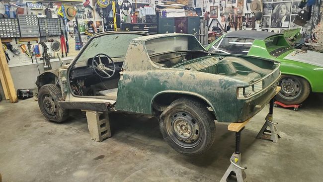

have car all jacked up to remove engine
followed the 914OWorld technical article
to prepare this to be done.
car kinda looks like the sinking titanic!
i did order the tangerine plate tool
i think i could have done it with the floor jack
and built up blocks on both sides of the engine
while i wait for the tool to arrive
i'll continue to remove parts in the front trunk area
Drex
(IMG:http://www.914world.com/bbs2/uploads_offsite/www.surfacezero.com-27003-1678486949.1.jpg)

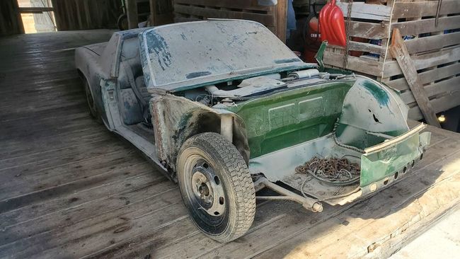

QUOTE(Drex @ Feb 28 2023, 06:44 PM) *
Leave tomorrow morning
to pickup the parts car
Plan to completely tear it apart for parts
and sell the ones I don't need
Here is a picture of it
Other than the engine
what are the major things
worth saving?
Again, appreciate all your expertise
Drex
(IMG:http://www.914world.com/bbs2/uploads_offsite/www.surfacezero.com-27003-1677627843.1.jpg)

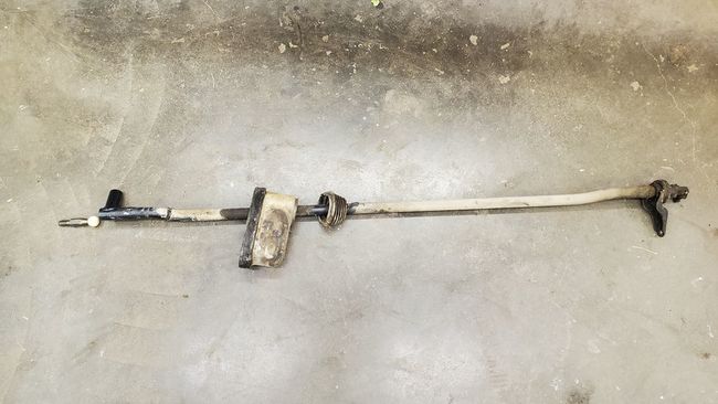

i found this picture at:
https://zyyz.com/motorsport/project_914_02_24.htm
thank you for whoever posted it
the credit is your's, not mine
i think it illustrates the shift linkage that is in my parts car
that i'm taking apart
i'm just not sure how to go about it
it needs to be removed before I drop the engine
where does the other end of the short piece go that's at the very bottom go?
anxiously awaiting my tangerine plate tool
thanks for any input
Drex

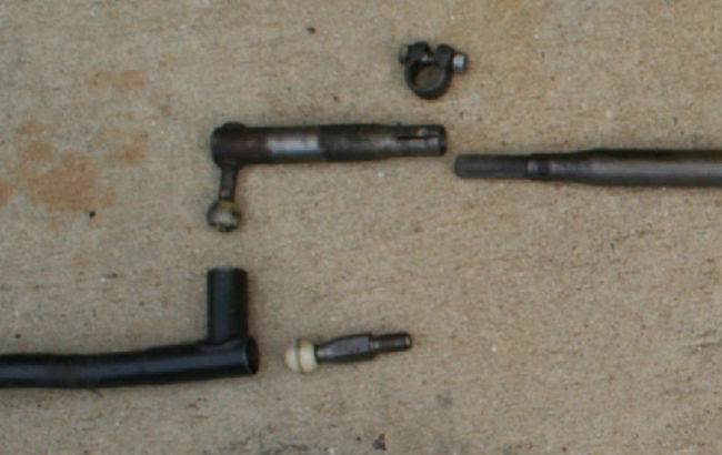

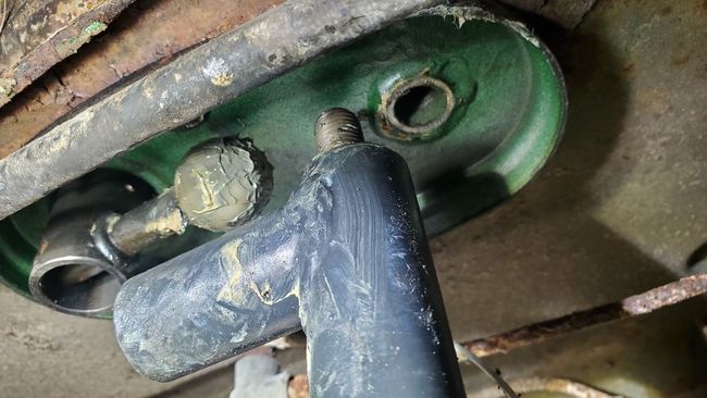

Figured out shift linkage removal
Was pretty simple
Haven't tackled the gear shift lever linkage yet
(IMG:http://www.914world.com/bbs2/uploads_offsite/www.surfacezero.com-27003-1678631039.1.jpg)
(IMG:http://www.914world.com/bbs2/uploads_offsite/www.surfacezero.com-27003-1678631039.2.jpg)

The gear shift linkage can stay in the car until the engine is out. It’s a lot easier to remove once the engine is out. And, if it’s in good working order, no need to risk dislodging the clutch tube by pulling it out.

Tell you what, let me take a look at mine when I get home so I don't tell you wrong.
krazykonrad
post Mar 14 2023, 05:00 PM
Post #98
Posts: 1,182
Joined: 21-February 06
From: Canton, GA
Member No.: 5,610
QUOTE(krazykonrad @ Mar 14 2023, 06:50 AM) *

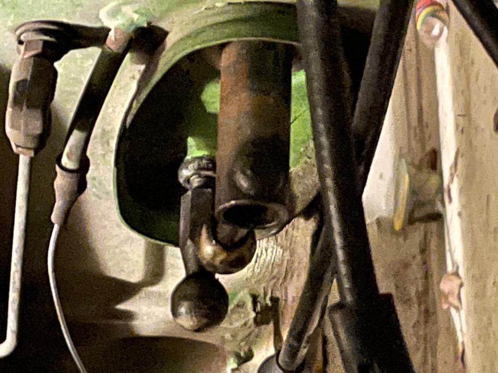

Yes, my shift rod is still in the car. Attached Image
krazykonrad
post Mar 14 2023, 05:01 PM
Post #99
Posts: 1,182
From: Canton, GA
Member No.: 5,610
Sorry. Sideways
