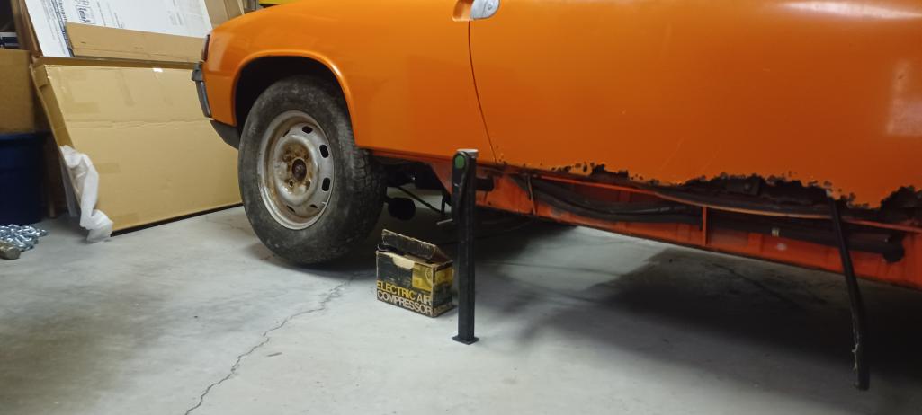

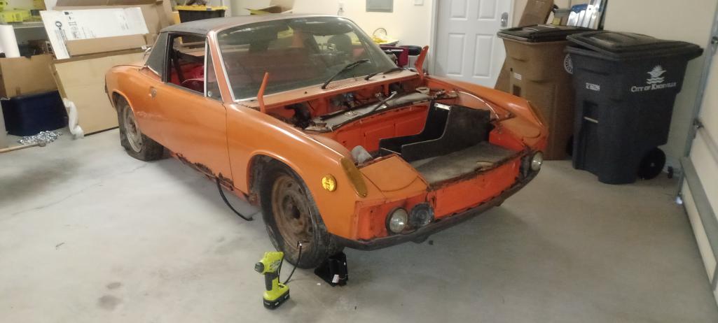

914rrr   ...passed the all important jack test!!   Jan 4 2023, 12:52 PM
930cabman   Is that a longish hole in the lower portion of the...   Jan 4 2023, 03:12 PM

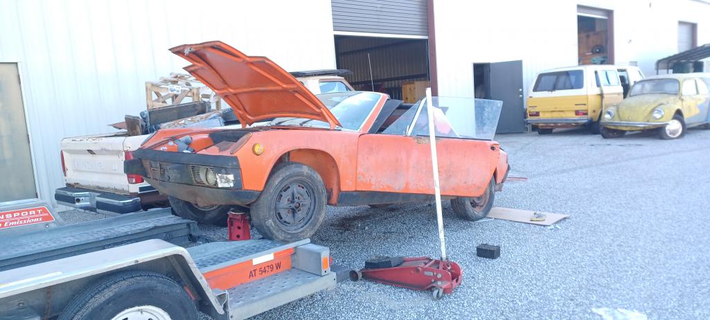

914rrr   In answer to my last post re: loading a non-op 914...   Jan 22 2023, 05:08 PM
930cabman   In answer to my last post re: loading a non-op 91...   Jan 22 2023, 05:15 PM
914rrr   In answer to my last post re: loading a non-op 9...   Jan 22 2023, 05:58 PM

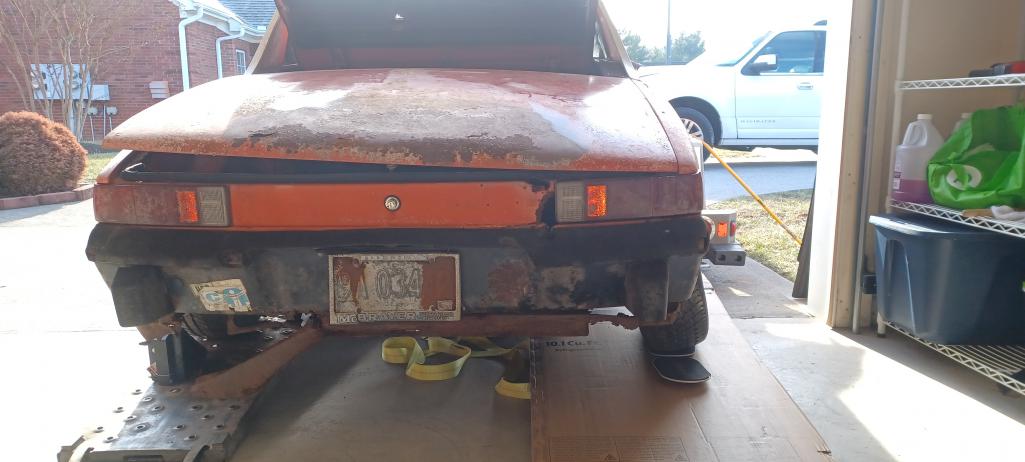

914rrr   Unloading was a whole different story... I rented ...   Jan 22 2023, 05:49 PM
Superhawk996   You do know the trailer has ramps . . . Right? :c...   Jan 22 2023, 06:47 PM
914rrr   You do know the trailer has ramps . . . Right? :...   Jan 23 2023, 05:08 AM
930cabman   I have used U Haul several times in the past with ...   Jan 23 2023, 05:52 AM
