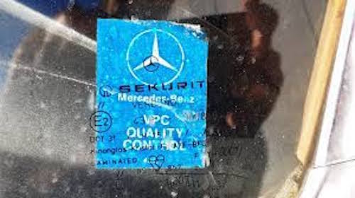

Looking for help if anyone makes these OEM Windshield Sticker's?
Are they different for every model year?
Many years ago while restoring my 914 I used a solvent to clean up the windshield glass & destroyed the letters. I would like one for my OEM original windshield (IMG:style_emoticons/default/pray.gif)
This is off as recent 1976 in a local shop for repairs in this photo.

Pretty sure That is a stamp, not a sticker

^^^agree. Not a sticker.

I thought OEM was sigla.and it is etched in the glass not a sticker.

Steve,
It's not factory stamped, it's a thin clear see through logo sticker with white letters about 4"x4".
I pealed mine off using a razor blade to peal it off (Glued to the glass).

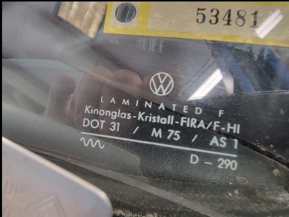

interesting.
original screen in mine. never been replaced.
does not have the audi rings like @TJB/914
just VW insignia. no mention of sigla either.
its a jan 74 build.
all the other letters codes are same as TJB/914
side glass is the same
just VW insignia
same with rear glass. different codes. but only VW insig.
i have a spare screen in its box still that i picked up in 90 from porsche in USA.
shipped it back with the car. would be genuine but manufactured at later date?
never taken a close look at markings apart from confirming it was completely clear.
(as was required by law in aus back then).
i'd have to pull it out and unbox it to see what was on that.
ps - sekurit is a brand name for automotive glass divsion of saint-gobain.
pretty much the best glass makers in the world.
though other glass companies would probably argue.
its interesting that the windscreen does not have sekurit branding.
a lot of the original parts in 914s did not have the manufacturer branding, but were stamped VW even if made by an external supplier. exhaust mufflers originally for instance just were given a VW stamp. often the replacement parts carry the manufacturer branding. its a fuzzy area.

It's like a tempering bug. It's a frit stamp that's baked on the glass. Not a sticker.

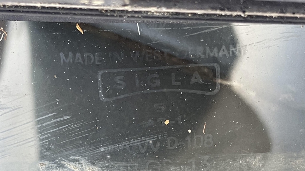

The ziggy-zaggy line is the Sigla logo.

just to throw things.
what about this then?
from the L jet files.
a may/74 1.8 with the sigla logo. looks like its top of the screen.
was from a very original but very down car.
has oscilloscope wiggle logo just like kinoglas.
wiggle something else?

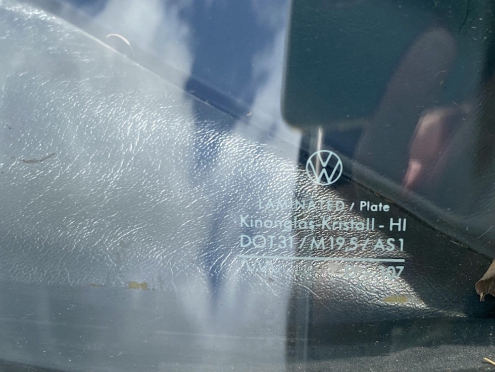

a may/74 1.8 in very good/excellent original condition. low miles it was claimed.
identical to my jan/74. numbers code etc. (except its D-290, not D-226)
3 possibilities.
one or the other are replacement screens. sigla maybe?
or/
sigla handled tinted screens?
or multiple original suppliers.
here is a 73 1.7 for a bonus.
in good original condition.
similar to 74 but has some different numbers going down.
