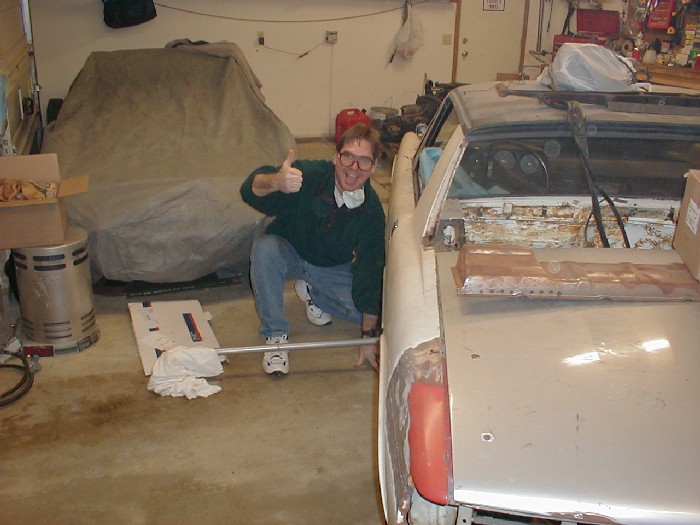

Just one note for the rest of this, I am not CptTripps... these pic's are over a years time span. The reason I am finally posting all this is to motivate me to get 'er done.

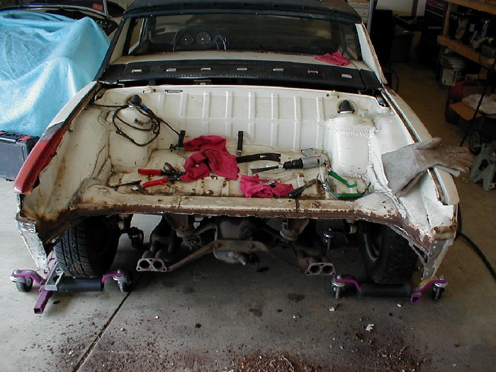

First task at hand was to cut the trunk and valance panel out. Lid was scrap. Got a few used pieces for replacement.

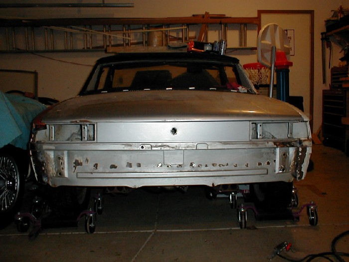

All buttoned up... still needs finishing and rear trunk pan.

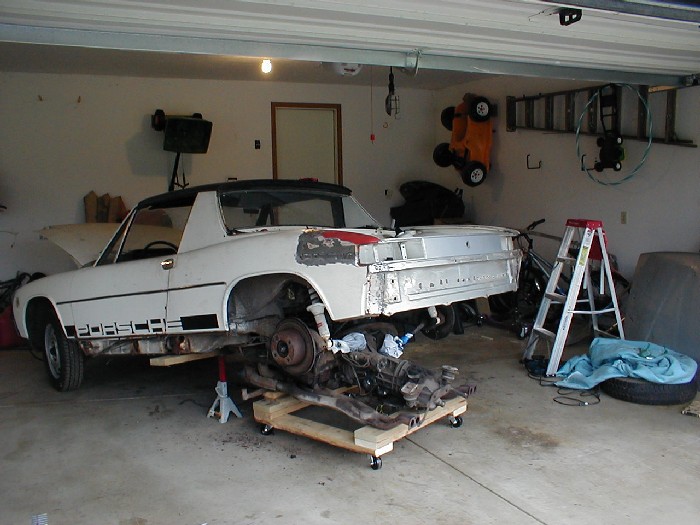

Next Task...

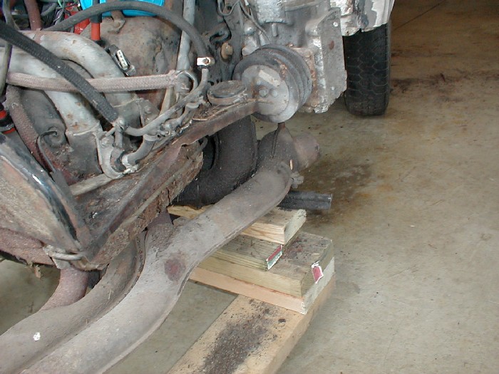

Drop the engine. Easy job took my brother and I about three hours.
tdgray
post Aug 10 2005, 09:55 AM
Posts: 9,706
Joined: 5-August 03
From: Akron, OH
Member No.: 984
Damn that engine looks big when it is not in the car

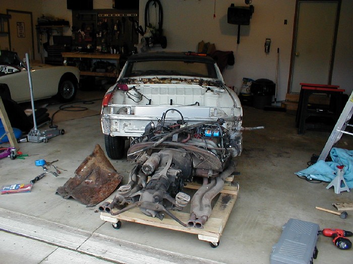

Hell Hole after engine removal (IMG:http://www.914world.com/bbs2/html/emoticons/ohmy.gif)

My buddy Dave (acting like a dork). Leveling the car before welding the clams on.

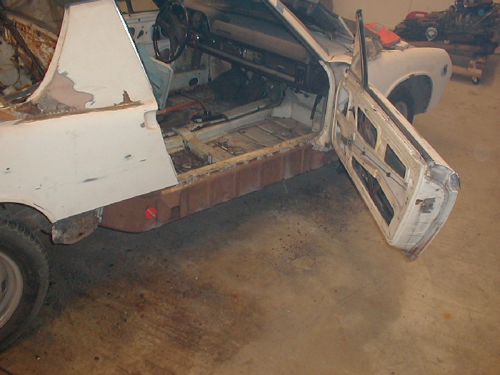

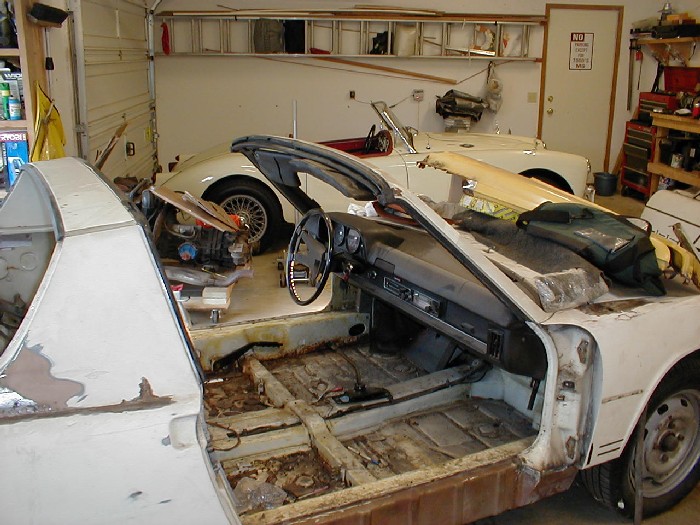

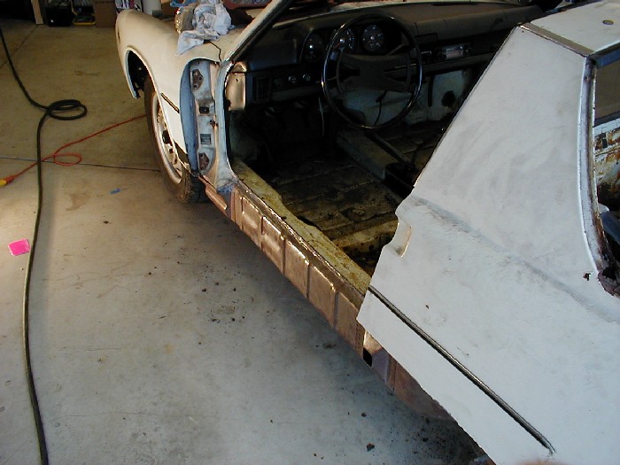

Stripped Down. Doors and targa off now that I trust the frame rigidity. Ready for sills and door jambs.

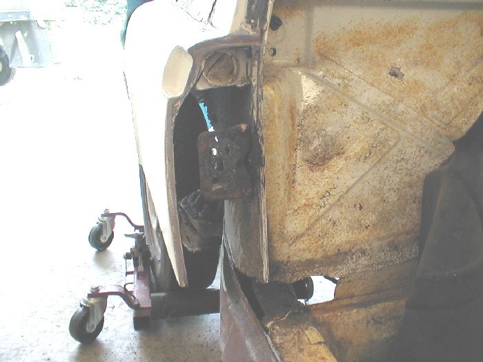

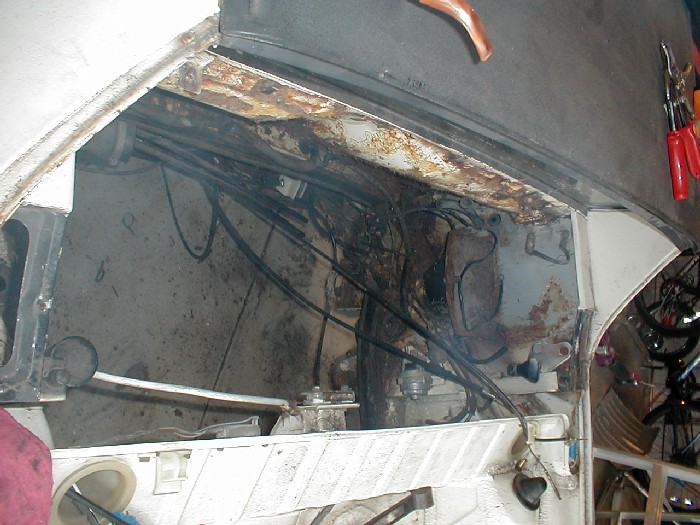

Door jamb carnage. Also firewall damage along with inner fender damage.

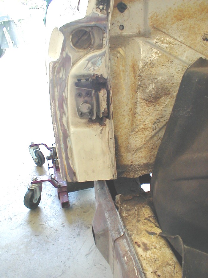

Cut the door jamb out. Normally you would pull the fender. I decided not to mess with aligning the fender etc. My plan was to grind out the old and smooth in the new.

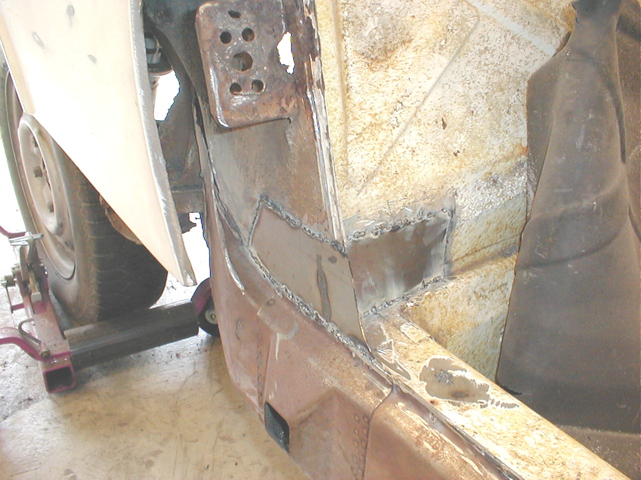

Firewall and inner fender repairs... no making fun of my welds please (IMG:http://www.914world.com/bbs2/html/emoticons/dry.gif)

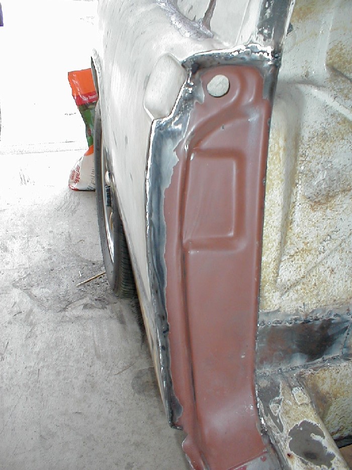

New door jambs. I test fit these suckers about a million times. Normally they fit in behind the fender. I fit the flush with the fender. No problems with door clearance.

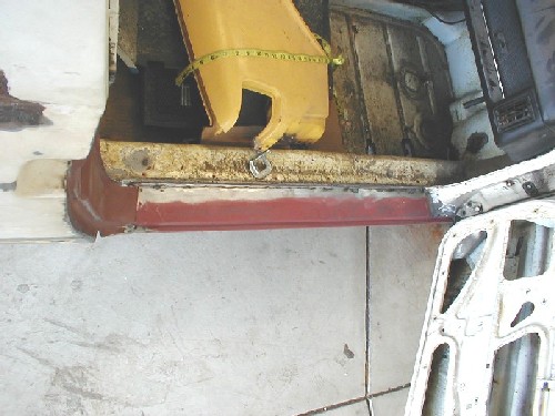

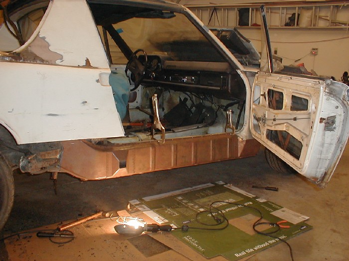

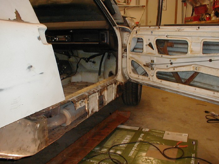

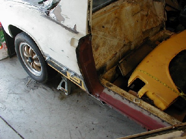

Next new door sills. Pretty easy installation.
