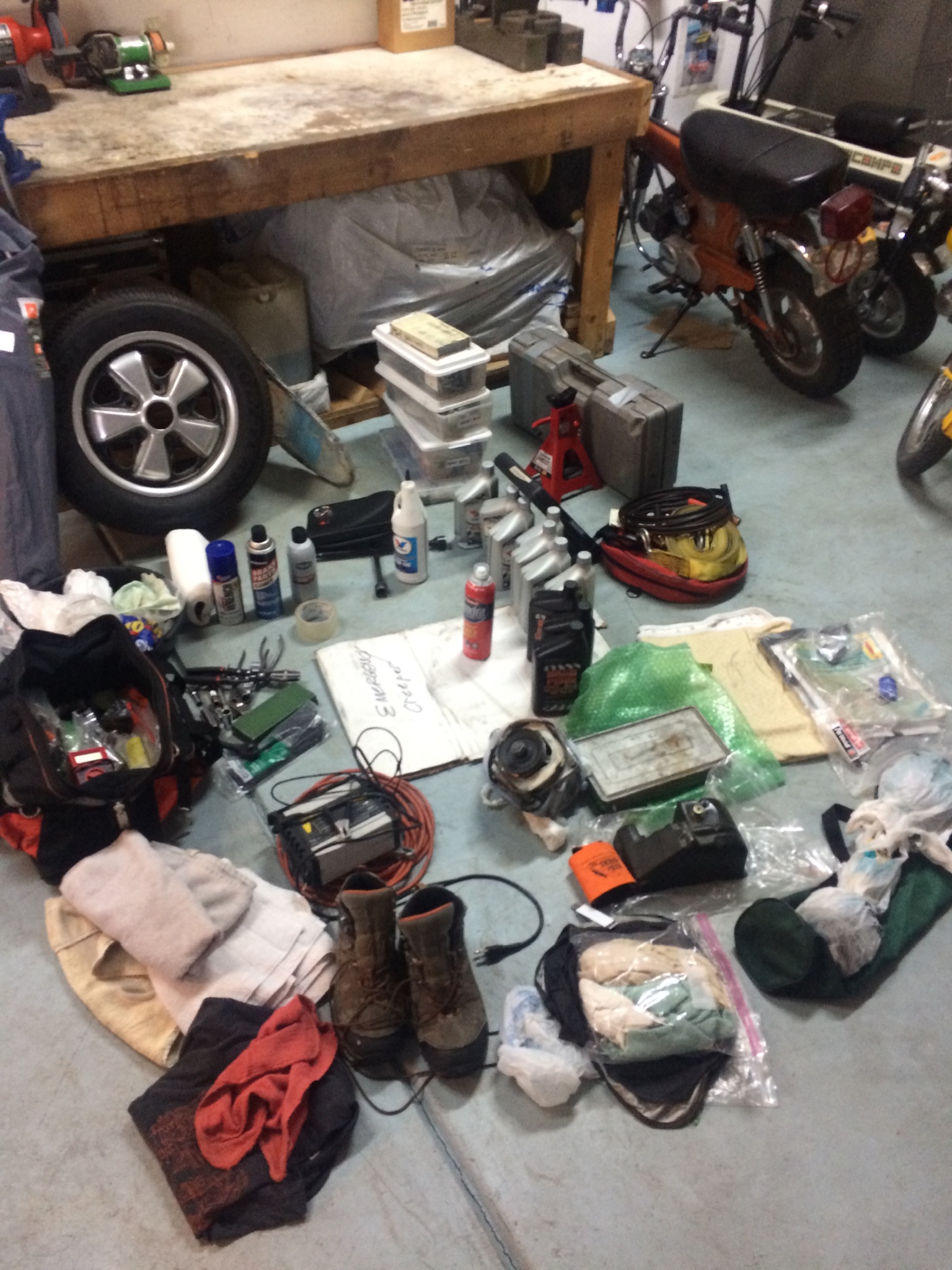

My road trips are 1-2x a year
Thousand miles each
An alt. Distributor. Starter. Spare fuel injection
Including ECU injectors. Fuel pump. MPs. Cht. points for fi
Regulator board and regulator
Plus drive axle wheel with 2 cv’s
Rear wheel bearing
Front bearings
Ignition switch
Alt harness
Lots of Tools. Hardware. Timing lamp
Cables
Jack and stand
Full size spare
Battery charger
Extension cord
Etc
Etc
Everything
