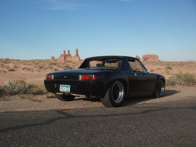

rick 918-S
post Jan 20 2023, 05:05 AM
Hey nice rack! -Celette
Posts: 21,257
From: Now in Superior WI
Member No.: 43
255/50/16
