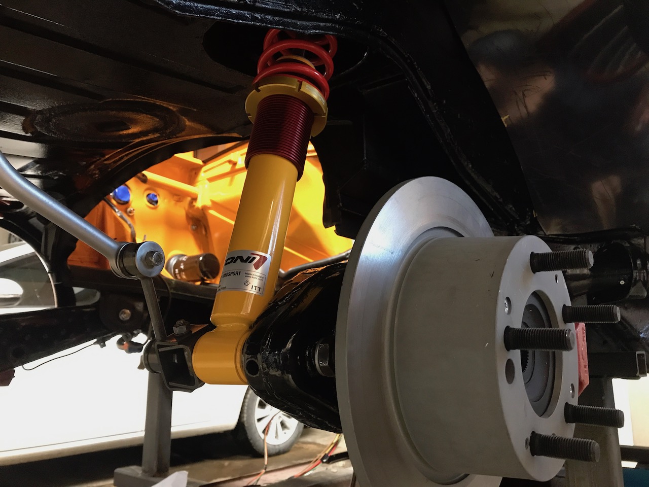

Tom, I went with 180lb for my 2.2S. Street and track use. Feel I would reduce it a little. Best, MarkAttached Image

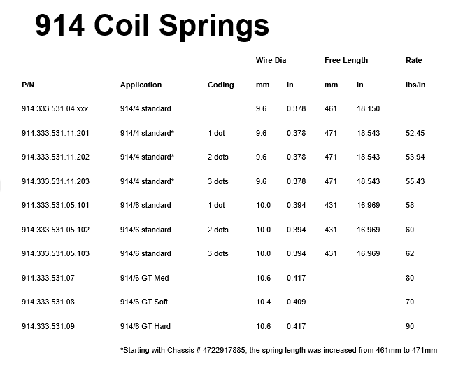

Here’s what the factory thought:
I don’t know the actual source of this data, though.
