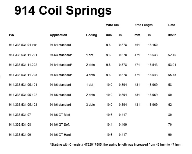

zoomCat
Feb 20 2023, 09:06 AM
Here’s what the factory thought:
Click to view attachment I don’t know the actual source of this data, though.
