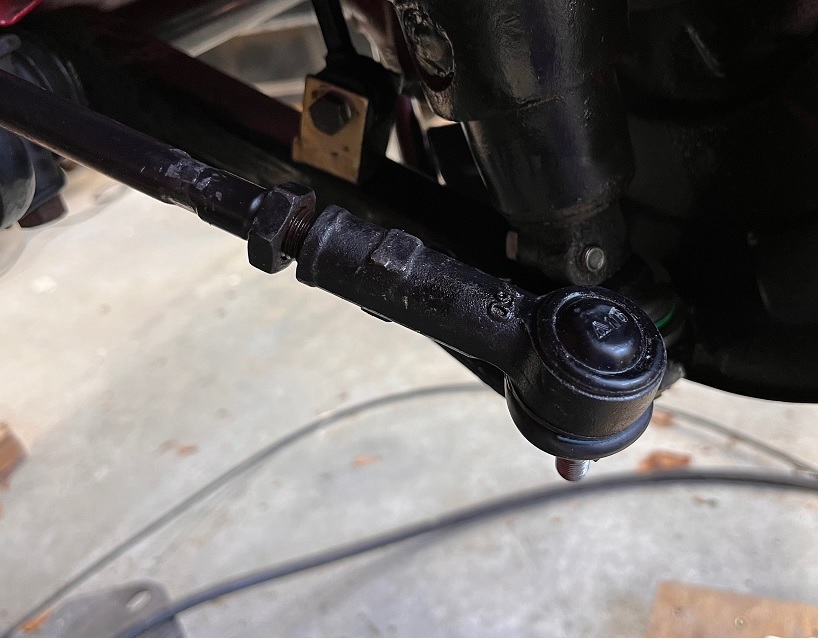

I don't know, but I'm missing it, too, apparently. Yes, that's what I've been trying to do (I still think it's right hand threaded, but either direction it's not budging). The rod itself has a small flat surface that will fit a 12mm wrench although not that well. The tie rod end will take a 22mm wrench. Here's a pic:
There was some surface rust on the threads from the 5 or so years I've been running these, but I still can't believe that's what's causing it not to budge.
I said screw it and ordered a whole new tie rod / tie rod end assembly from the bird.

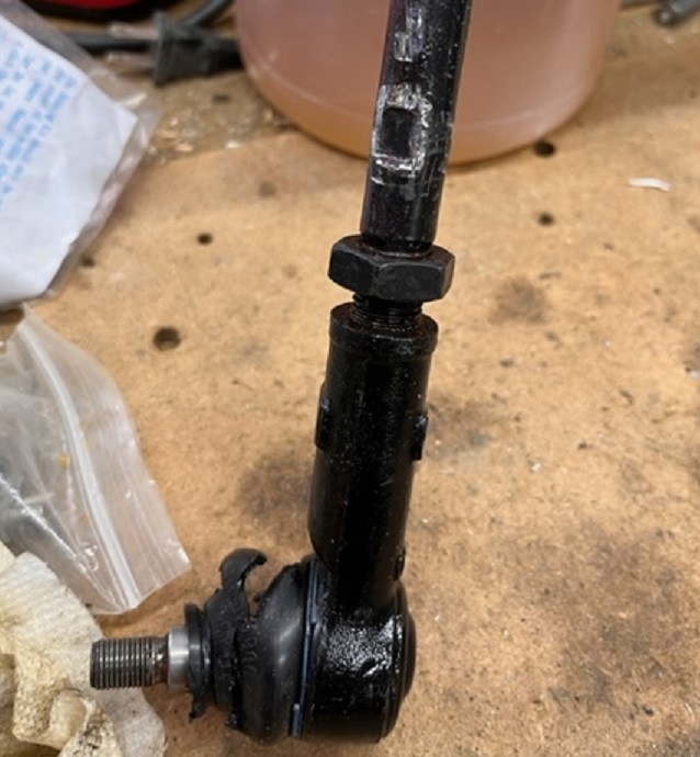

Here's the tie rod off the rack. The ONLY thing I can think of is if I put something like red loctite in there during assembly. But I don't think I did that, nor do I think I am that dumb. And I heated that b**** up pretty good trying to break it free.

More heat & more leverage.

Vice & Pipe wrench (IMG:style_emoticons/default/confused24.gif)

Had the MAP torch out, but getting leverage is tough on that rod, even in a vise. Lots of heat, vise, biggest pipe wrench I have -- nada. Couldn't find anything to work as a cheater bar.
(IMG:style_emoticons/default/WTF.gif) though. It's not like it's a 40 year old rusty part. Been maybe 5 years, and maybe only one East Coast winter. The rest of the time it's been garaged in the winter.
Thanks for the support, fellas, but I'm throwing in the towel on this one before I pull a groin. New tie rod shows up on Friday, I guess.

That is so weird, those threads should be moving freely since it's supposed to be the locking nut holding things in place.

(IMG:style_emoticons/default/WTF.gif) Wow. That is a head scratcher. Once that lock nut is loose, you can usually screw the tie rod end off by hand. Red loctite came to my mind too but I'm not even that dumb and I guarantee I'm dumber than you. I can't imagine it would be possible to cross thread those either.

Red loctite should free up with heat. I use heat on the cylinder registers to free up head studs and a minute or two of head easily softens the loctite.
