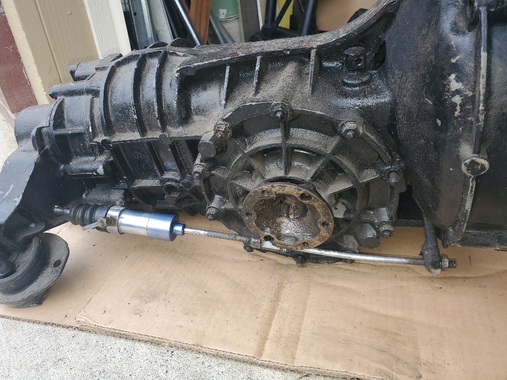

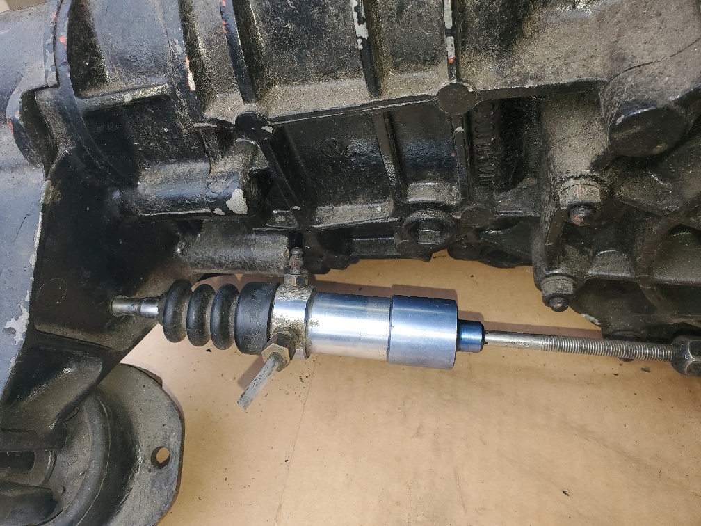

I recently picked up a gearbox that had this Hydraulic slave cylinder attached. I have no idea if it works. Make me an offer if you are interested.
Thanks,
Dominic
