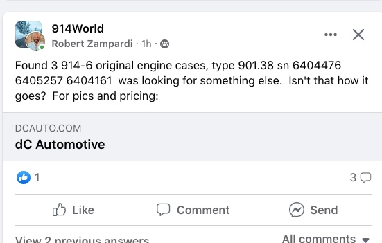

Rob at DC just posted this, in case anyone is feeling lucky!

So close (IMG:style_emoticons/default/blink.gif)
Looking for 6404159 ...

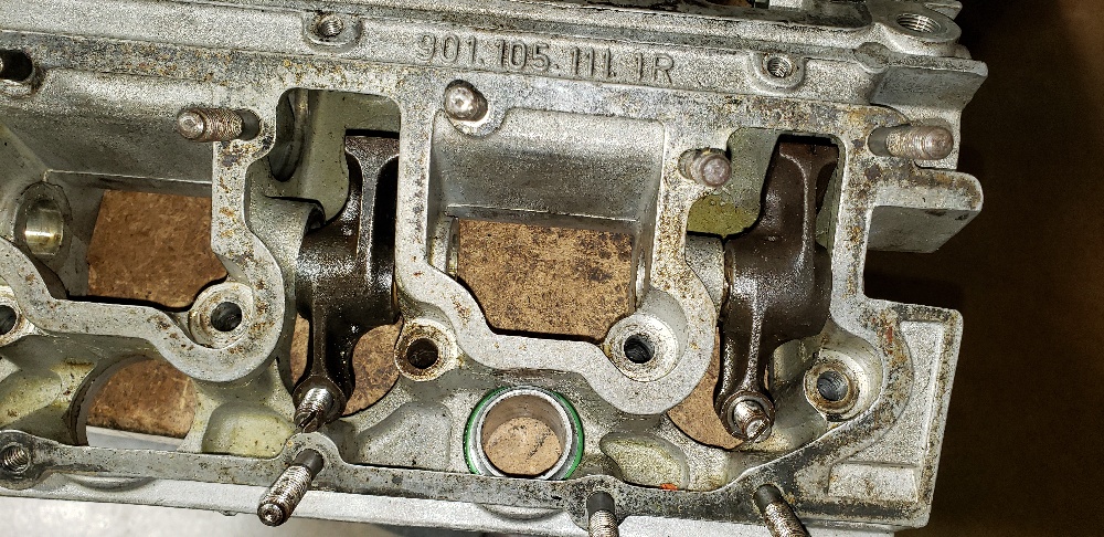

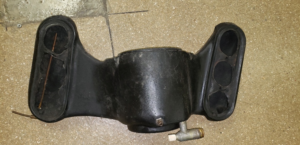

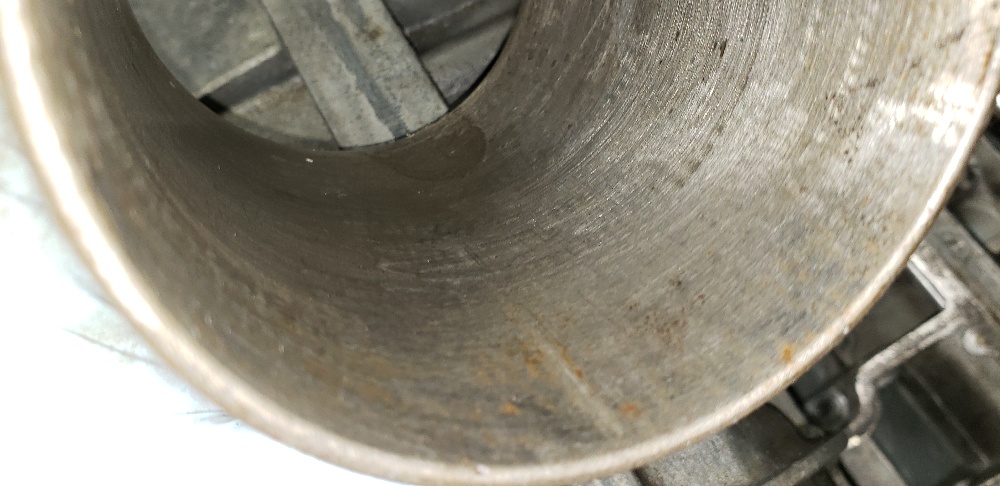

I will caution anyone thinking about doing business with DC Auto and Rob, their idea of a rebuildable motor is different then mine. In fact the only usable part my engines came with were the cases.
gms
post Feb 5 2023, 10:17 AM
Posts: 2,755
Joined: 12-March 04
From: Chicagoland
Member No.: 1,785

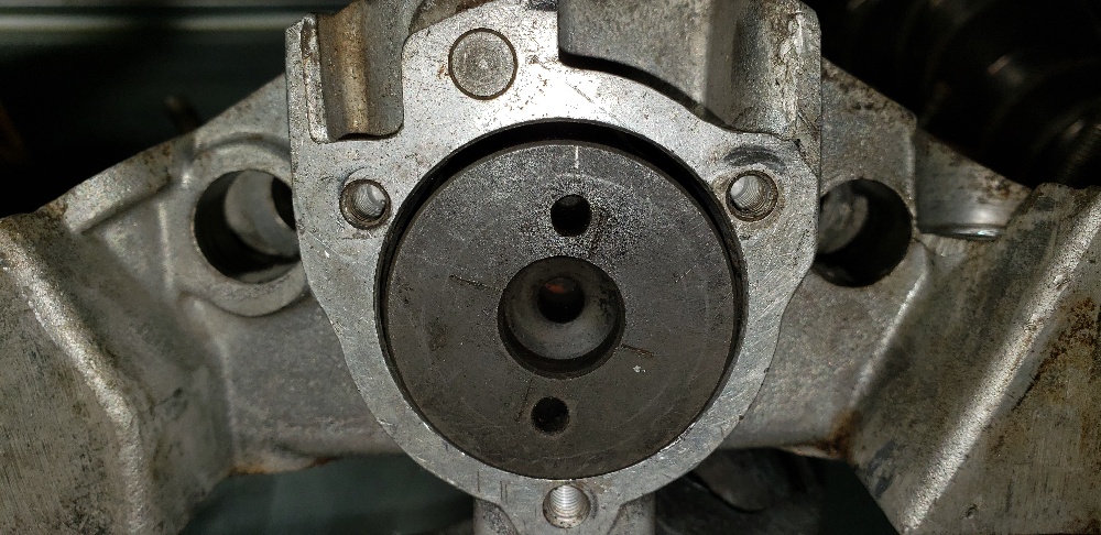

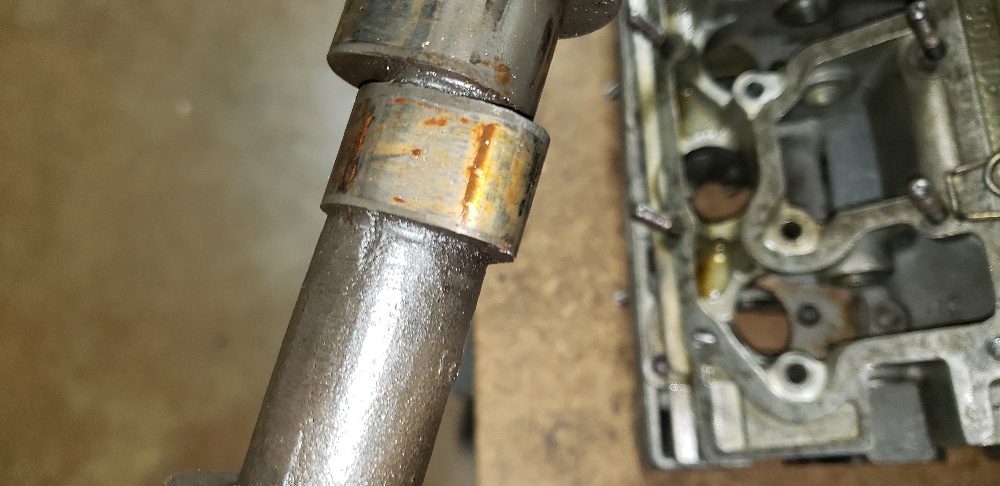

after the engines arrived I immediately pulled them apart and here is what I found
cam tower so twisted the rocker arms were stick
The other cam tower was junk, both sides were Left cams still wet and rusty

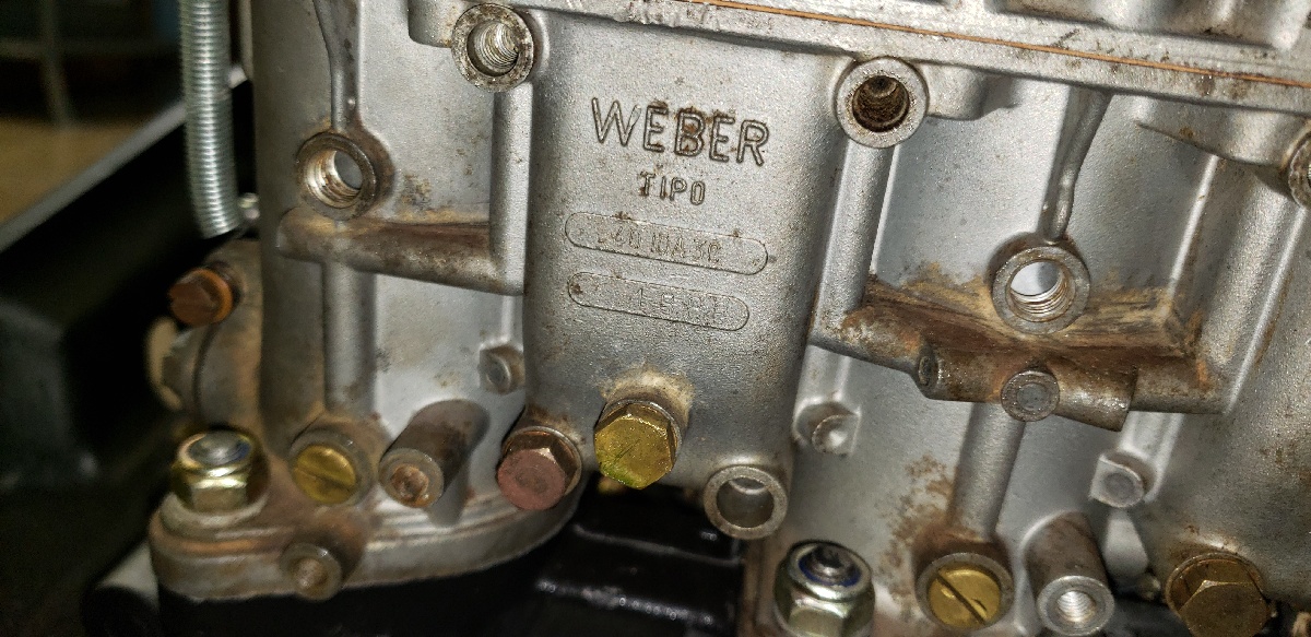

webers were seized and missing jets and jet holders
and the engine I paid an additional $500 for had a melted filter housing

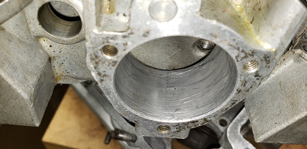

bearing surface scared
every cylinder was rusted but then sanded with about 120 grit sand paper to fit the pistons back in.

914/6 air cleaner- melted
Air cleaner snap cans – rusted thru
Weber IDA carbs – broken air correction screw, seized throttle shafts
Missing linkage cross bar, reverse lever and mounting brackets

2.2L pistons and cylinders – water damaged, cylinders sanded

Zenith cards - seized throttle shafts, incorrect for 914/6

2.2L pistons and cylinders – mismatched set, water damaged, cylinders sanded

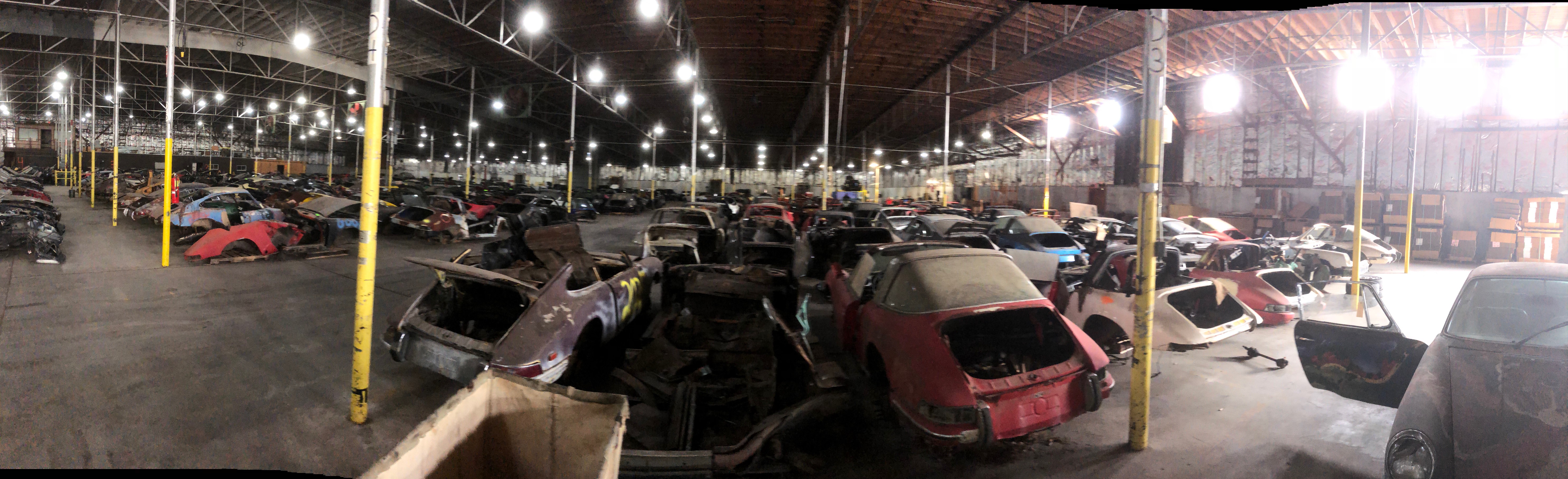

I've done well at DC, but I left with a truckload of cars.
davep
post Feb 6 2023, 08:44 AM
914 Historian
Posts: 5,376
Joined: 13-October 03
From: Burford, ON, N0E 1A0
Member No.: 1,244
Adam, you had a better result due to ton's of experience and inspecting in person while making the purchase. Meanwhile Glenn got a pig in a poke.
