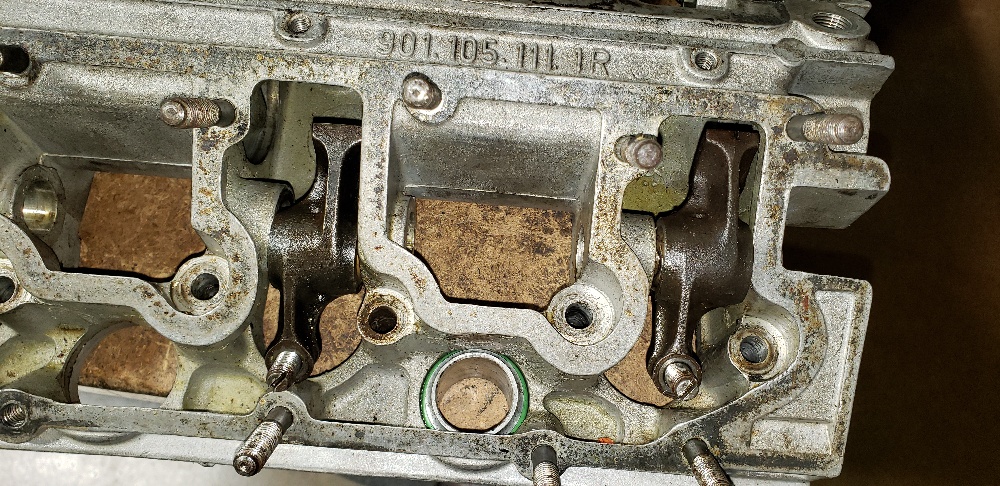

I will caution anyone thinking about doing business with DC Auto and Rob, their idea of a rebuildable motor is different then mine. In fact the only usable part my engines came with were the cases.
gms

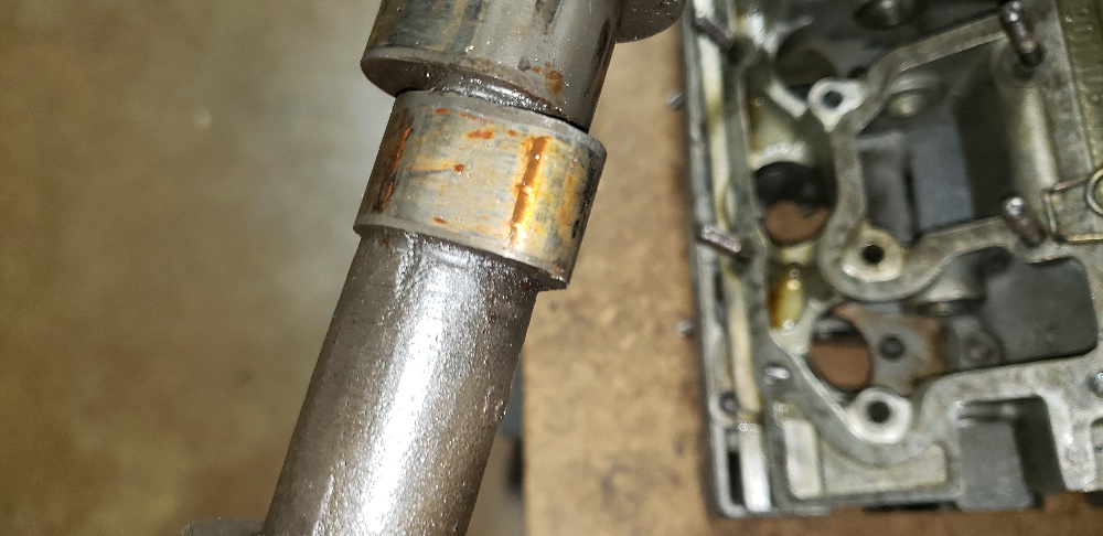

after the engines arrived I immediately pulled them apart and here is what I found
cam tower so twisted the rocker arms were stick
The other cam tower was junk, both sides were Left cams still wet and rusty
gms

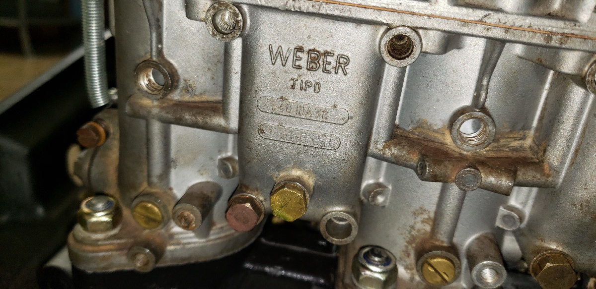

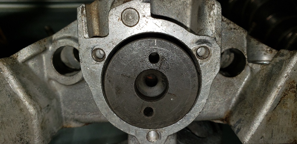

webers were seized and missing jets and jet holders
and the engine I paid an additional $500 for had a melted filter housing

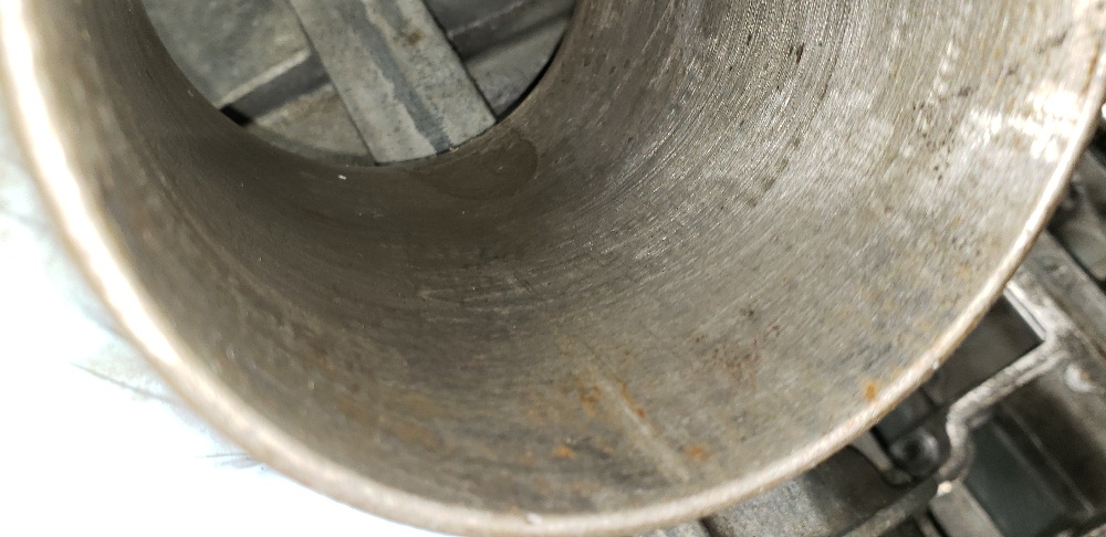

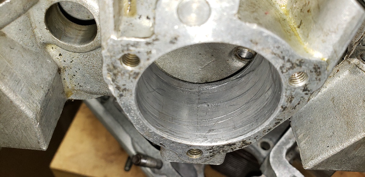

bearing surface scared
every cylinder was rusted but then sanded with about 120 grit sand paper to fit the pistons back in.

I sent this to Rob and he sent me a set of 80 mm heads without valves and some useless pistons pistons
Engine 1

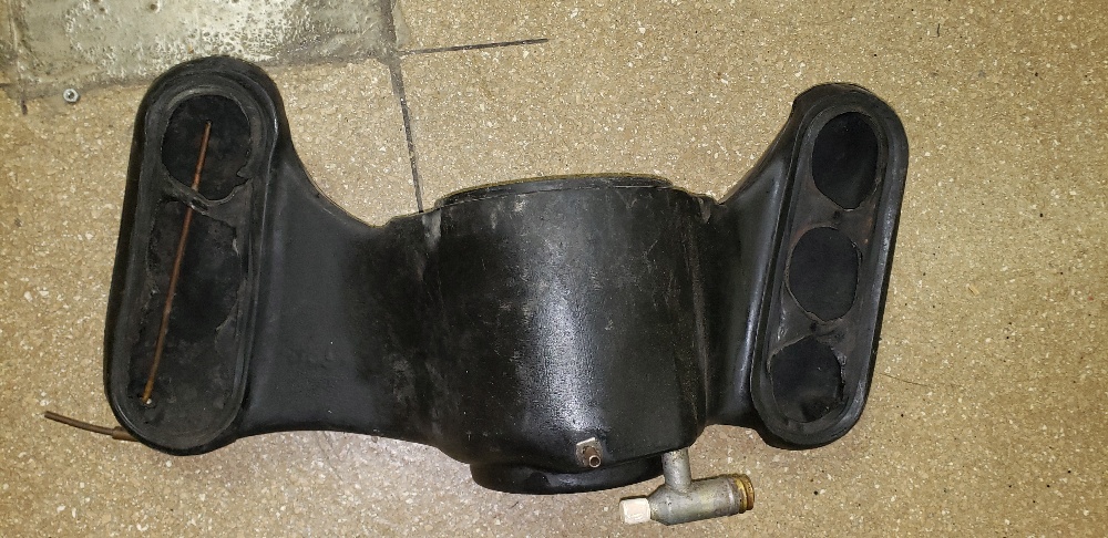

914/6 air cleaner- melted
Air cleaner snap cans – rusted thru
Weber IDA carbs – broken air correction screw, seized throttle shafts
Missing linkage cross bar, reverse lever and mounting brackets
Cam shafts pitted
Both cam towers – gouged cam bearing areas, second twisted
Oil Cooler – crushed & does not hold pressure
Heads (2.0 L1819d 911T) fly cut to 2.2L, inconsistent combustion chamber volumes, many studs missing
2.2L pistons and cylinders – water damaged, cylinders sanded
Missing 2 rear engine transmission mounting studs m10x105mm (999.062.099.02)
Engine 2
Only 1 K&N filter
Zenith cards - seized throttle shafts, incorrect for 914/6
Alternator ring cracked (fan and alternator acceptable)
fiberglass engine shroud - broken mounting holes, Incorrect version
Oil Cooler – AN? fitting welded to bottom
2.2L pistons and cylinders – mismatched set, water damaged, cylinders sanded
Oil pump - Seized
Missing flywheel
Missing 2 rear transmission mounting studs m10x105mm (999.062.099.02)

Same on the plastic air cleaner assembly.
