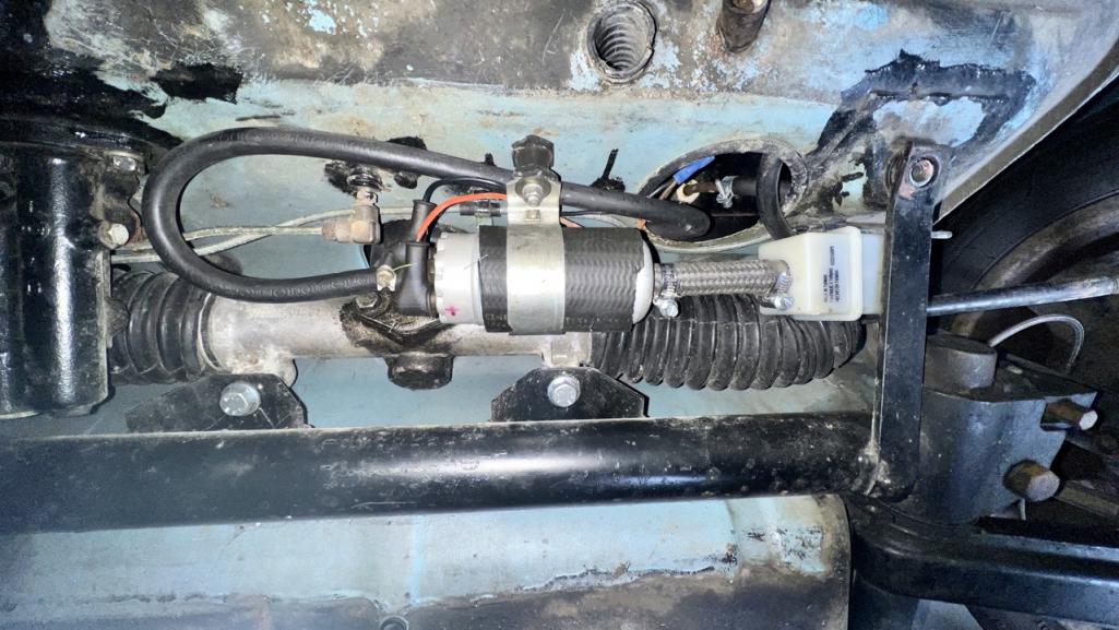

Anyone relocated the fuel pump and filter under the steering rack with to make it easier to change the fuel filter? Pictures? Thanks

FlacaProductions
post Feb 4 2023, 09:48 AM
Posts: 2,180
Joined: 24-November 17
From: LA
Member No.: 21,628
Geezer914
post Feb 4 2023, 10:57 AM
Geezer914
Posts: 2,275
Joined: 18-March 09
From: Salem, NJ
Member No.: 10,179
Thanks for the pic.

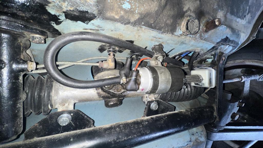

Literati914
post Feb 4 2023, 11:11 AM
Posts: 2,268
Joined: 16-November 06
From: Dallas, TX
Member No.: 7,222
I’m planning the same .. any more pics out there? A few different angles would help clear the mind tbh (IMG:style_emoticons/default/blink.gif) (IMG:style_emoticons/default/smoke.gif)

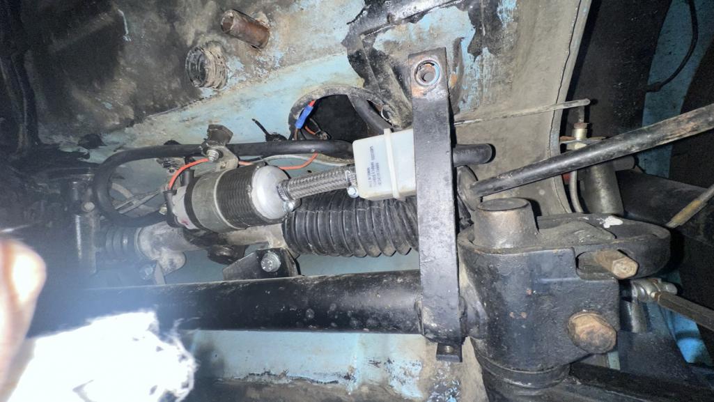

FlacaProductions
post Feb 4 2023, 11:37 AM
Posts: 2,180
From: LA
Member No.: 21,628
FlacaProductions
post Feb 4 2023, 11:46 AM
Posts: 2,180
From: LA
Member No.: 21,628
I know...I know....I don't like the blue crimp connector either but that's the PO's work. I'll get that corrected.

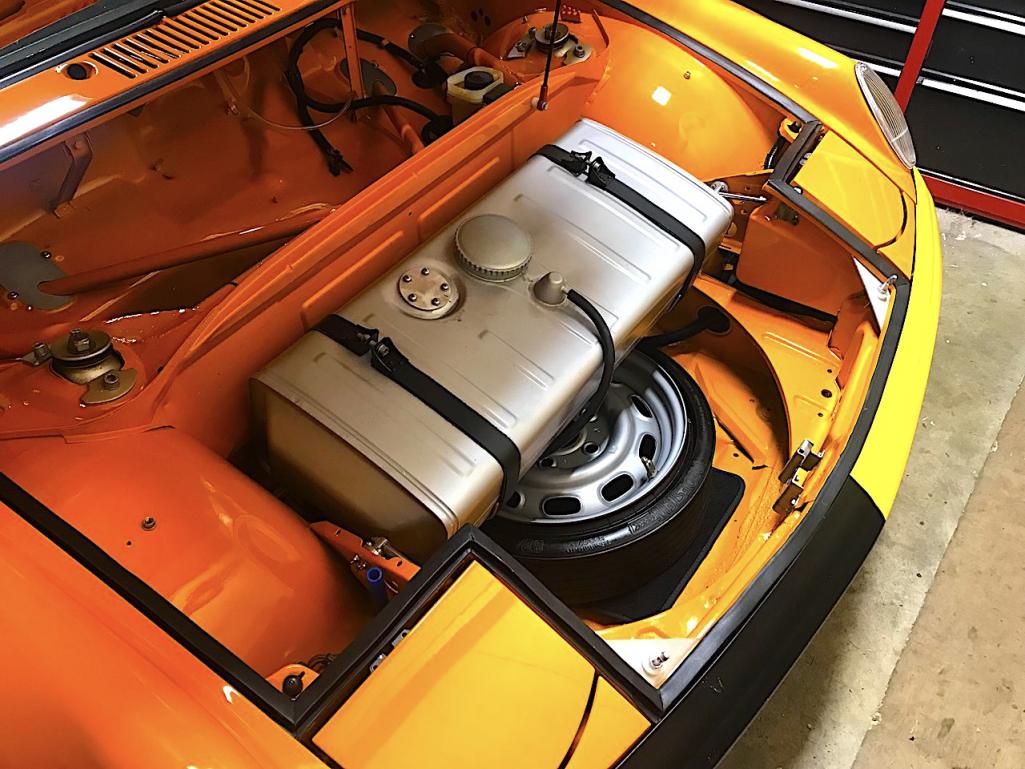

Geezer, not what your looking for but just to give you ideas. With my forward install fuel tank I mounted the filter and pump under the tanks for easy service. MarkAttached Image

QUOTE(mlindner @ Feb 4 2023, 10:13 AM) *
Hello,
Do you have a fuel filter before the fuel enters the fuel pump?
And is that metal bracket to cradle of the spare tire? Nicely done. Thanks.Todd

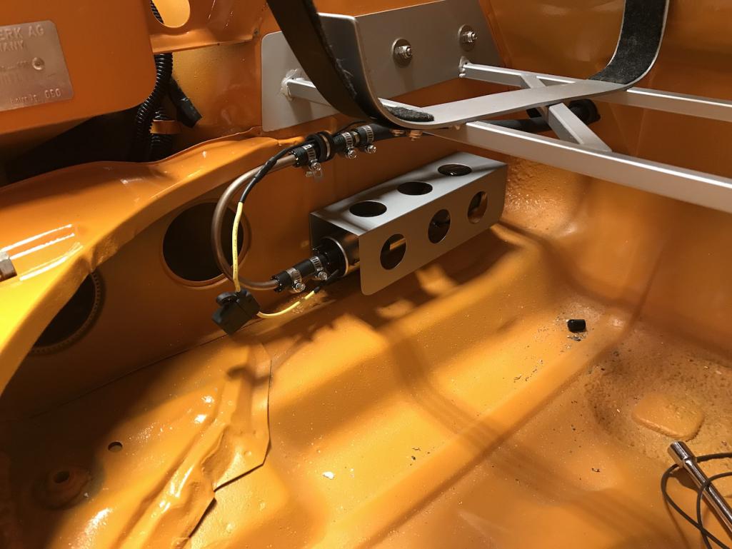

Roundtwo, yes filter always first. And I just cary a small spare.Attached Image
