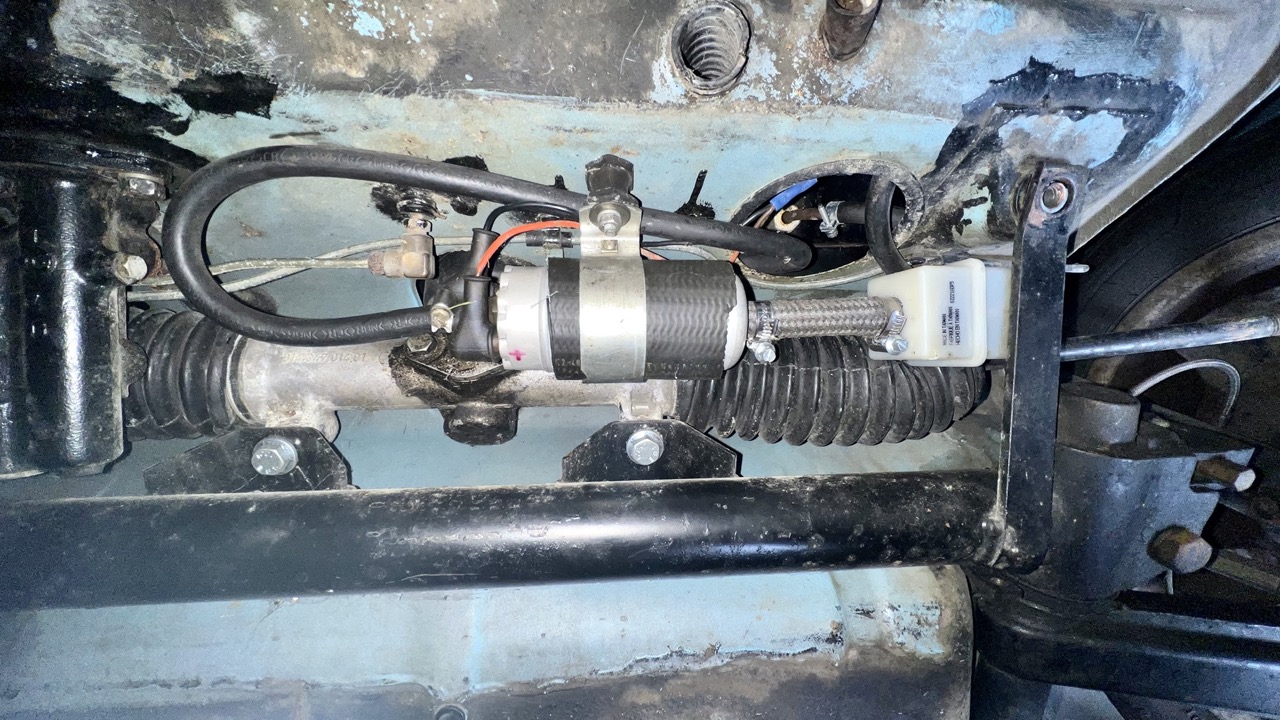

Anyone relocated the fuel pump and filter under the steering rack with to make it easier to change the fuel filter? Pictures? Thanks

Geezer914
post Feb 4 2023, 10:57 AM
Geezer914
Posts: 2,393
Joined: 18-March 09
From: Salem, NJ
Member No.: 10,179
Thanks for the pic.

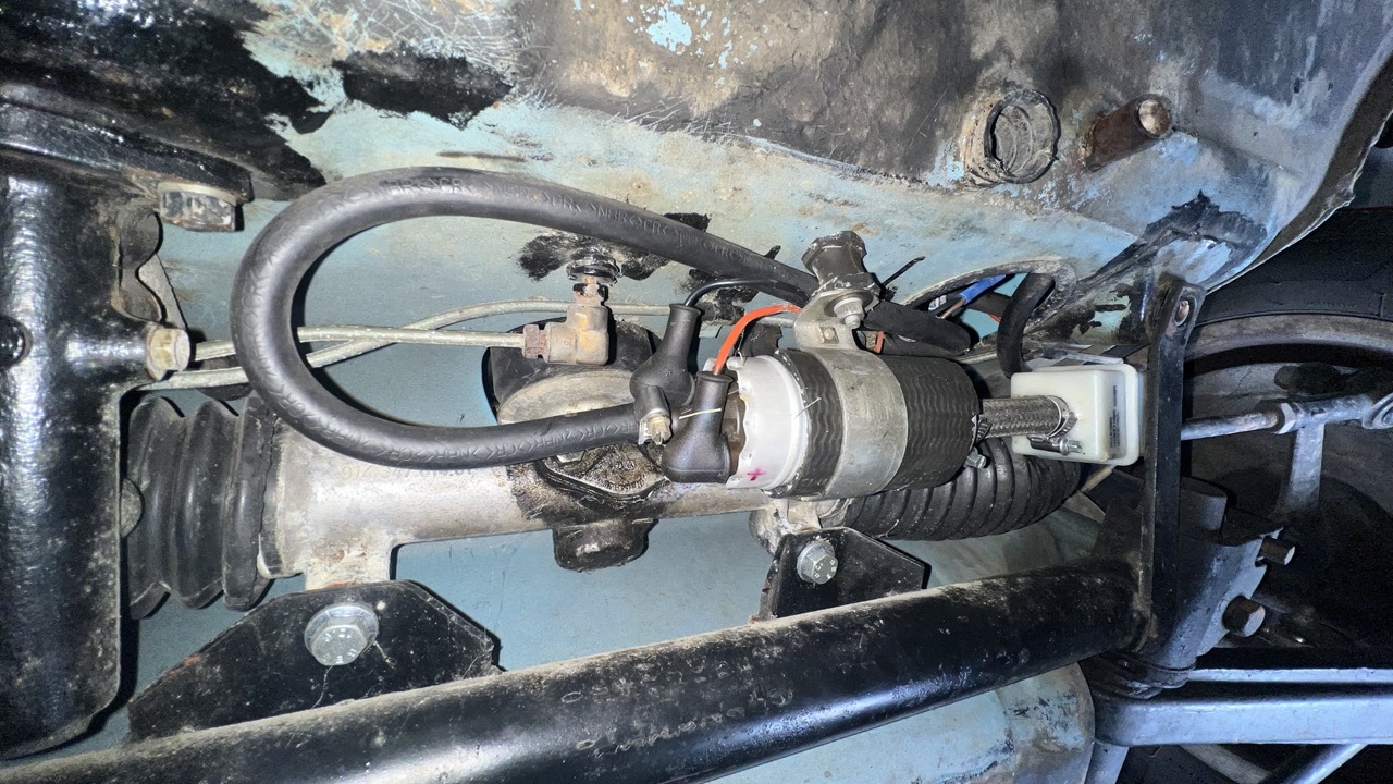

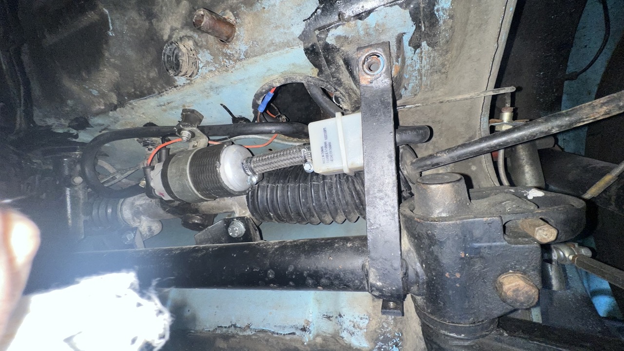

Literati914
post Feb 4 2023, 11:11 AM
Posts: 2,430
Joined: 16-November 06
From: Dallas, TX
Member No.: 7,222
I’m planning the same .. any more pics out there? A few different angles would help clear the mind tbh (IMG:style_emoticons/default/blink.gif) (IMG:style_emoticons/default/smoke.gif)
FlacaProductions
post Feb 4 2023, 11:37 AM
Posts: 2,304
Joined: 24-November 17
From: LA
Member No.: 21,628
FlacaProductions
post Feb 4 2023, 11:46 AM
Posts: 2,304
From: LA
Member No.: 21,628
I know...I know....I don't like the blue crimp connector either but that's the PO's work. I'll get that corrected.

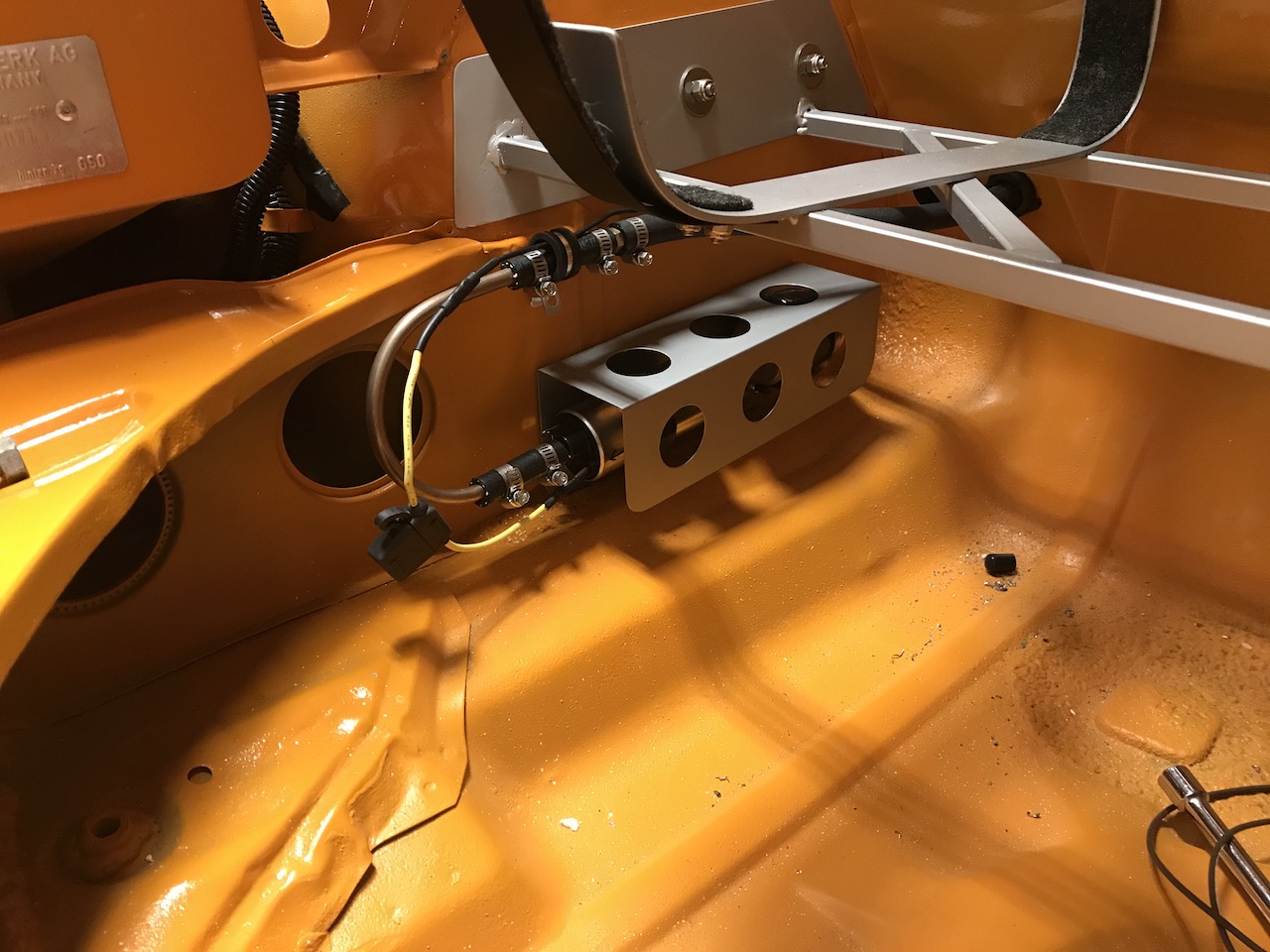

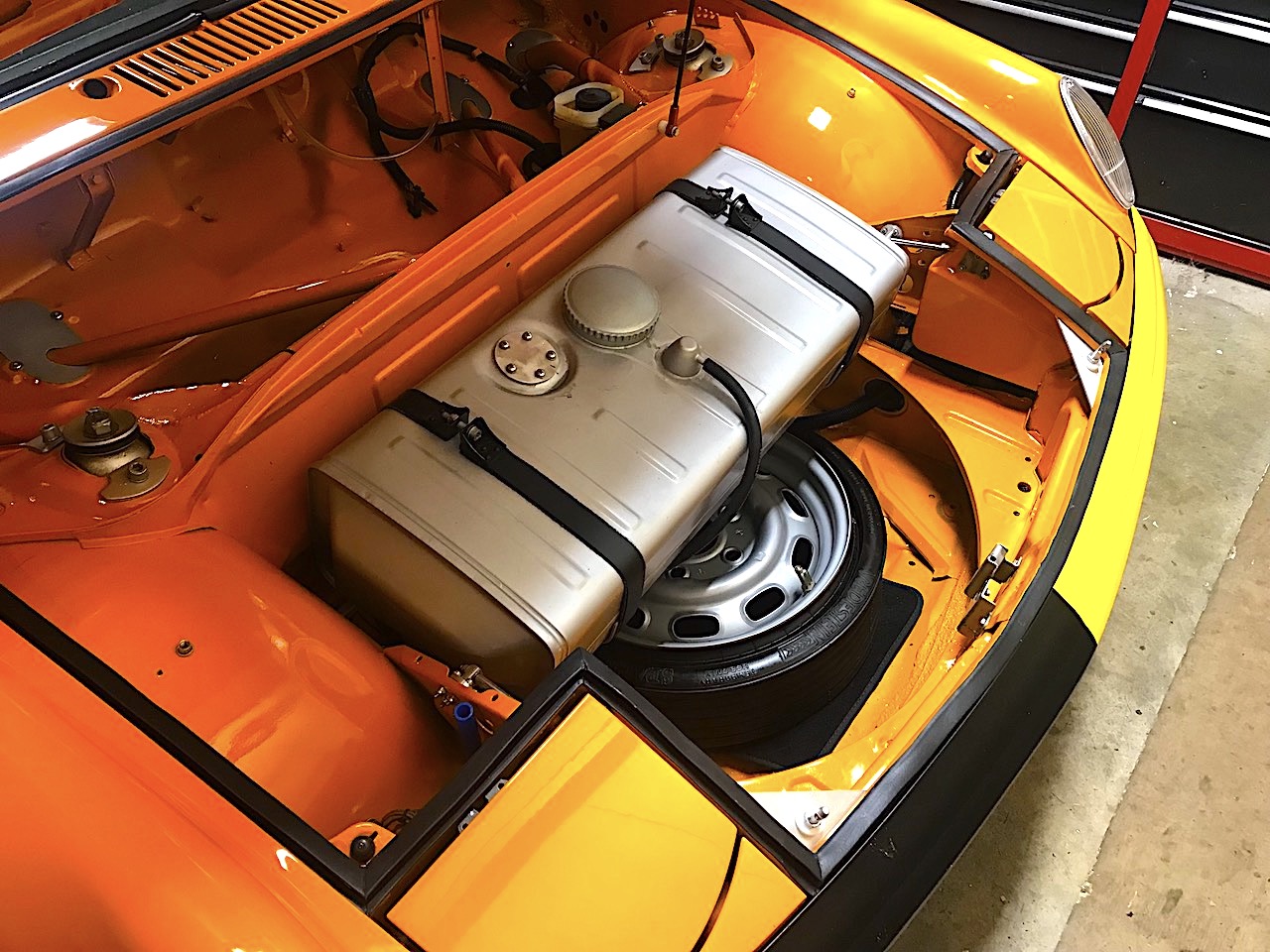

Geezer, not what your looking for but just to give you ideas. With my forward install fuel tank I mounted the filter and pump under the tanks for easy service. MarkAttached Image

QUOTE(mlindner @ Feb 4 2023, 10:13 AM) *
Hello,
Do you have a fuel filter before the fuel enters the fuel pump?
And is that metal bracket to cradle of the spare tire? Nicely done. Thanks.Todd

Roundtwo, yes filter always first. And I just cary a small spare.Attached Image

I would not like having to remove the rack cover piece to simply change the filter or service the lines or the pump. ESP potentially on the side of the road.

QUOTE(rhodyguy @ Feb 4 2023, 10:26 AM) *
I like how protected it is up there.

Rhodyguy, if the pump or the filter craps out, that is something I would not attempt to fix on the side of the road. With the fuel pump under the gas tank, it's a pia to remove the plate and maneuver the fuel pump with the 12mm fuel line to get the filter out , and stuff everything back in hoping you didn't kink a fuel line. Under the steering rack, you remove 4 bolts and everything is right there. I would like to install a small fuel shutoff valve to make it easy to change the filter.
