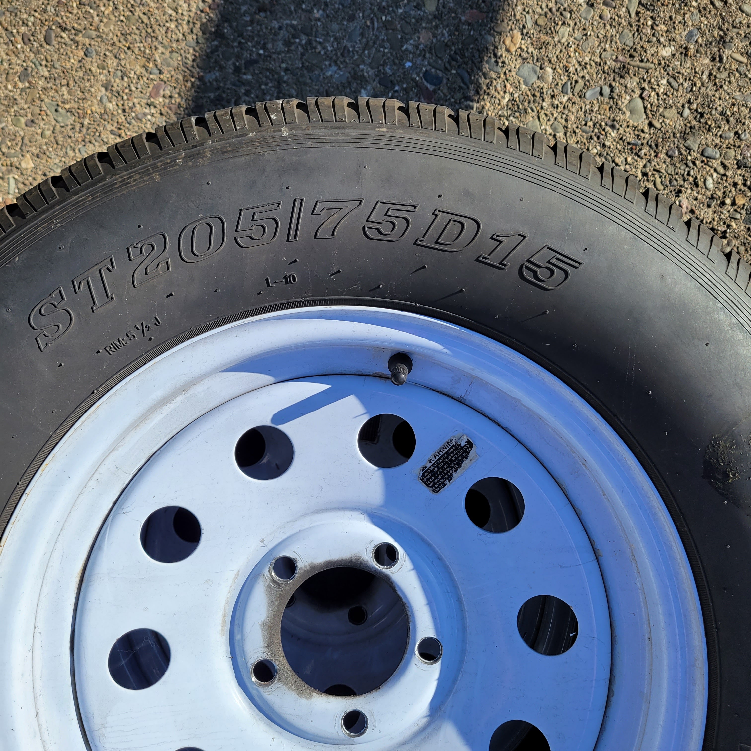

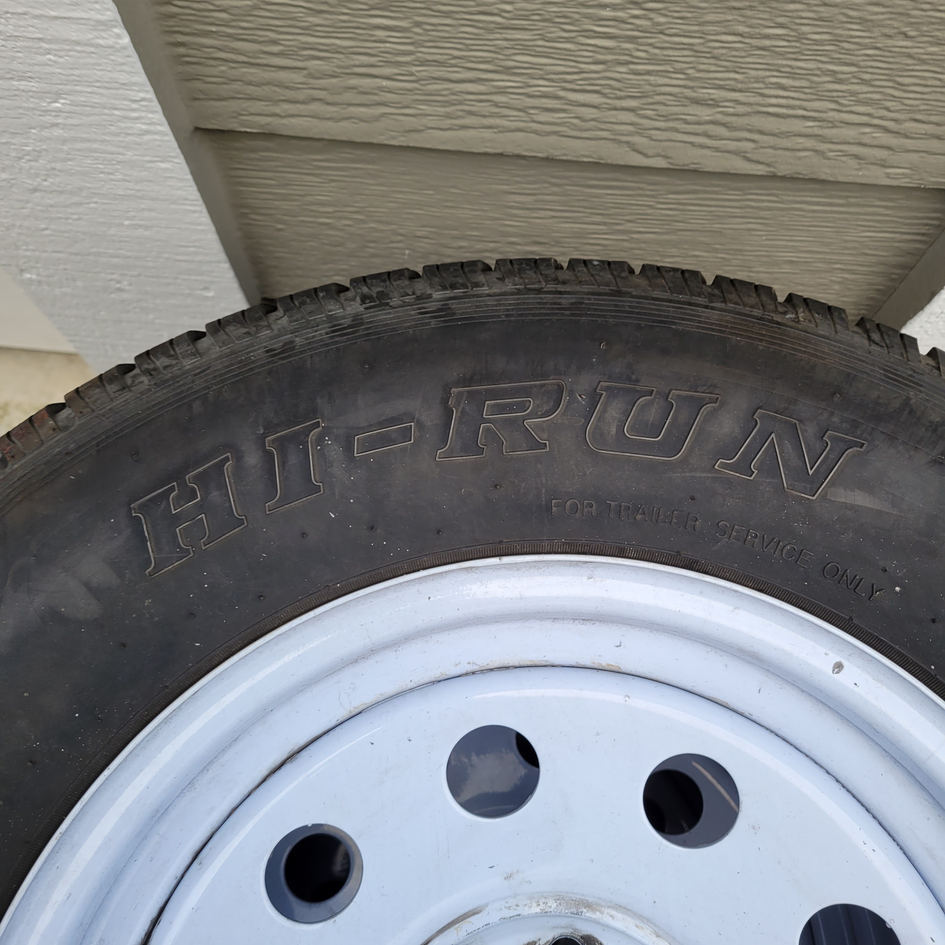

So my twin axle 7000 lb. open trailer is 8 years old and the date code on these tires will be 9 years soon. I know I must replace these tires. I completed inspected each tire every time I used the trailer. Maybe around 6-7k miles total. The tires look like they are maybe three years old. I think these were bias ply. They are Hi Run LQ 229 205/75 D 15. I just found these online for $69 each. For all I know Hi Run are crap tires now. Should I just go to COSTCO or Les Schwab? Does anybody have brand recommendations? Radial or bias ply?

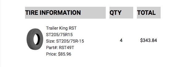

I called up Simple Tire and ordered the Trailer King RST tires. they are shipping the tires to the shop that I normally use free of charge. My tire guy liked that brand as well. They had no information as to the date code on the tires. They are allowing me to return the tires free of charge if I felt they were too old. I'd be happy with anything that was made 2022. $315 for a set of 4. Thank you all for your input!
