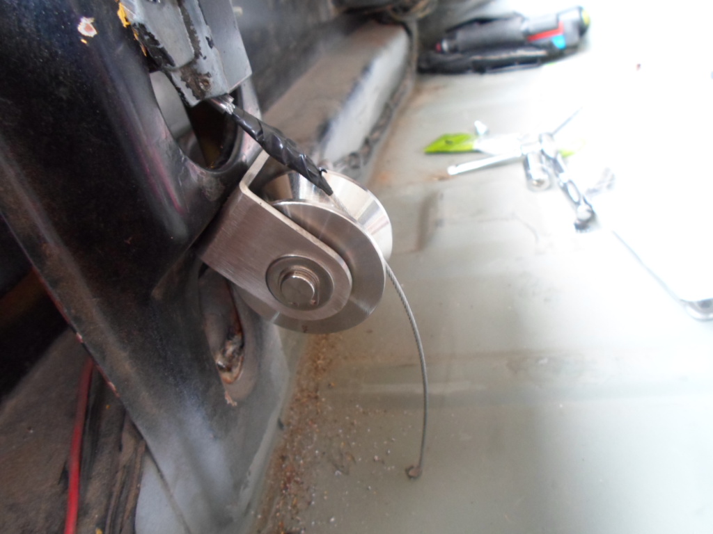

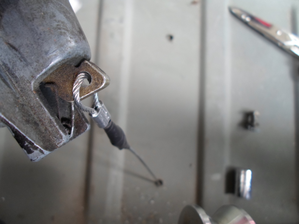

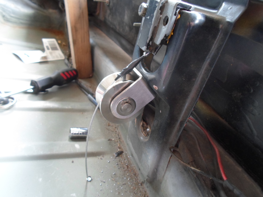

I attached a heavy gauge wire down thru a hole in the trunk floor
(with small grommet) accessible behind the muffler.

Down and dirty, cheap & easy. The hardest part is drilling through the latch....it's some of the hardest metal I've ever encountered. Needs heat shrink to replace the black tape, but you get the idea.
