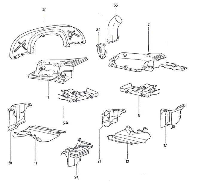

I am starting to reassemble my 1975 2L engine after tearing it apart 20 years ago. As it has been a long while since I started the teardown, I don't remember where and what all the pieces are. It would be awesome if anyone would send/post me a photo showing all the pieces and where they go (of the complete engine tins). Even better if anyone could tell me if a source of aftermarket engine tins can be found.

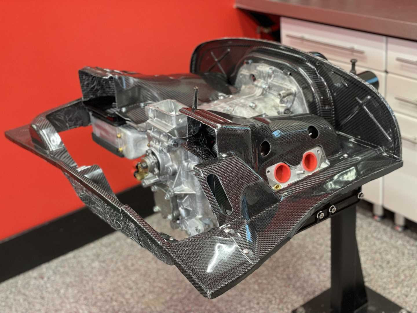

New Carbon fiber tin is available but it’s $$$$$

Buy a Haynes manual
zoomCat
post Feb 12 2023, 09:57 AM
Posts: 201
Joined: 13-August 04
From: Cincinnati, OH
Member No.: 2,526
Check page 197:
http://p914-6info.net/PDFs/Group%201%20Engine%20914-4.pdf

QUOTE(JeffBowlsby @ Feb 12 2023, 08:14 AM) *
Who sells that?

https://lnengineering.com/raby-s-aircooled-...ne-tin-kit.html

"are not plug and play as the bolt and screw holes are not pre-drilled on the shrouds and will have to be added during the installation process"
For that princely sum you'd thinks they were complete & delivered wrapped in silk (IMG:style_emoticons/default/biggrin.gif)

If money is not an issue.make it carbon fiber…

When you put the tin back on REMEMBER, pieces 5 and 5a need to go on before the pushrod tubes are installed. I don't think you can install them with the tubes installed. Often they are just left on the motor.

Thanks for the heads up. Those pieces are what I was looking for and as I recalled they go at the bottom of the cylinders above the pushrod tubes.

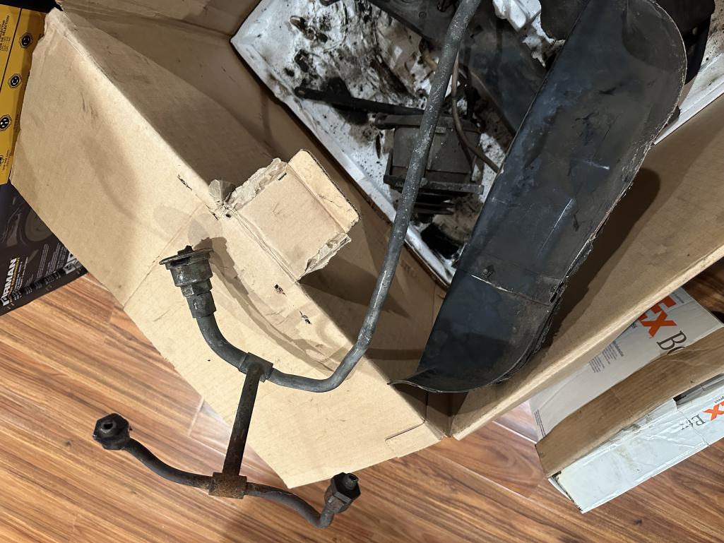

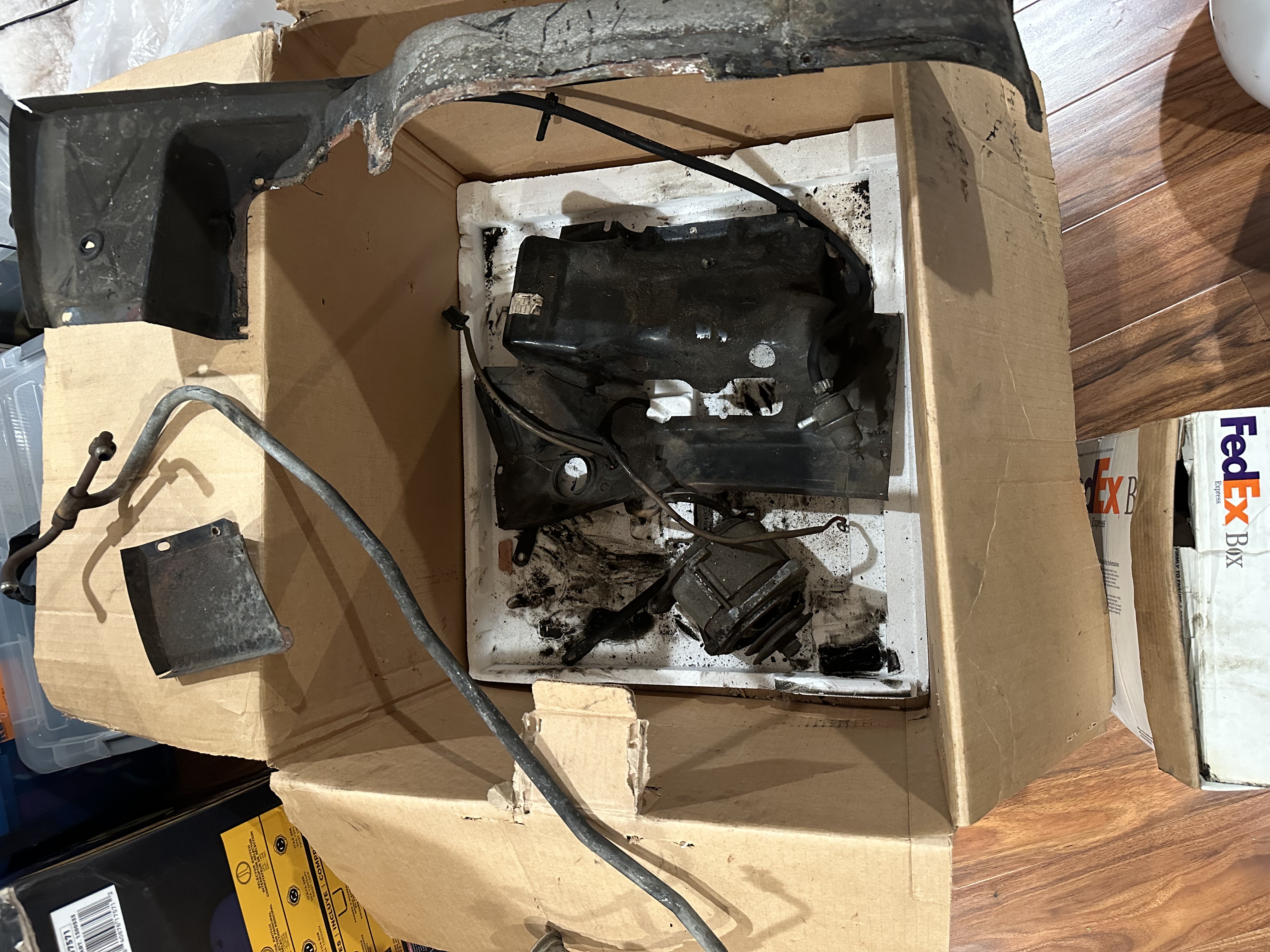

Found a box containing piece #1 and 27 in addition to the alternator and piece of the fuel rail.

The fuel rail at one end a part was cut off. Is that the fuel pressure regulator?

That is your air injection system. The one way valve is cut. This is smog equipment. It looks like the air pump that feeds it is in the box below it.
