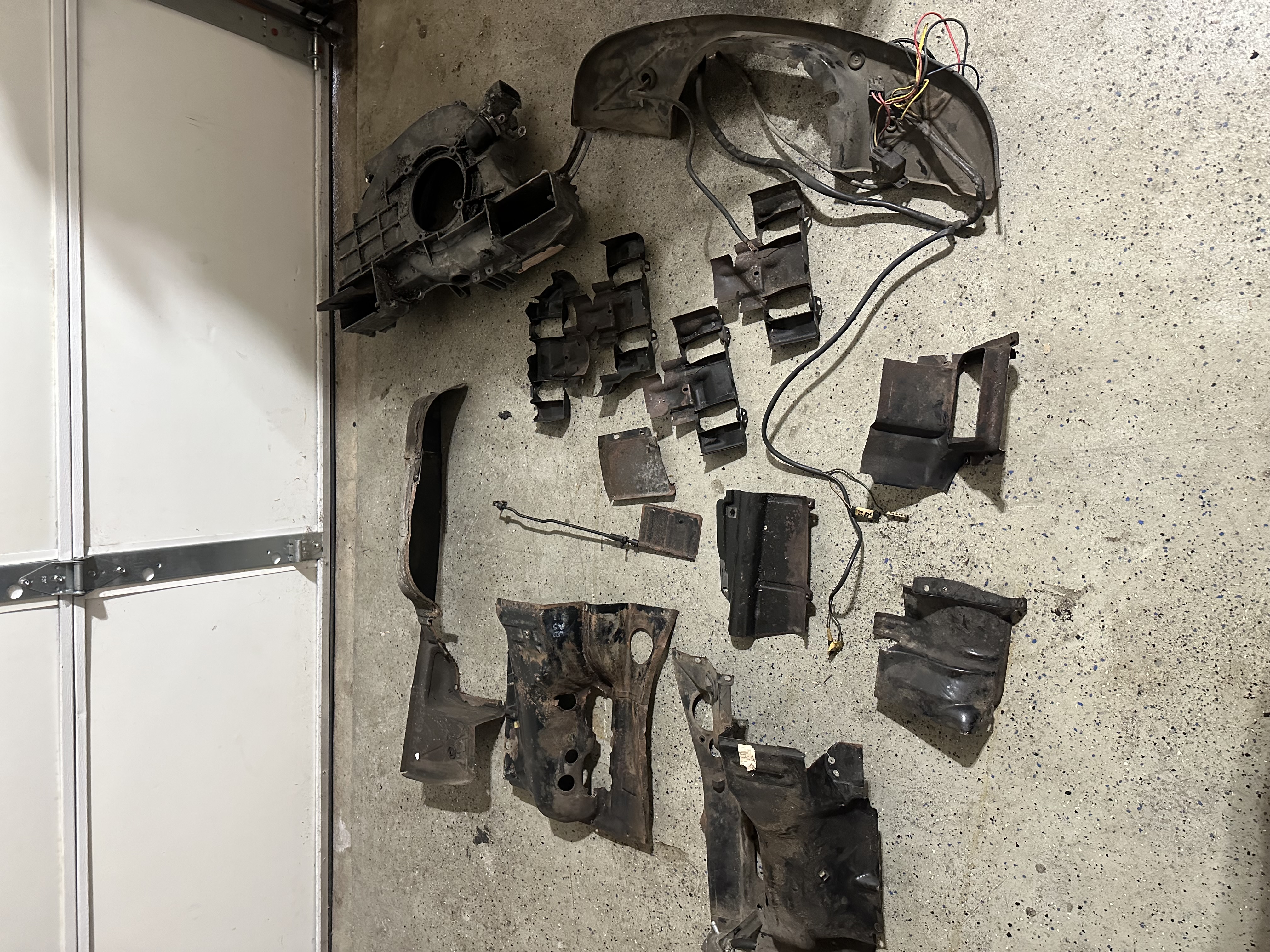

Clay
Thanks for the clarification.
I have a few pieces #'s 5, 5A, 17 & 24 of a 1974 1.8 motor if tshid914 needs them.
See photo
Tom Michigan

Thanks Tom in Michigan, after you sent me those pieces I found the others except for #32 and 33 in my shed. They will be cleaned and wire brushed then surface rust will be converted with VHT rust converter then painted with POR15Attached Image
