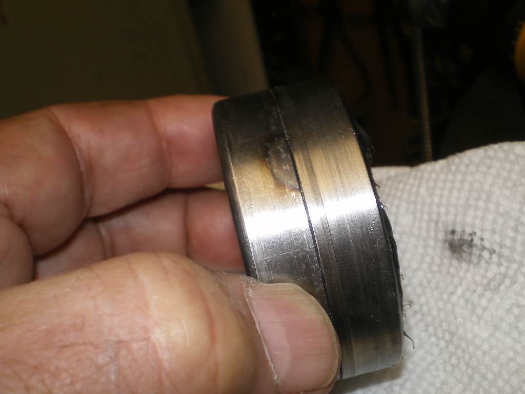

The tool is obviously the best way, but if you use an old race make a cut through it with a cut off wheel.
This allows the old race to be easily removed...

I removed the old ones from the late rotor, cut them and used them to press the new races in place (like in the video). I used a big impact socket and a piece of steel rod as well. The cut allowed me to squeeze it with pliers or use a screwdriver to get it out after it seated the new race.
I didn't want to buy a $40 tool set I'd use infrequently.
I have a lathe; maybe I'll make a tool for next time. I didn't want to spend the time this time since I need to get this done so the wife can have the garage back.

That is what I did last week. Welded the 2 old races together then turned one of them down ~.010".
