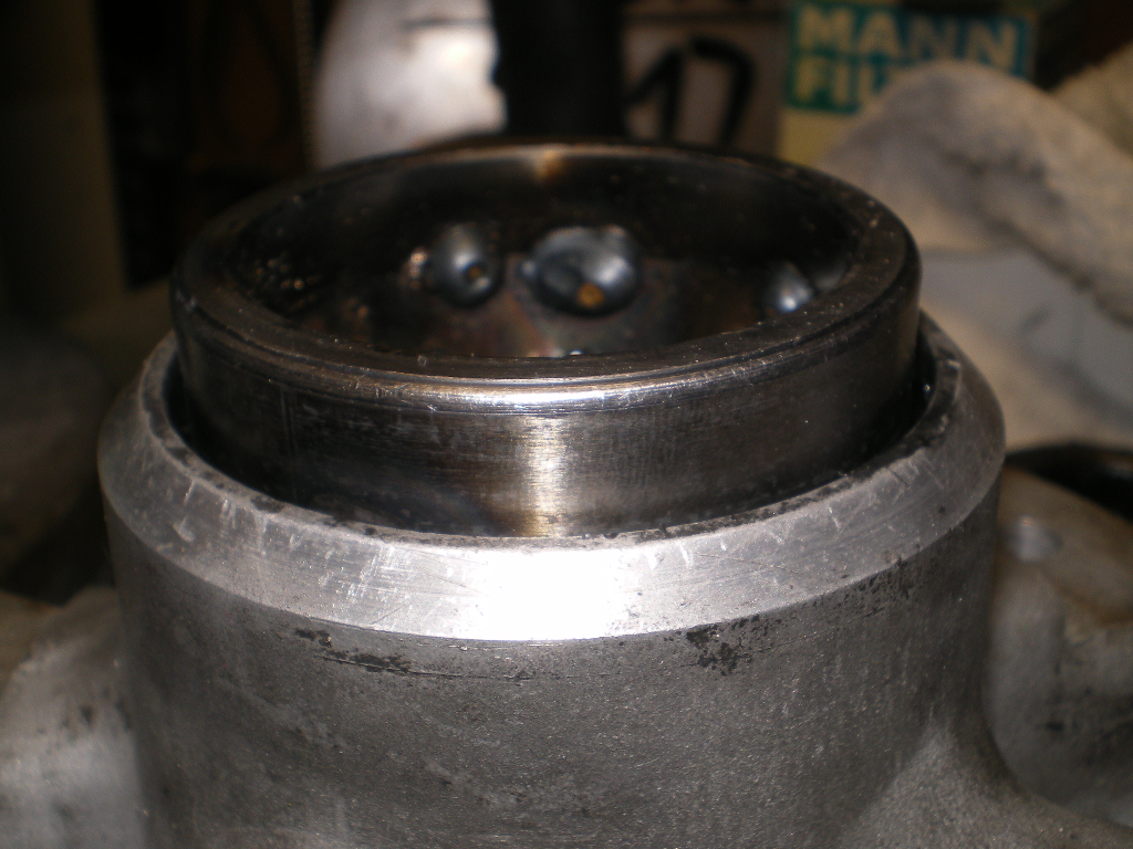

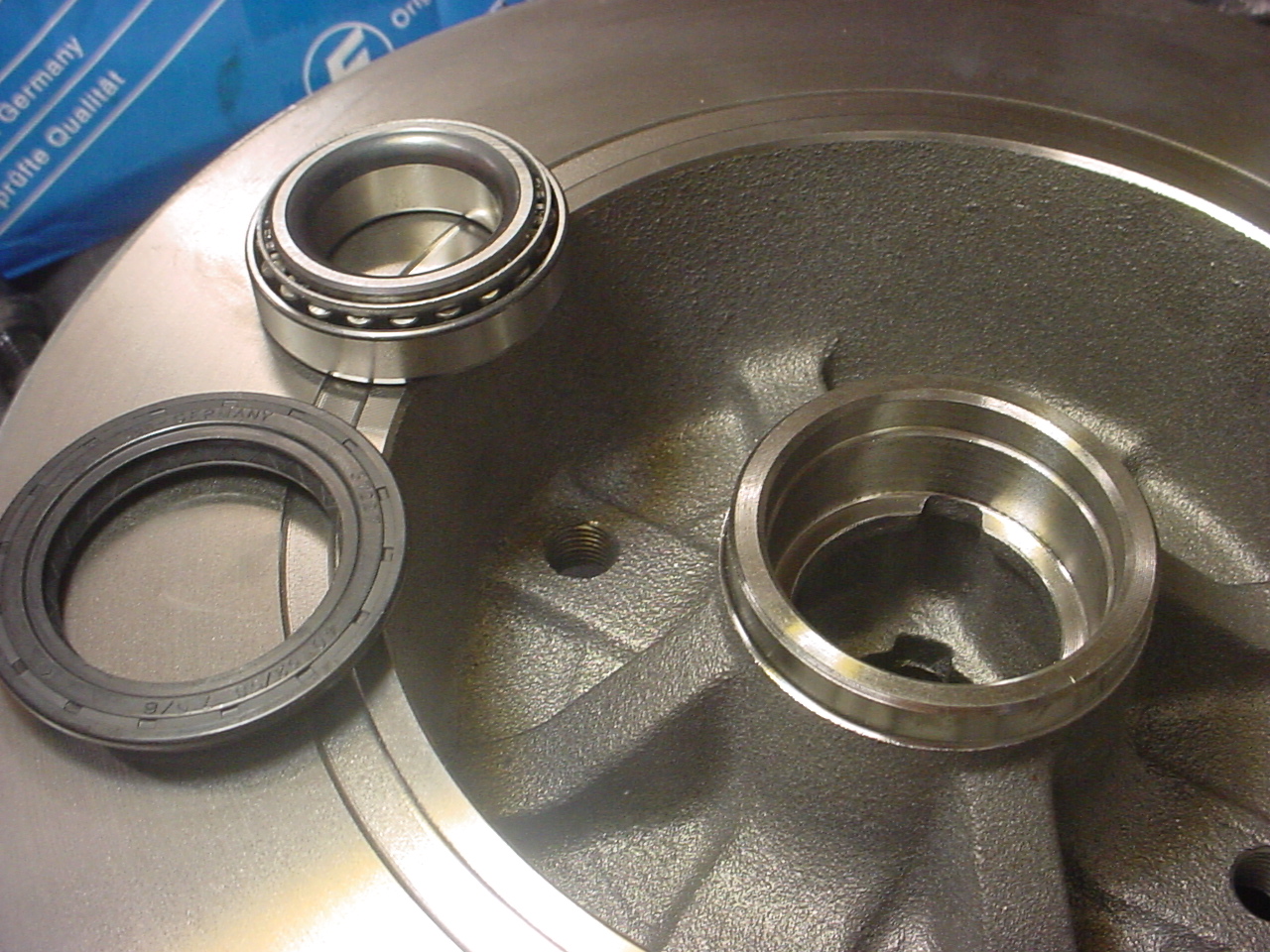

1. I need to press in the front wheel bearings. Can I just use a big socket and tap/hit them in? Is there a better way? I do not have a press.
2. What do I grease? I'm assuming a pack it in the bearings, but do I put grease anywhere else? Do I pack these before or after I press them in?

I'd scotch brite the new bearing bores and install with an old school wheel bearing race installation tool like this
https://www.harborfreight.com/bearing-race-...iece-63261.html
That ones a bit expensive. Check amazon.
I have used the old bearing race many times in the past. Sometimes it's tricky to get it back out.
A socket will work as well but it needs to fit the bore closely as the edges of most sockets are rounded and you can chip a race if not careful.
The bearings need to be packed either by hand or with a tool.
https://www.youtube.com/watch?v=BhL1uAp_WCw
https://www.amazon.com/Lisle-34550-Handy-Pa...g/dp/B0002NYDYO.
I will half fill the interior between the two bearings. This grease may never get used but it is there for a possible overheat. Leave plenty of space for expansion as I've seen overpacked hubs pop the inner wheel seal out before.

I removed the old ones from the late rotor, cut them and used them to press the new races in place (like in the video). I used a big impact socket and a piece of steel rod as well. The cut allowed me to squeeze it with pliers or use a screwdriver to get it out after it seated the new race.

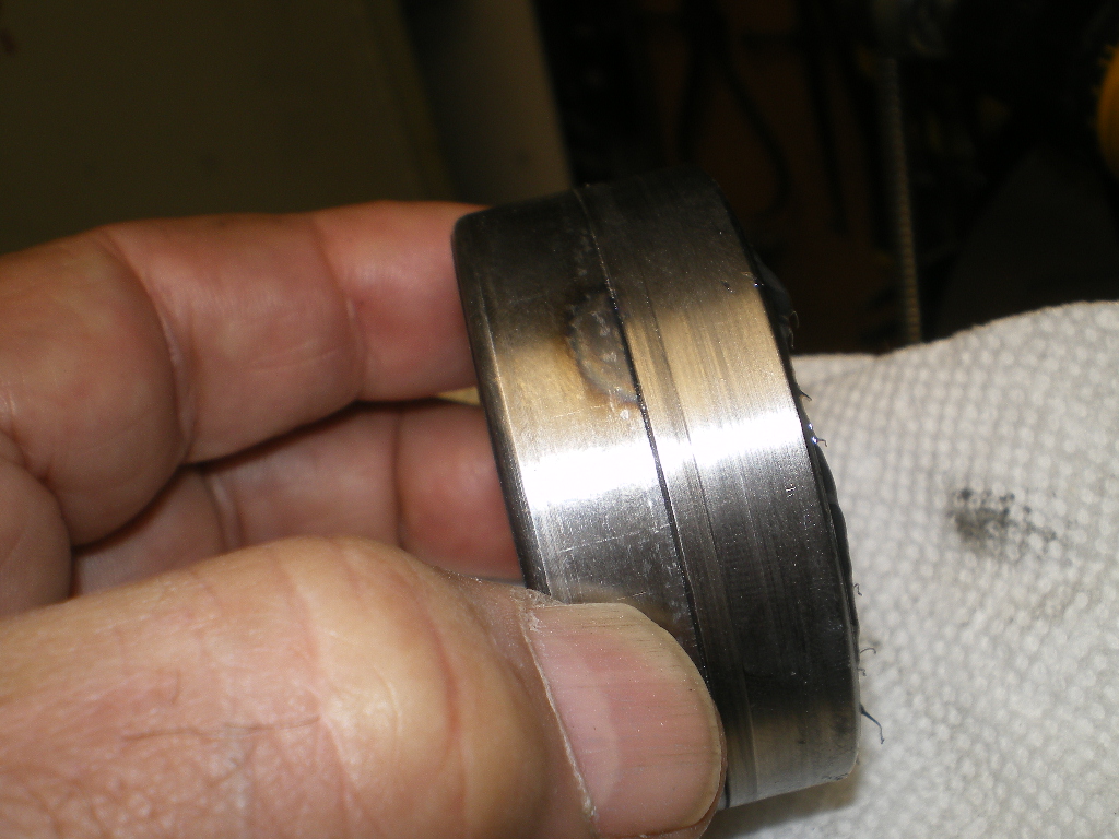

76-914
QUOTE(914 RZ-1 @ Feb 17 2023, 03:40 PM) *
I didn't want to buy a $40 tool set I'd use infrequently.
I have a lathe; maybe I'll make a tool for next time. I didn't want to spend the time this time since I need to get this done so the wife can have the garage back.
That is what I did last week. Welded the 2 old races together then turned one of them down ~.010".
