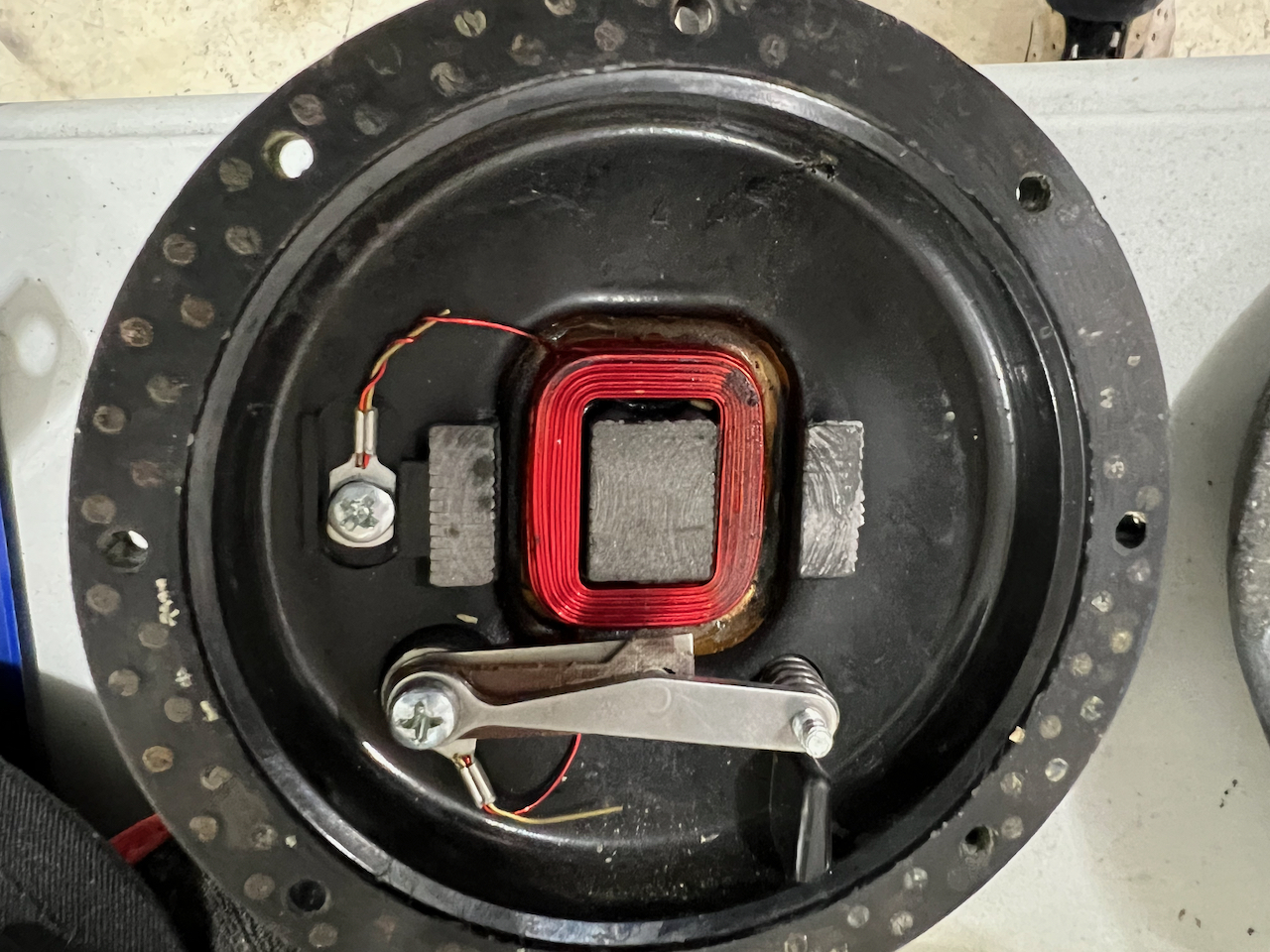

Can anyone offer a repair procedure or guide to restoring a non-functioning horn?
We have two original horns. One worked fine when wired to a car battery. The other is silent. Luckily the silent one has bolts instead of rivets so I could easily open it up.
The corrosion doesn't look too bad to me. The wires aren't broken. I used some sandpaper to try to clean between the contacts. The contact default state appears to be closed. Is that correct? It takes a surprising amount of pressure to separate the two.
What possible issues could there be with the diaphragm, other than it being perforated?

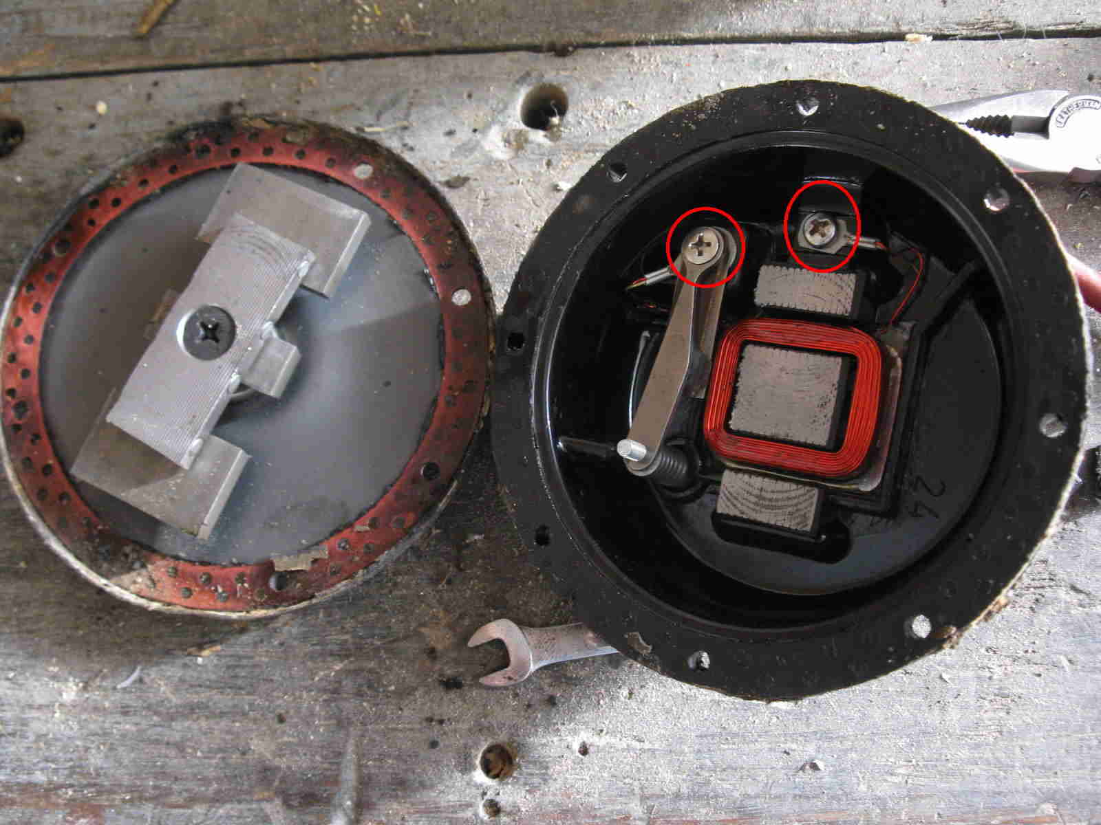

Found this on the Samba,
12V Hella Horn repair

I have found the most commin problem is corroded contact points.

That's what I was looking for. Thanks Garland
