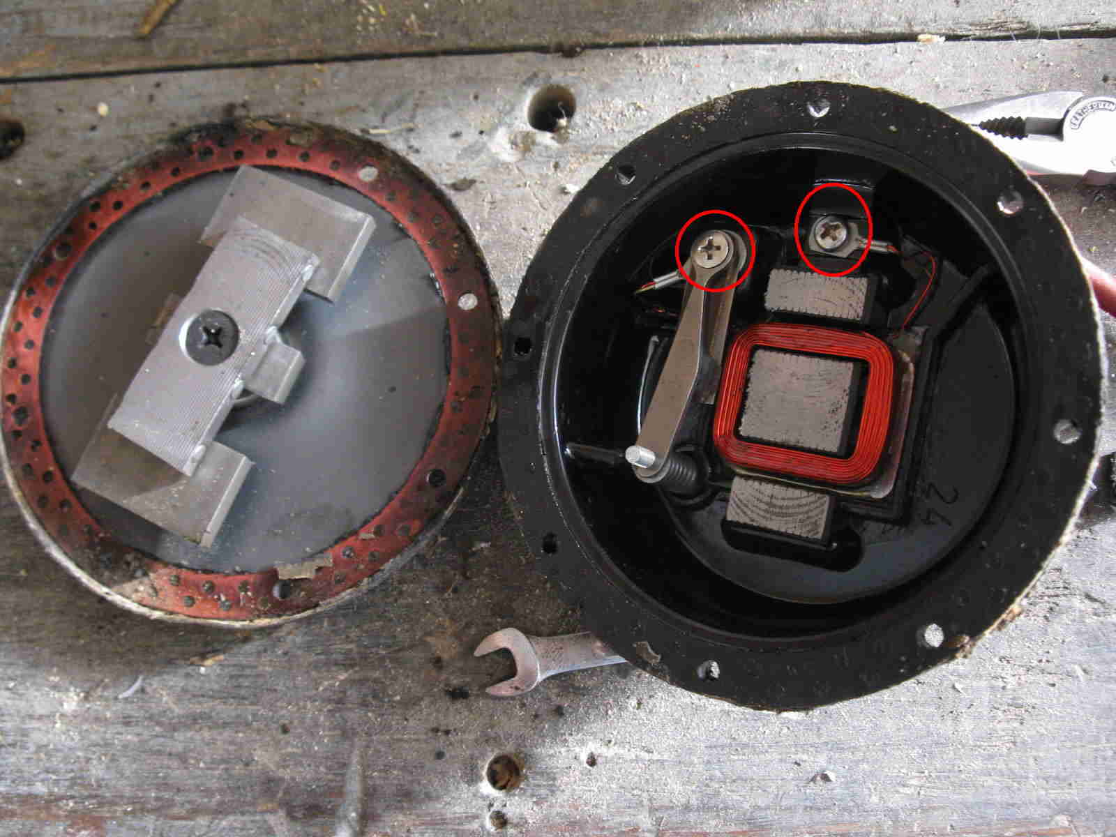

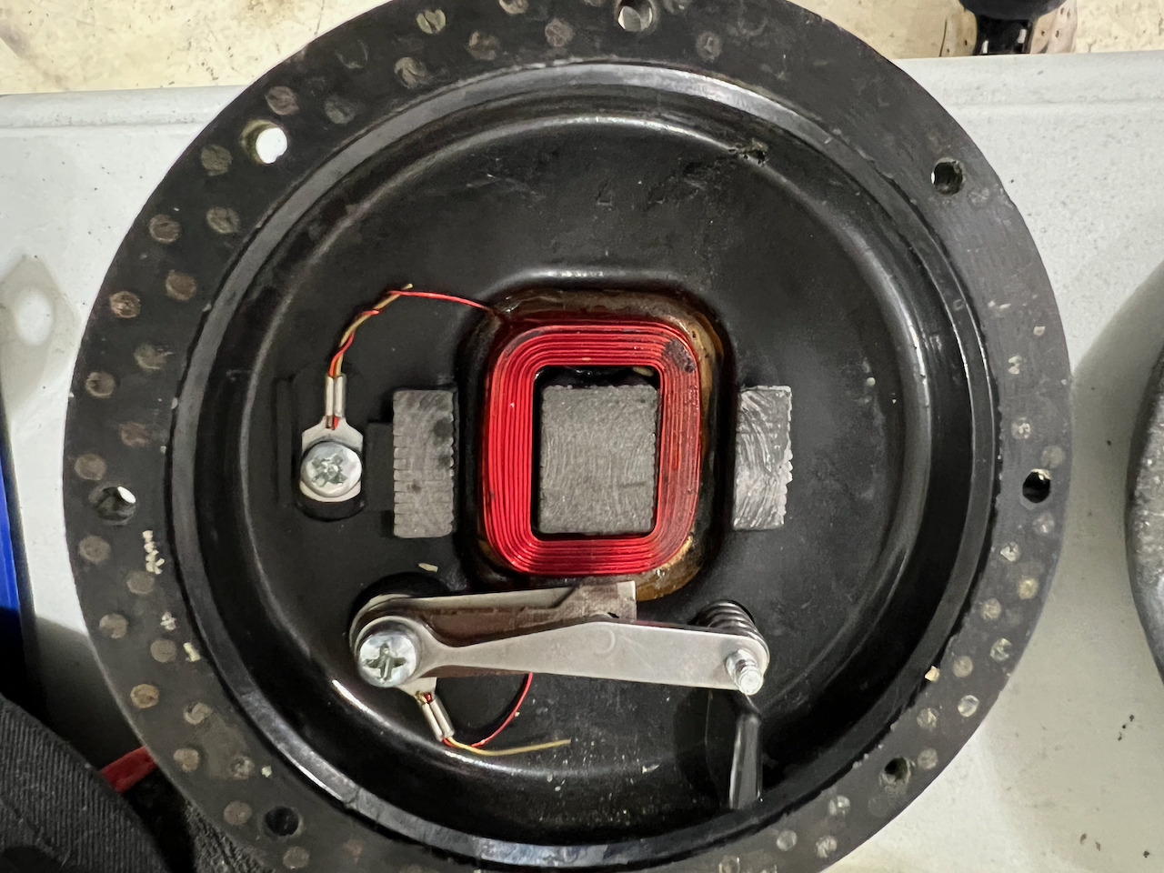

We have two original horns. One worked fine when wired to a car battery. The other is silent. Luckily the silent one has bolts instead of rivets so I could easily open it up.
The corrosion doesn't look too bad to me. The wires aren't broken. I used some sandpaper to try to clean between the contacts. The contact default state appears to be closed. Is that correct? It takes a surprising amount of pressure to separate the two.
What possible issues could there be with the diaphragm, other than it being perforated?

I have found the most commin problem is corroded contact points.
