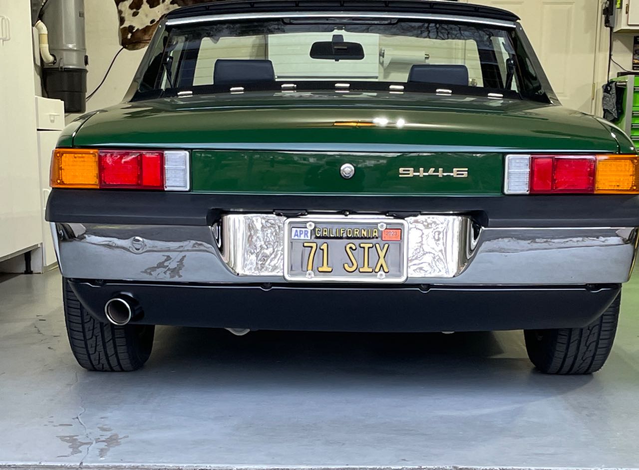

Here’s what I use, it comes out very close.
technicalninja
post Feb 20 2023, 12:54 PM
Posts: 2,531
Joined: 31-January 23
From: Granbury Texas
Member No.: 27,135
QUOTE(Garland @ Feb 20 2023, 10:58 AM) *
That is beautiful!
