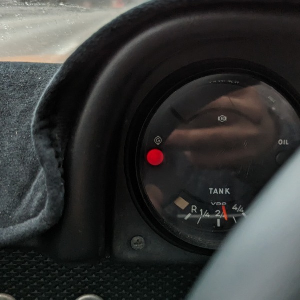

Hi folks! First time/long time for me here in the Garage. I just purchased a '74 1.8 in Ohio and it died on me in PA on the way home to NJ. Right before it died I noticed this bouncy/flappy tach thing happening.
(IMG:http://www.914world.com/bbs2/uploads_offsite/media.giphy.com-23760-1677337178.1.gif)
As you can see my speed is constant, my throttle inputs steady – just cruising. However the tach is going nuts.
When the car died (in a rest area off I-80 in PA) it would turn over but not start. We ran some rudimentary diagnostics and remediation measures:
- Heard clicking/popping noise coming from driver's side of engine bay at speed, this was accompanied by the flappy tach phenomenon
- Generator light came on at some point while driving
- When flappy tach/popping noises would happen, I'd notice the car losing power for a split second
- Electrical systems stopped working during my drive (door open buzzer stopped working mid-way through the trip)
- Replaced the battery with a brand new one, no dice
- Power at the coil
- No spark at the plugs
Car is at a shop in PA - they will get to diagnosing it over the next few days. I'd prefer to fix myself, but I can't get it home from where it is without basic drivability.
Has anyone ever had this happen? Is the flappy tach a symptom of a larger electrical issue?
I found the post on adding the 2200uf capacitor to stop bouncing when changing RPMs rapidly, but I don't think this is that issue. Especially since the bouncy tach and the car dying are correlated (I think).
Would love to tap into the collective wisdom of the platform to help point me in the right direction.

So the wacky, bouncy tach (and red light) pictured in the 1st post were a result of a bad voltage regulator (and my points were burnt - not sure if/how the two were related). I replaced the voltage regulator and points and now the tach is just a "little" bouncy now upon acceleration.
The P.O. wired the tach to a "Tach Adapt" unit, and that sends a signal to the tach itself. When I removed the Tach Adapt unit the dashboard fuse blew. So I re-attached it and am living with a mildly bouncy tach ATM.
