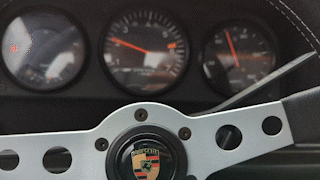

Hi folks! First time/long time for me here in the Garage. I just purchased a '74 1.8 in Ohio and it died on me in PA on the way home to NJ. Right before it died I noticed this bouncy/flappy tach thing happening.
IPB Image
As you can see my speed is constant, my throttle inputs steady – just cruising. However the tach is going nuts.

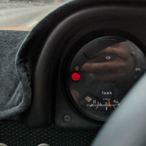

- Generator light came on at some point while driving

So the wacky, bouncy tach (and red light) pictured in the 1st post were a result of a bad voltage regulator (and my points were burnt - not sure if/how the two were related). I replaced the voltage regulator and points and now the tach is just a "little" bouncy now upon acceleration.
The P.O. wired the tach to a "Tach Adapt" unit, and that sends a signal to the tach itself. When I removed the Tach Adapt unit the dashboard fuse blew. So I re-attached it and am living with a mildly bouncy tach ATM.
