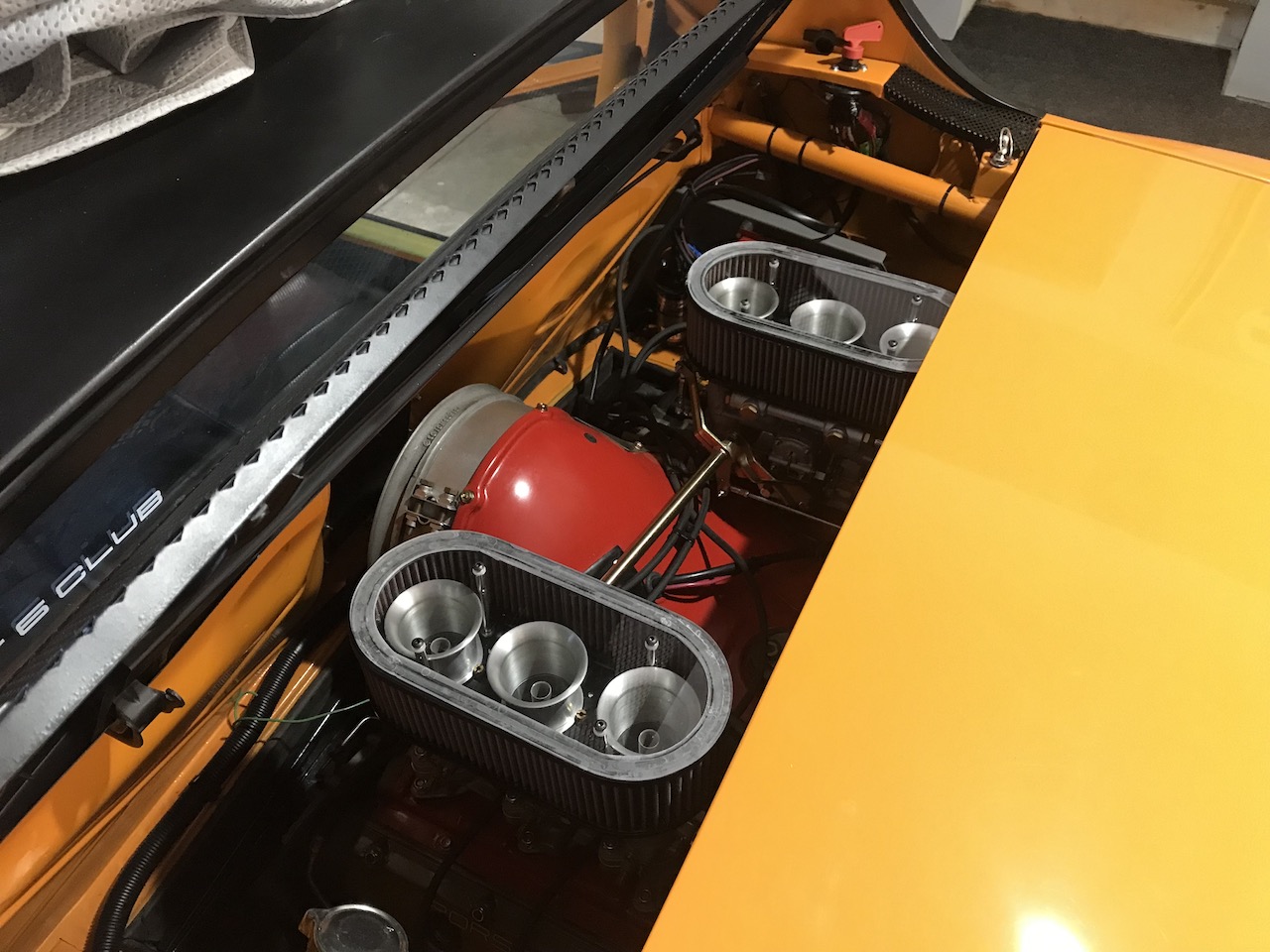

NARP74   For the Jenvey carbs, is that price per, or for a ...   Mar 7 2023, 09:11 AM
ClayPerrine   For the Jenvey carbs, is that price per, or for a...   Mar 7 2023, 09:58 AM
Eric_Shea   [quote name='NARP74' post='3063118' date='Mar 7 2...   Mar 8 2023, 01:03 PM
horizontally-opposed   Also the Jenvey will fit common IDF/IDA air clean...   Mar 8 2023, 06:25 PM
