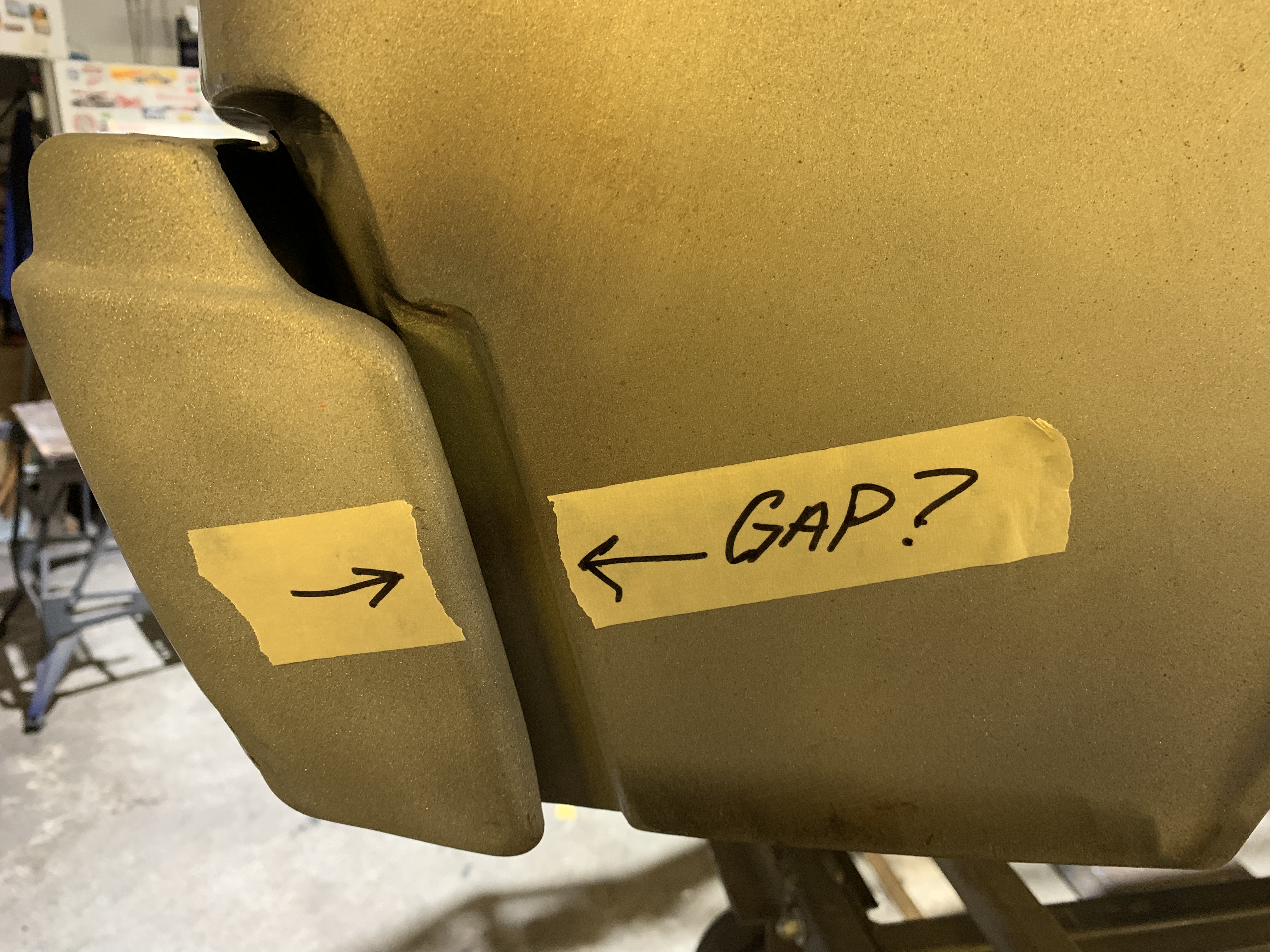

Hi was wondering if someone could help me out with the rear bumper gap measurement Attached Image

Salvaging bent bumper (IMG:style_emoticons/default/sad.gif)

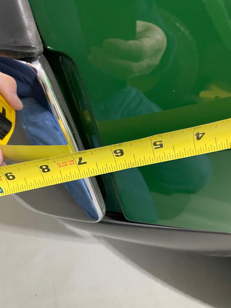

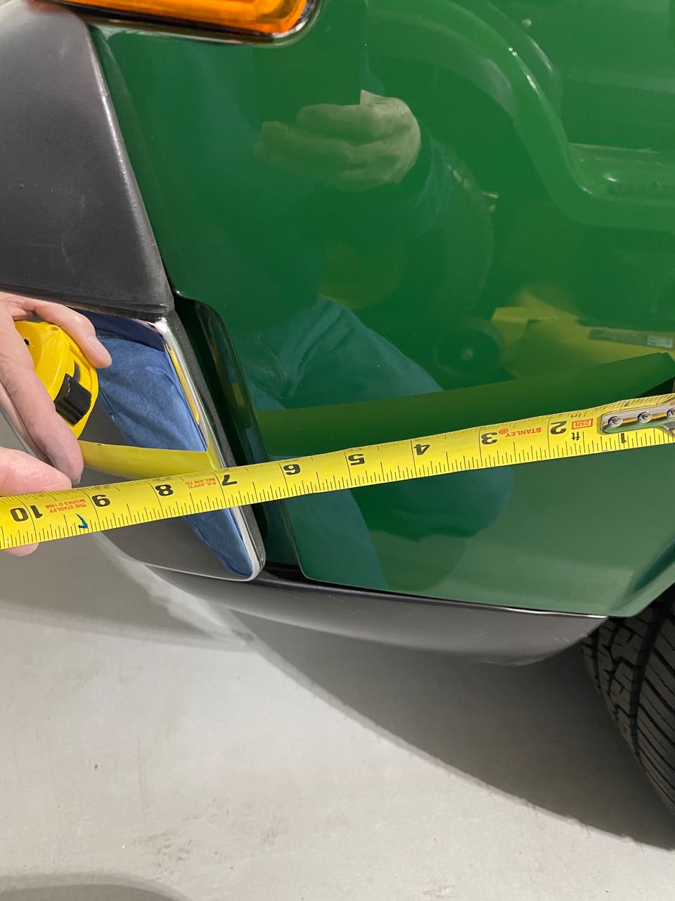

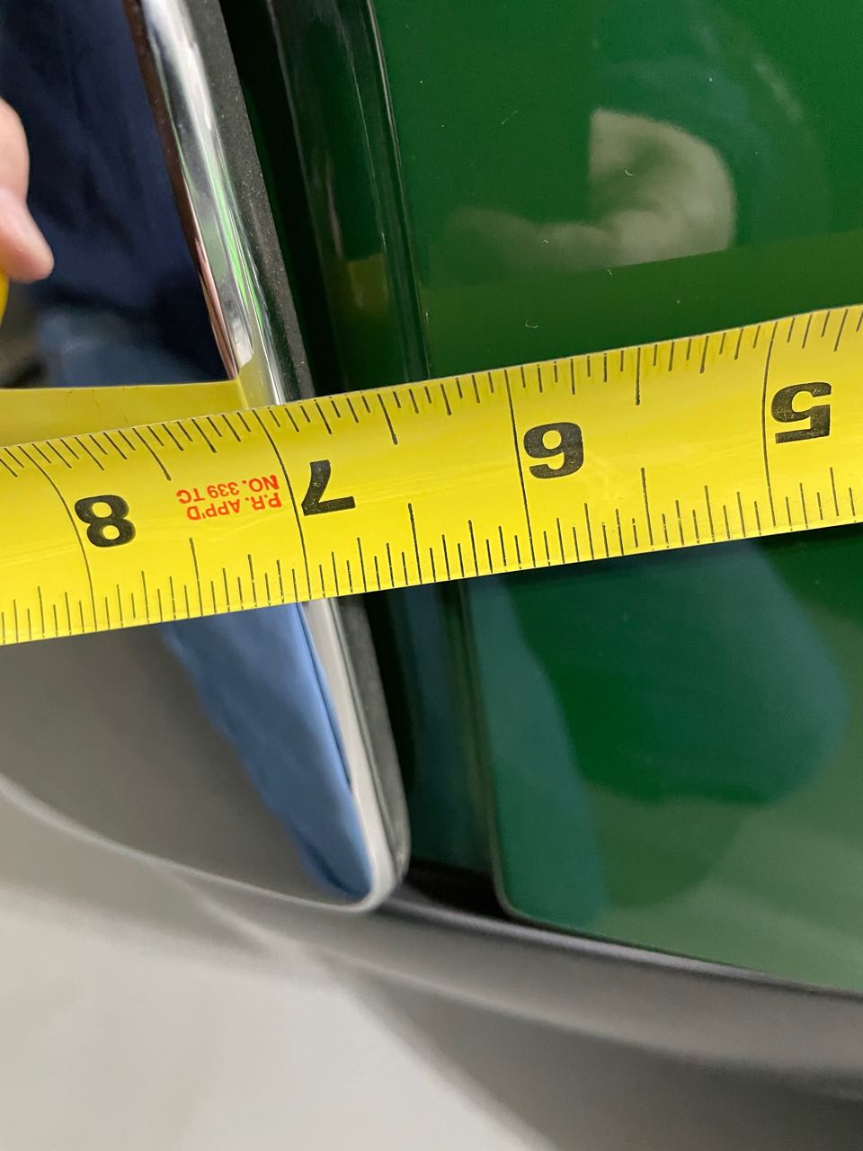

@flyinlow I went and measured mine, it looks t be 1/2". Here are some pictures:

QUOTE(Flyinlow @ Mar 7 2023, 03:39 PM) *
Looks normal.

914s vary but are uniform on both sides and top and bottom are the same distance, can be adjusted with the original soft dogbones and bolt tightness
