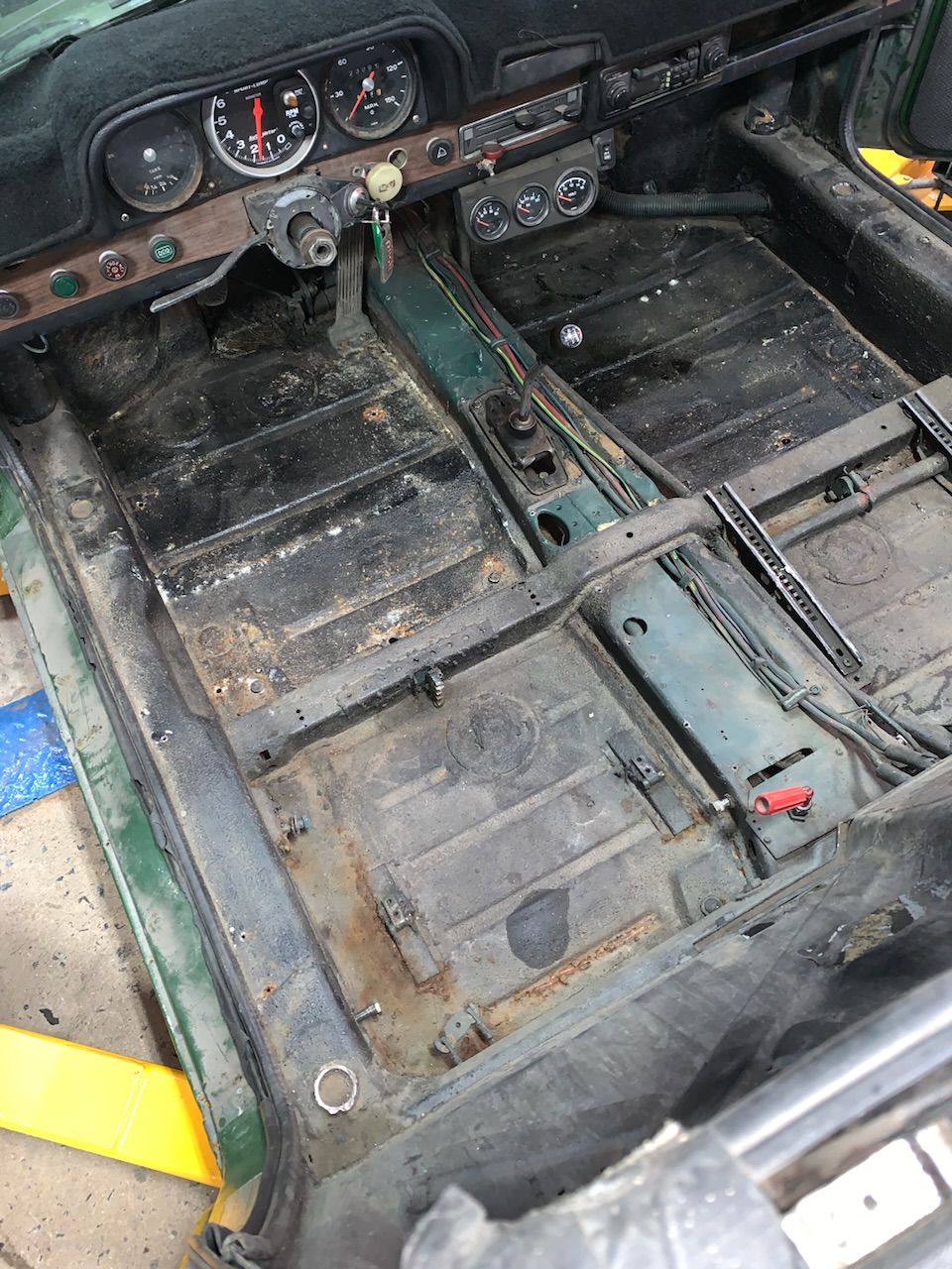

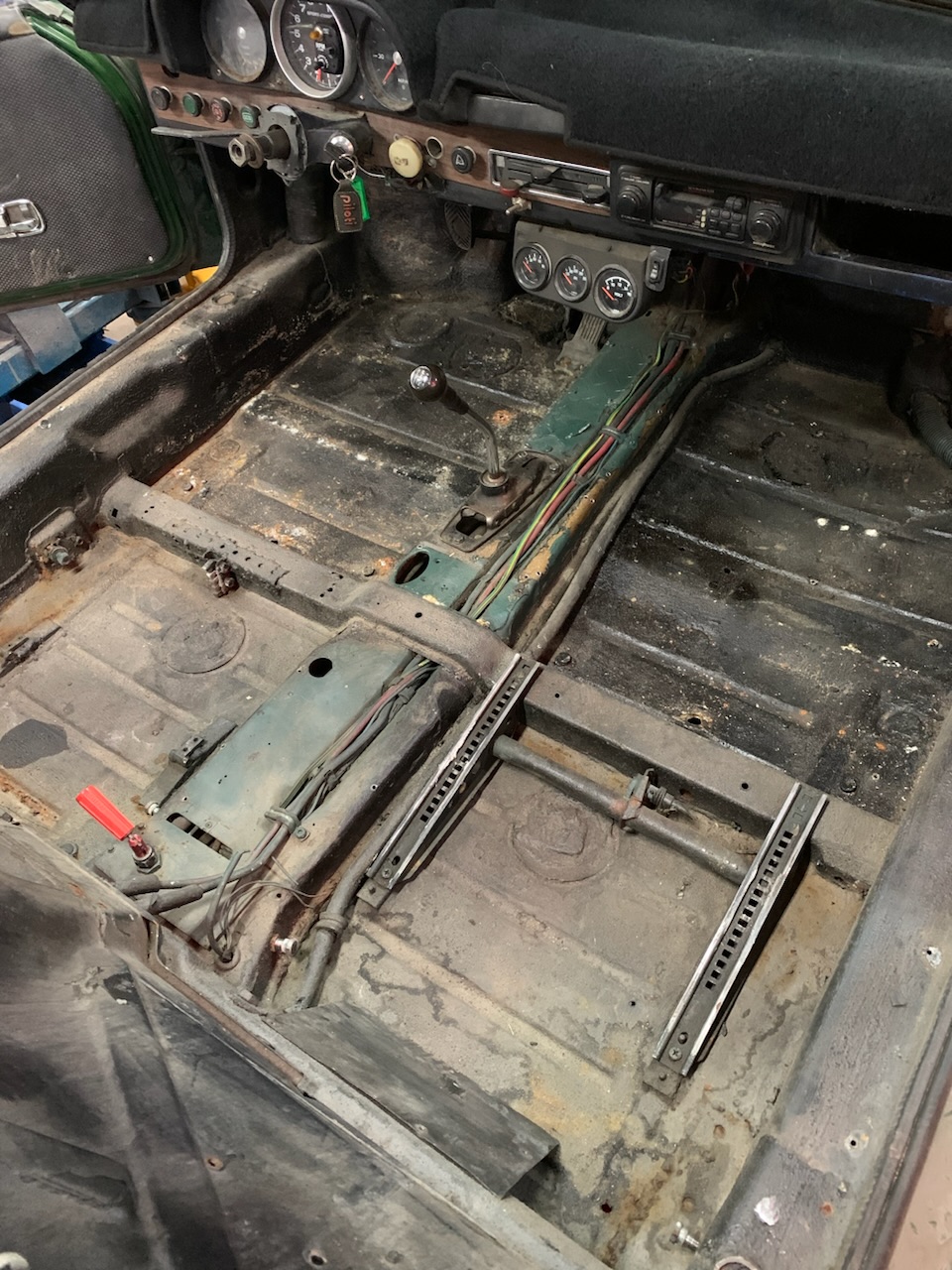

Removed the cage and racing seats. Original floors are in incredible condition. Very little rust. Most cars on the East Coast have floor pans that are rusted out. Fortunately this car came out of Arizona in 1998. Still has the tabs for the carpets.Attached Image Attached Image

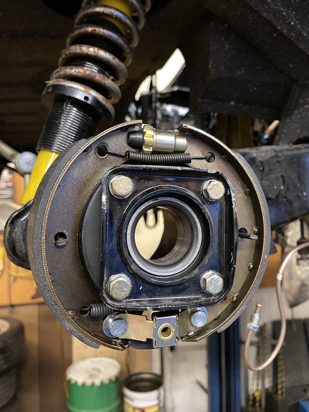

Ultimately, I’m working on making the car inspectable. I have everything under control except for the emergency brake. I’m not 100% sure how to do it. I have read several threads on how to do it and feel confident I can do it. With the car being a high horsepower 3.2 short stroke, I think I need to keep the rear brakes as they are or even upgrade to Boxster. Right now it has the brembo aluminum from an alpha.?
Any in sight would be helpful.

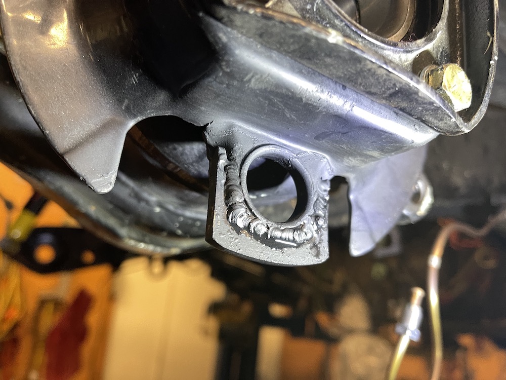

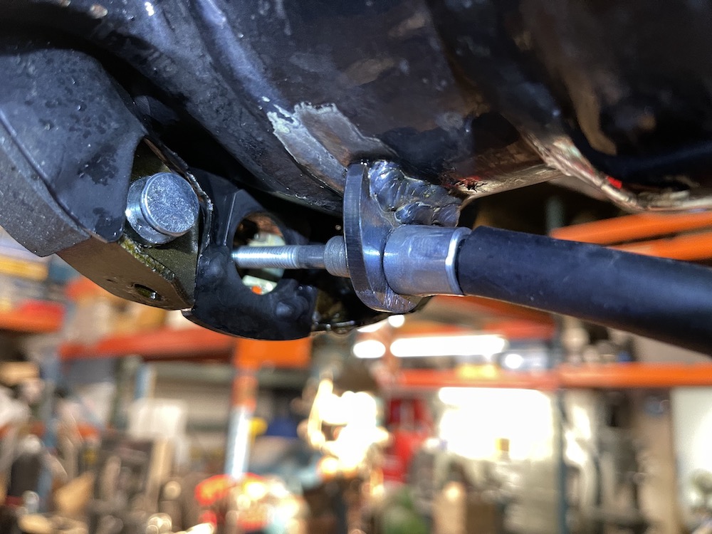

I just did the 911 ebrake swap on my 73. You can buy the backing plates shoes and hardware all new. You will have to grind on your control arms a bit to get the backing plates on there but it's not very hard. Use a VW bus parking brake cable to extend your cables. You end up with something like this.
That looks nice. Can I please ask who you use for vendor?
Matt (IMG:style_emoticons/default/flag.gif)
gnomefabtech
post Mar 13 2023, 08:22 PM
Post #34
Posts: 152
Joined: 27-December 22
From: Los Angeles
Member No.: 27,063
I think the hardware and shoes came from Stoddard. The backing plates were from ebay but I think they were new. You also need to add a bit to the backing plate to keep the shoes from spinning around. This was what I did here.

QUOTE(gnomefabtech @ Mar 13 2023, 09:22 PM) *
The brake backing plate is not substantial enough to use for the shoe stop. It would be fine if you are just using it for a "park" brake, but if you try to use it when the car is in motion at any speed, you are going to rip the shoes off of it and tear up the backing plate. You should use a big piece of angle iron welded directly to the trailing arm.
