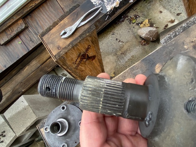

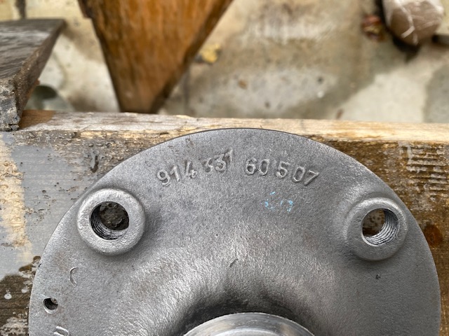

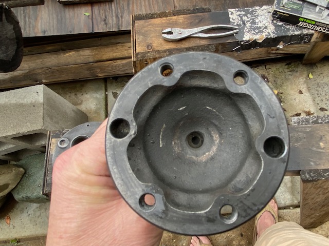

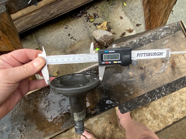

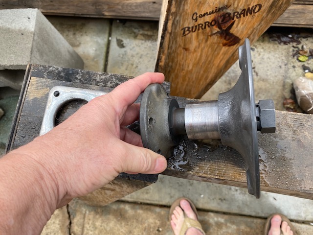

What are the 914-4 4 x130 bolt pattern stub axle specs for our cars?
Not sure what came with my roller.
I measure 93mm O.D. on the outside flange of the stub axle with 36 spline count.
I want to keep my rims with the original 4 lug pattern, but am undergoing an engine swap with much more HP and torque. So in reading all the threads with 100mm or 108mm CV's which what the 5 lug hubs guys are talking about, these won't match up with what i have currently. Are these 93mm stub axles not stock? What am I missing here? Attached Image Attached Image Attached Image Attached Image Attached Image

You have stock parts. There is NO upgrade stub axles that will work with the stock 4 bolt pattern. You have to go to 5 bolt 911 type rear hub to get 100mm or 108 CV joints.

(IMG:style_emoticons/default/headbang.gif) Grrr! Taylor Racing may have a 94mm high torque CV + 4 bolt stub axle solution. I've contacted them. Thanks for pointing out my inexperience.
