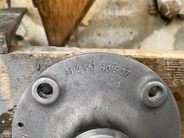

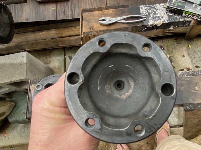

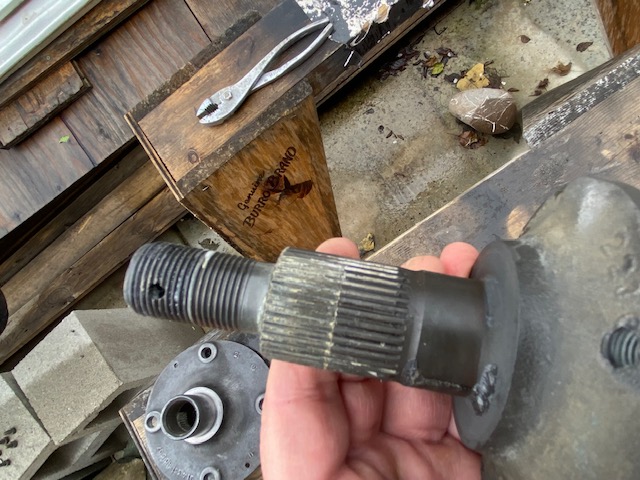

A couple of questions:
What are the 914-4 4 x130 bolt pattern stub axle specs for our cars?
Not sure what came with my roller.
I measure 93mm O.D. on the outside flange of the stub axle with 36 spline count.
I want to keep my rims with the original 4 lug pattern, but am undergoing an engine swap with much more HP and torque. So in reading all the threads with 100mm or 108mm CV's which what the 5 lug hubs guys are talking about, these won't match up with what i have currently. Are these 93mm stub axles not stock? What am I missing here? Click to view attachment Click to view attachment Click to view attachment Click to view attachment Click to view attachment
914Sixer
You have stock parts. There is NO upgrade stub axles that will work with the stock 4 bolt pattern. You have to go to 5 bolt 911 type rear hub to get 100mm or 108 CV joints.

pgollender
QUOTE(914Sixer @ Mar 11 2023, 01:46 PM) *
headbang.gif Grrr! Taylor Racing may have a 94mm high torque CV + 4 bolt stub axle solution. I've contacted them. Thanks for pointing out my inexperience.
