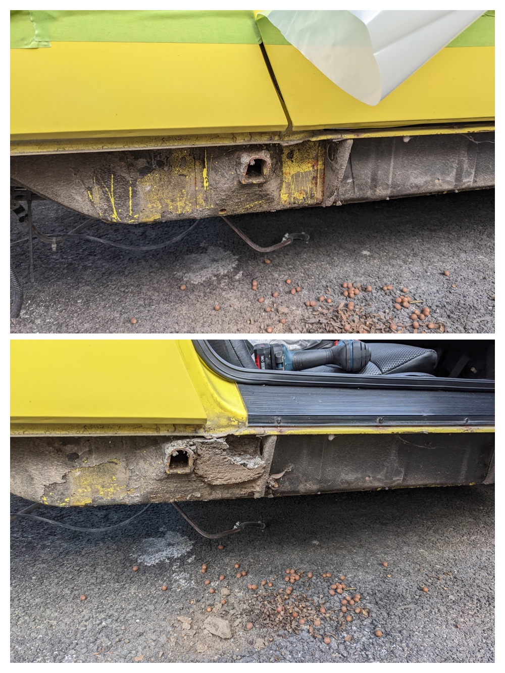

With galvanic corrosion, aluminum will lose out over low carbon steel. That’s why bolts going into aluminum engines are zinc plated. Zinc acts as the sacrificial anode giving up its electrons more easily.
Hole diameter is 3.4mm for both threshold and rocker. I just measured for you @Montreal914

My car had painted pop rivets in the rockers and plastic push pin rivets in the plastic thresholds. I don’t think the rivets were aluminum. Chips looked like steel and I definitely was not drilling into the rocker. Also I was definitely the first person to remove them. I could even tell by the ziebart spray patterns that they used a hose to get in there vs remove/reinstall. Had I known this was still a point of curiosity, I would’ve confirmed the rivet details.

The ziebart runs across the underside of the sill and the rocker… pulls apart like a freshness seal, except there’s nothing fresh under there…

I’m honestly not sure what the debate is here since this thread appears to start mid debate. I have black plastic thresholds with black plastic push pin rivets and (had) rocker panels with black metal rivets.
All holes appear ~3.4mm. I measured six of them on both sides of the car.
