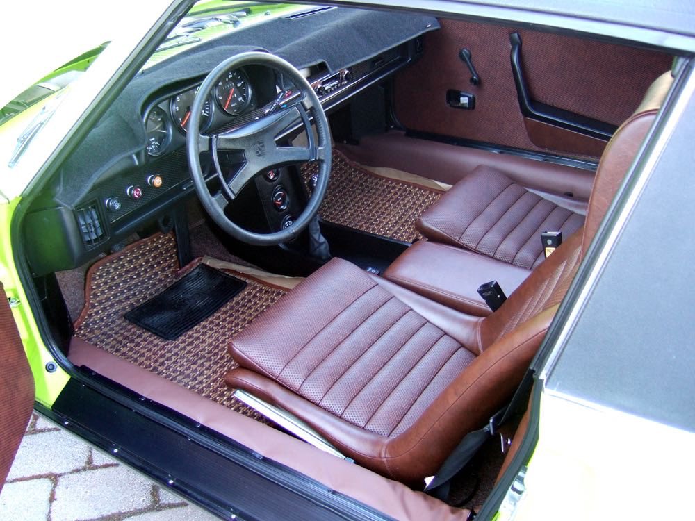

Mar 11 2023, 08:12 PM
i hate to throw another worm in the can of doubt when it comes to 74s and rivets.
but.
from low miles orig condition 74 1.8 held by dr. 914 in his collection.
fab photo documentation from your website
@JeffBowlsby (your photos mr. b?).
alum rivets looks to me?
could be a trick of the light. dr 914 could confirm?
Click to view attachment Click to view attachment i concede this one could have had its rocker panels off too.
(they all could?).
which means it ain't so original a yardstick as its said to be.
i'm going to say its just not certain yet on 74s.
i reckon they are black plastic rivets on 75s for sure.
so many i have collected for data on L jets have the black rivets thats got to be the case.
but these alum rivets keep showing up on 74s.
even steve g's extraordinary 74 2.0 had them until he "restored" the sill rivets.
dunno.

Late cars with black plastic thresholds had black plastic expanding rivets.
The same black rivets were used on black rocker covers.
Early cars with aluminum thresholds had off-white plastic expanding rivets.
All early cars had the same off-white plastic expanding rivet on the black rockers.
Clear plastic expanding rivets were never original on a 914 .....but they may have
been supplied later by Porsche as a repair part.
Aluminum rivets were never original on a 914
Back in the old days original rocker rivets could be removed and re-installed if done
with care.
If the rivet was not brittle the center pin can be pushed through and retreived
from below. The rivet could then be lifted out of the panel and later re-installed.
If this method was used on the rivets near the inner door seal the pin of the rivet
would be lost inside the longitudinal.
Way in the past I retrieved many from parts cars and reused them.
No correct replacements for early cars were available in those days.
LE rockers ?

ah.
that probably settles it.
do you reckon the rocker panels had ever been off before.
it kind of looks like the ones on dr 914s 1.8 could be black.
being plastic they catch just enough of the light to be reflective.
