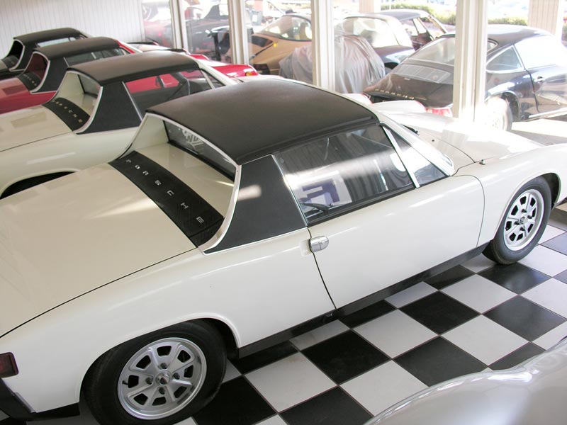

i hate to throw another worm in the can of doubt when it comes to 74s and rivets.
but.
from low miles orig condition 74 1.8 held by dr. 914 in his collection.
fab photo documentation from your website @JeffBowlsby (your photos mr. b?).
alum rivets looks to me?
could be a trick of the light. dr 914 could confirm?
i concede this one could have had its rocker panels off too.
(they all could?).
which means it ain't so original a yardstick as its said to be.
i'm going to say its just not certain yet on 74s.
i reckon they are black plastic rivets on 75s for sure.
so many i have collected for data on L jets have the black rivets thats got to be the case.
but these alum rivets keep showing up on 74s.
even steve g's extraordinary 74 2.0 had them until he "restored" the sill rivets.
dunno.

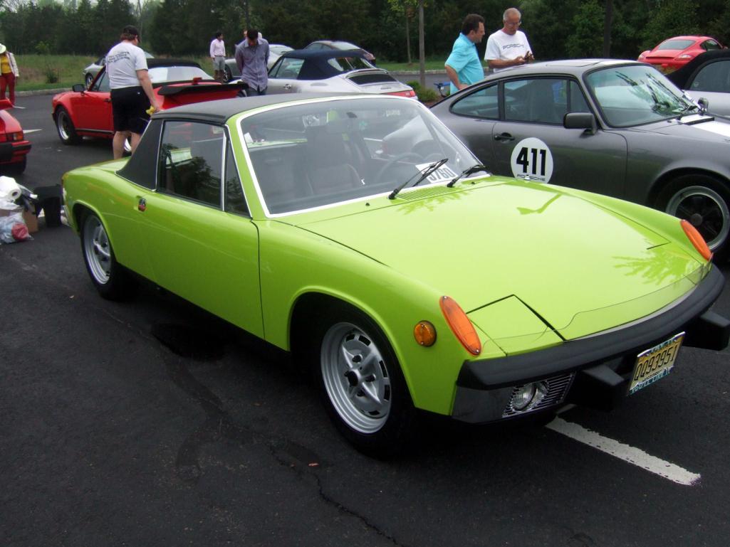

another remarkable 74 from mr. b's website.
not a restored car i believe.
(but doesn't mean the rockers haven't been off.)
hard to really decide if white plastic or alum rivet from lighting in photo.
look alum like lots of other 74s.
i am not saying earlier cars did not have white plastic.
or that later 75 and on did not have black plastic.
but it would appear something else might/could have been happening in 74 at least.
had to say yet.
i wish i had photographed mine 30+ years ago before i took them off.
ha.
