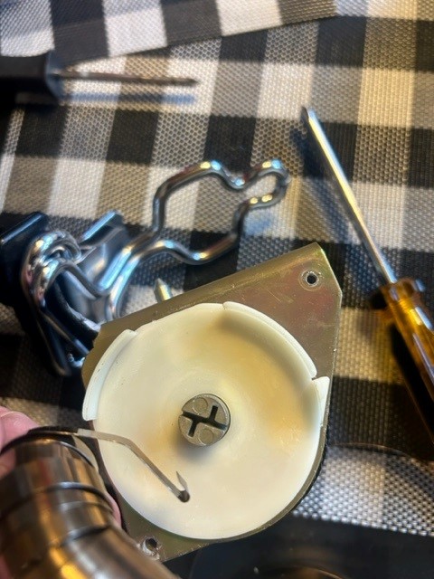

I need assistance re-winding the spring in my seatbelt. Anyone do this before? I made the mistake of taking the cover off and it went flying. Now I have to figure out how to put it back in. Where do I place the end of the spring to start it?

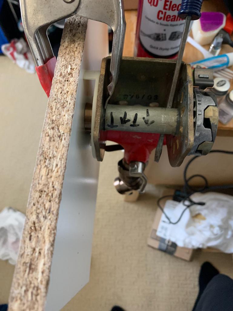

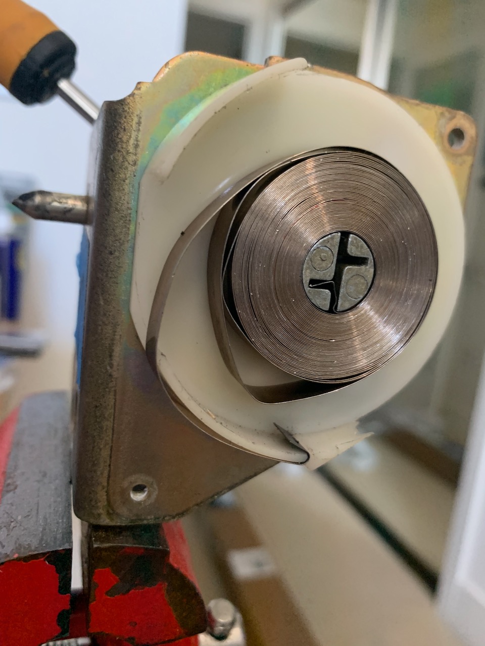

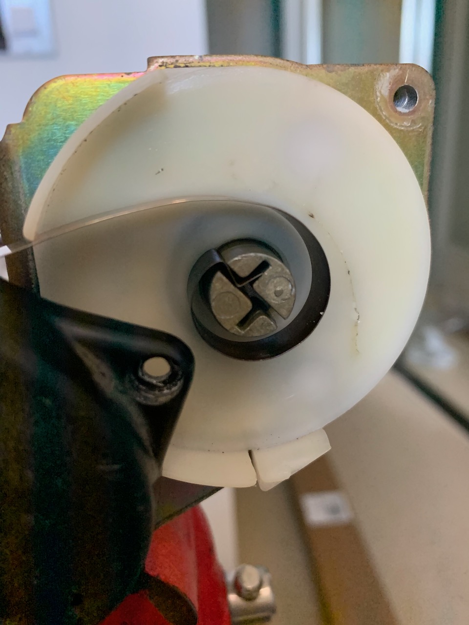

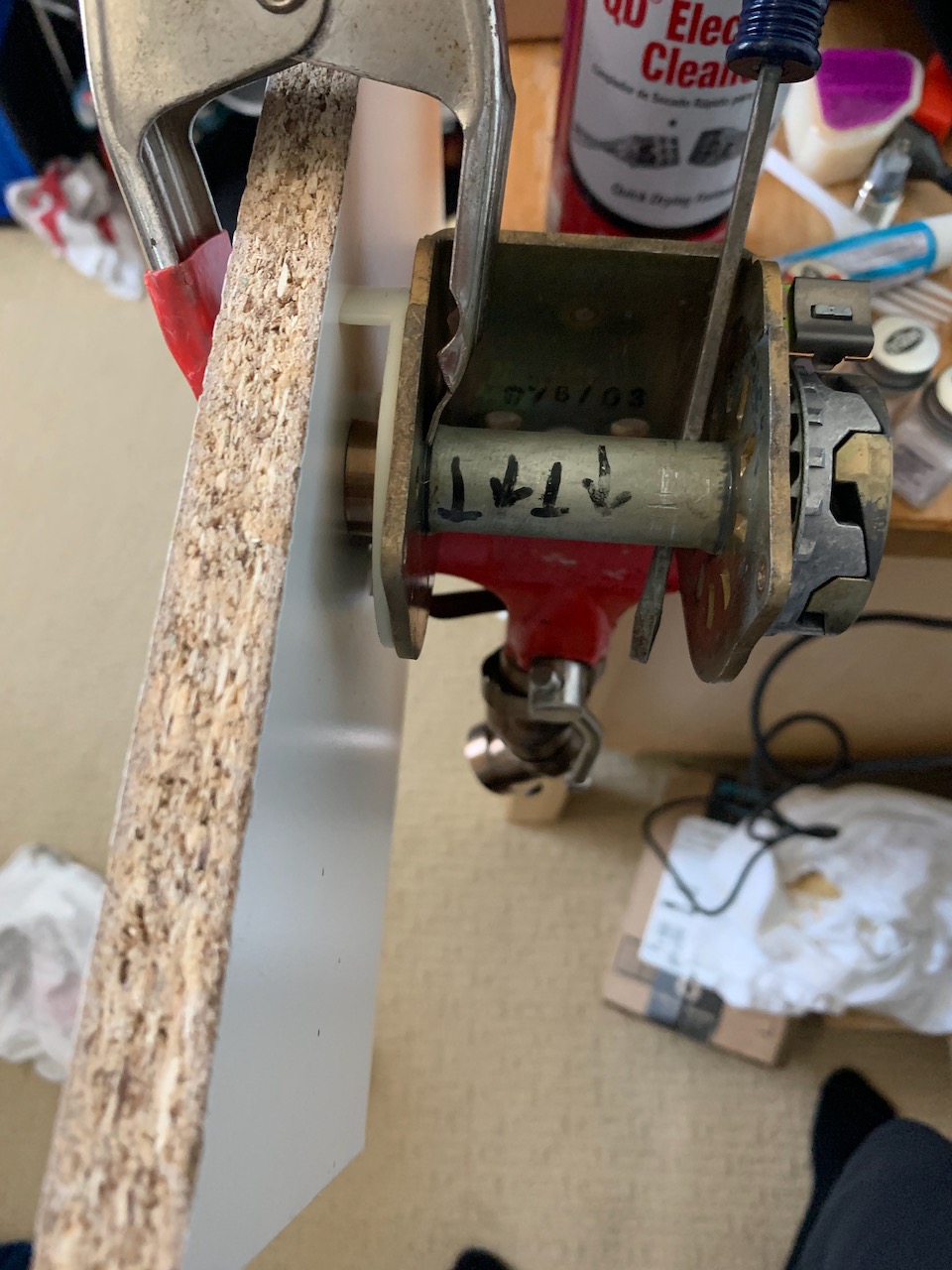

Here's how I did it - hopefully it'll make sense.
Start here:
and then I put a board held with a spring clamp to keep the spring from sliding sideways off the axle. Used two screwdrivers in the axle slot to tighten it - going 180 degrees at a time, alternating the screwdrivers so it can't totally unravel.
and hopefully, it ends like this:
