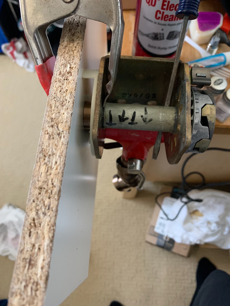

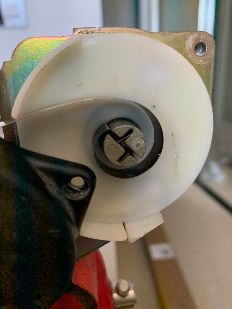

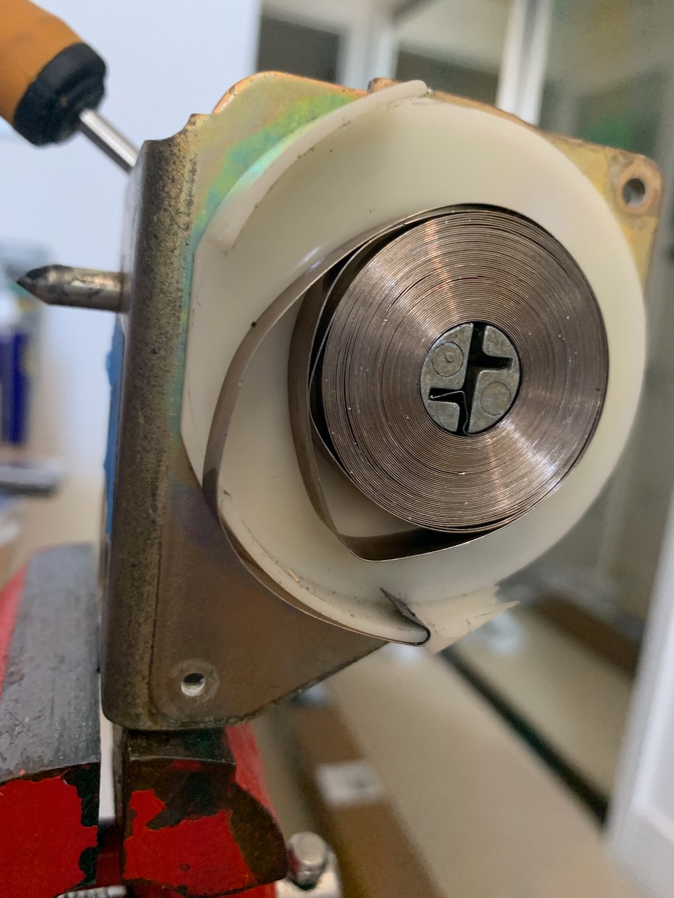

Here's how I did it - hopefully it'll make sense.
Start here:
and then I put a board held with a spring clamp to keep the spring from sliding sideways off the axle. Used two screwdrivers in the axle slot to tighten it - going 180 degrees at a time, alternating the screwdrivers so it can't totally unravel.
and hopefully, it ends like this:
