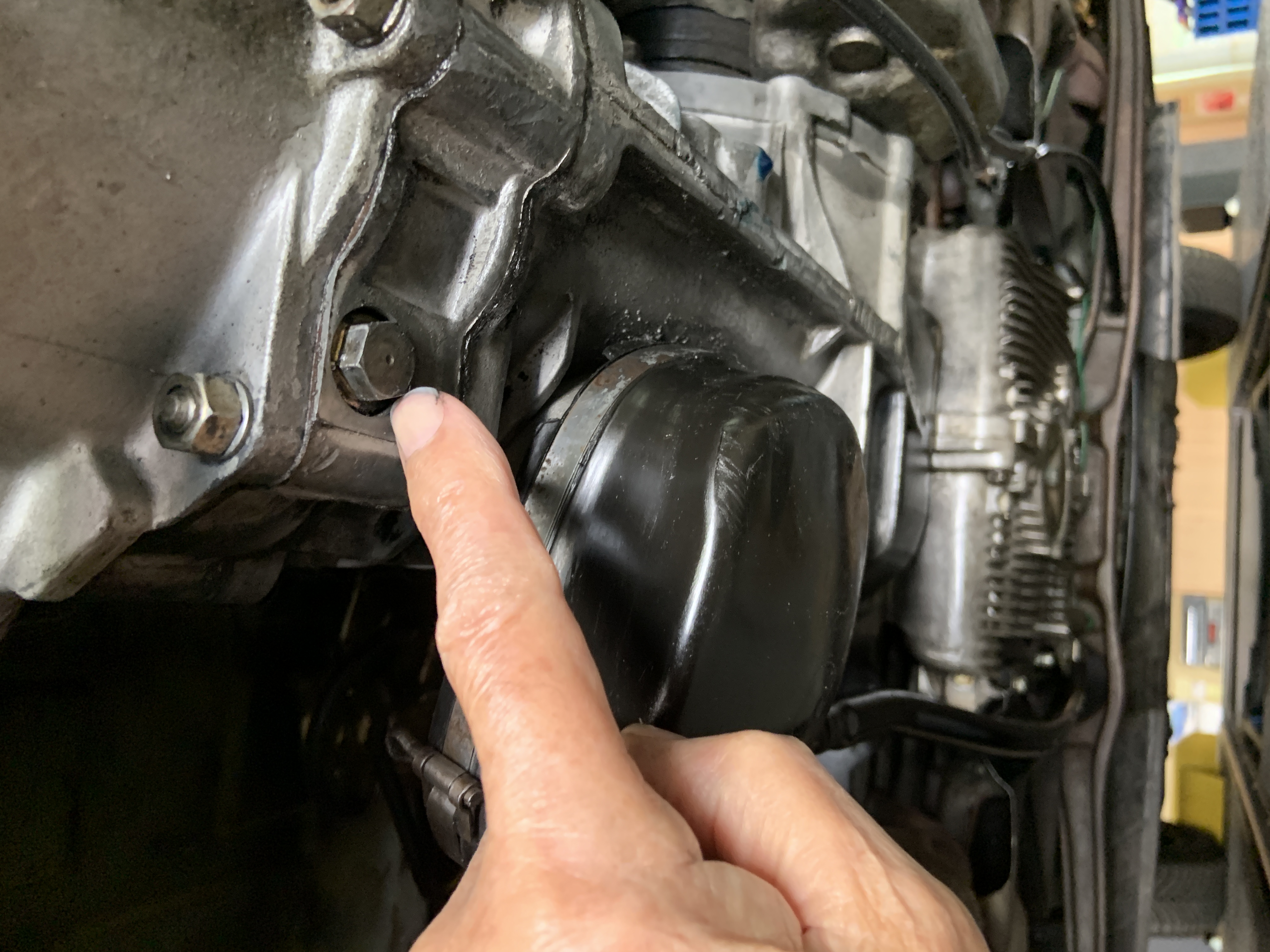

I'm changing the oil in my transmission of my 1974 914 2.0. Never done this before. What is this plug? Is it another drain plug or what? Its at the bottom of the transmission just near the transmission rod/forks boot? Thanks, Wayne
brant
post Mar 13 2023, 02:51 PM
Posts: 12,010
From: Colorado
Member No.: 47
No sir.
That is the detent package of balls and springs
Do not remove it
The drain and fill are both 17mm Allen head screws

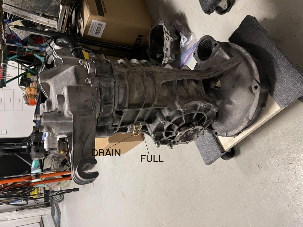

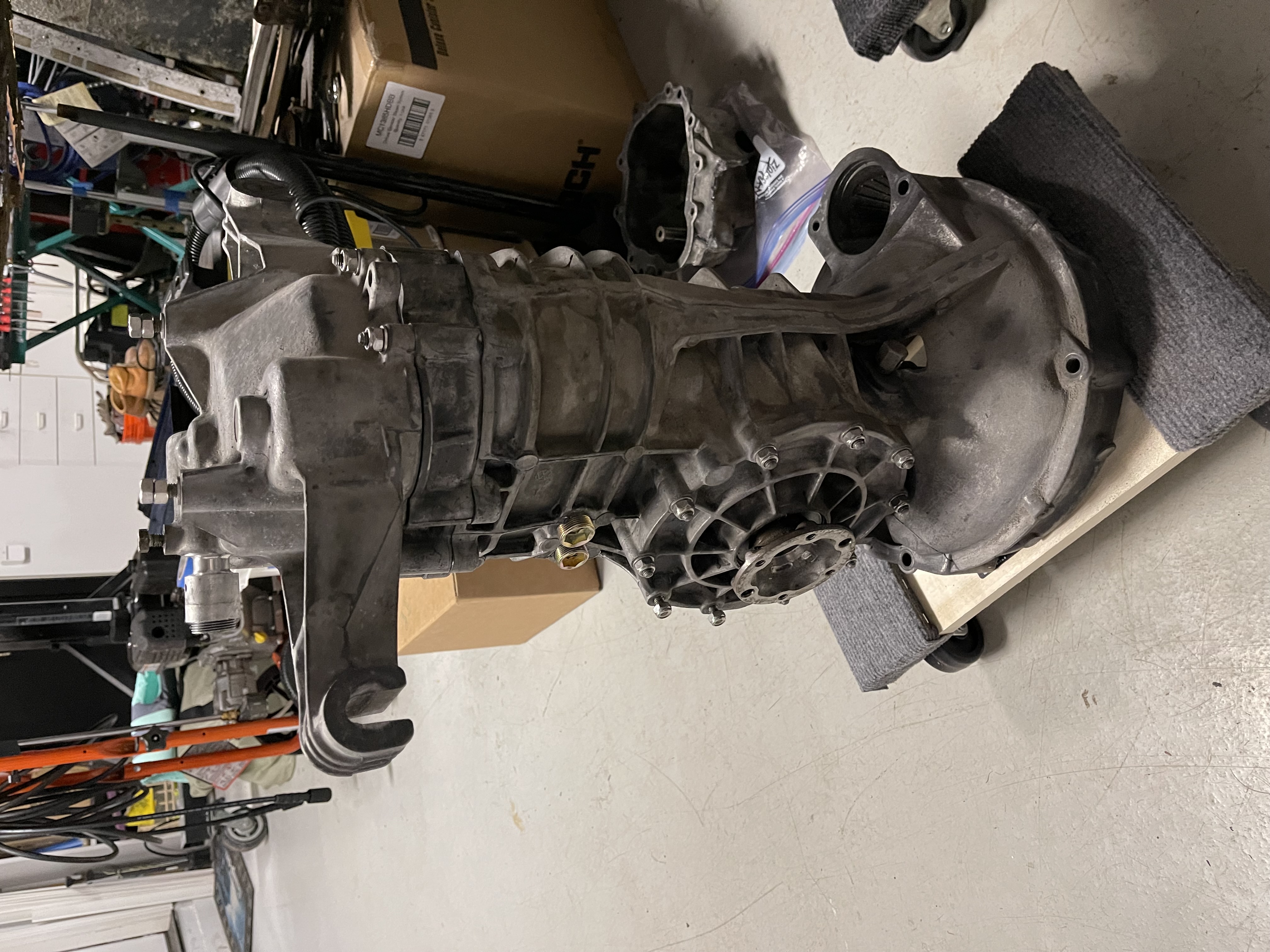

post Mar 13 2023, 06:28 PM
Posts: 172
Joined: 25-November 21
From: Portland, Oregon
Member No.: 26,107
Here's a picture of plugs just partially in-place while I was working on the transmission.
1/2" Drive 17 mm Allen Socket. Torqued to 18 ft lb.
DaveB
