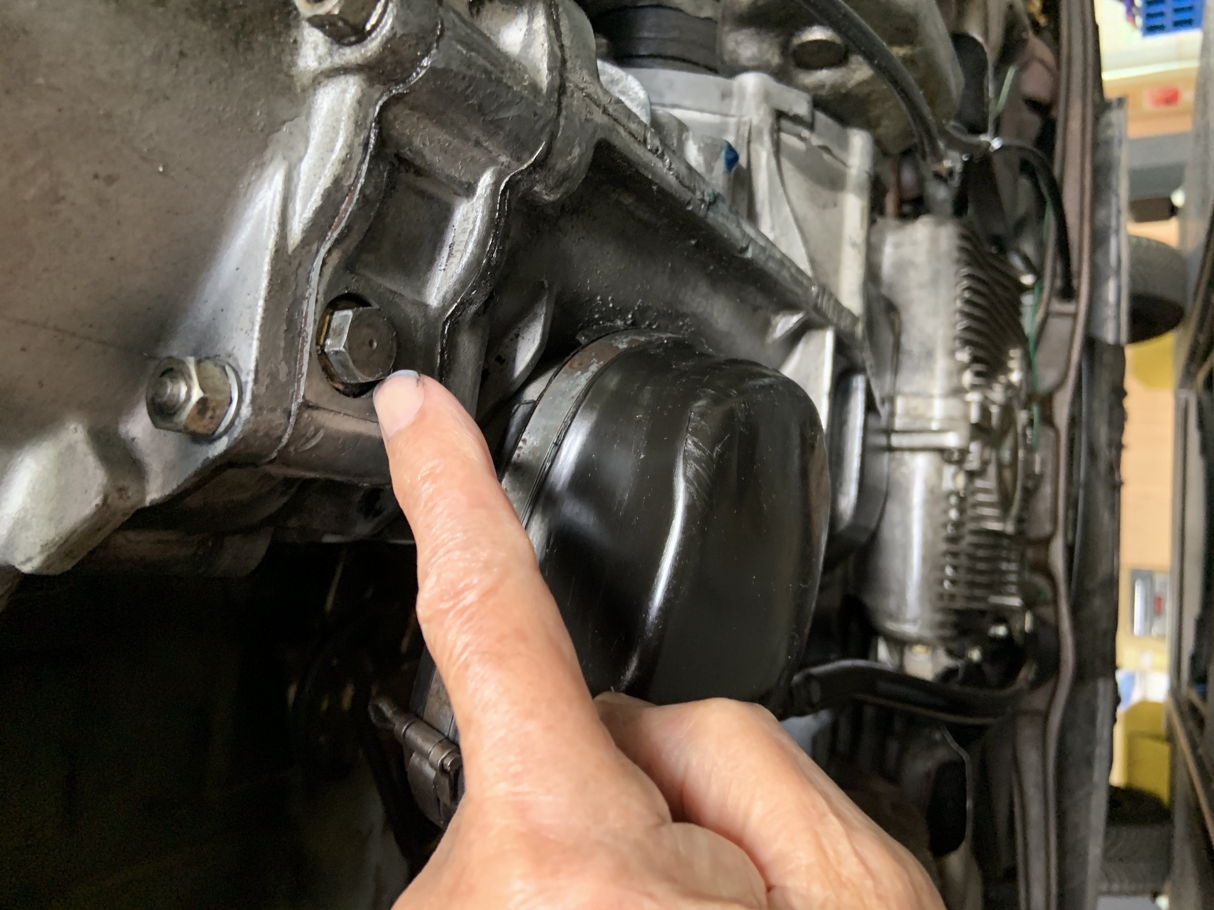

I'm changing the oil in my transmission of my 1974 914 2.0. Never done this before. What is this plug? Is it another drain plug or what? Its at the bottom of the transmission just near the transmission rod/forks boot? Thanks, Wayne

No sir.
That is the detent package of balls and springs
Do not remove it
The drain and fill are both 17mm Allen head screws

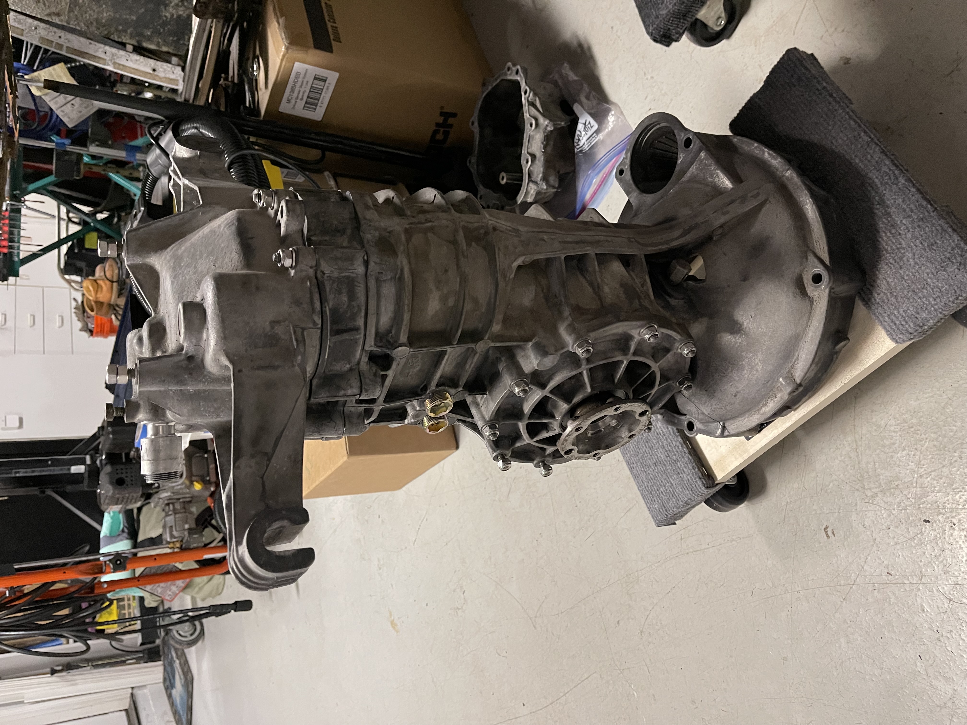

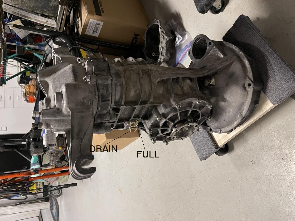

Side of transmission, passenger side.
Look for two 17mm Allen head bolts
Remove the top one first to ensure you can fill it.
Then remove the bottom one to drain it.
Fill until fluid comes out of the top filler hole…that is full.

Here's a picture of plugs just partially in-place while I was working on the transmission.
1/2" Drive 17 mm Allen Socket. Torqued to 18 ft lb.
