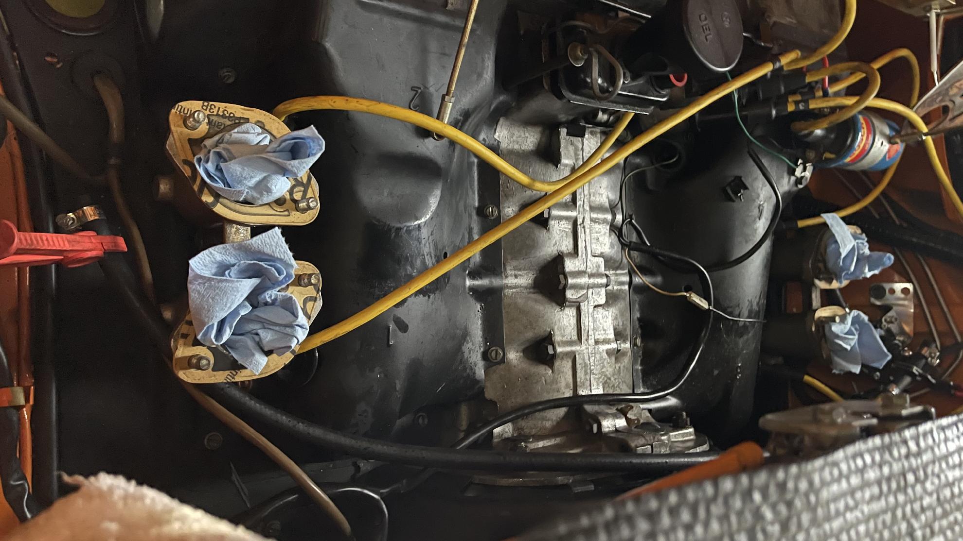

Dave_Darling   That distributor does not look to be in the right ...   Mar 19 2023, 07:51 PM
bobboinski   Distributor cap looks to be wired wrong. Or maybe ...   Mar 19 2023, 09:02 PM
VaccaRabite   Your dizzy is all sorts of awkward in that picture...   Mar 19 2023, 09:13 PM

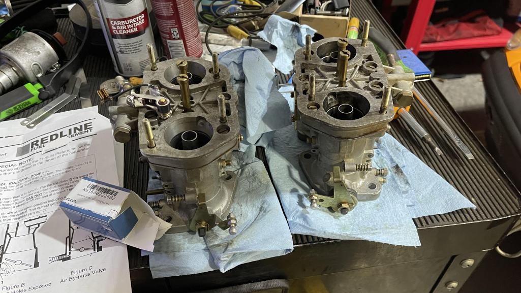

Superhawk996   Now that the carbs have been removed - you’re go...   Mar 20 2023, 08:35 PM
Type 47   Now that the carbs have been removed - you’re g...   Mar 20 2023, 09:18 PM

Superhawk996   Sorry - not trying to over simplify However tuni...   Mar 20 2023, 10:02 PM
Type 47   Sorry - not trying to over simplify However tun...   Mar 21 2023, 09:26 AM

Type 47   Idle circuit is dirty - are the carbs clean? Ha...   Mar 21 2023, 02:56 PM

nditiz1   There are definitely different levels of cleaning....   Mar 21 2023, 06:37 PM
Type 47   There are definitely different levels of cleaning...   Mar 21 2023, 08:13 PM
