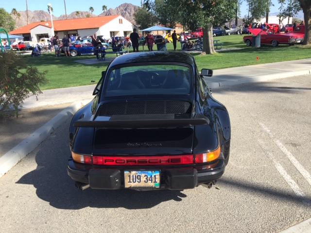

This is what it will look like if finished properly.
(IMG:http://www.914world.com/bbs2/uploads_offsite/cdn.elferspot.com-11663-1679853672.1.jpeg)

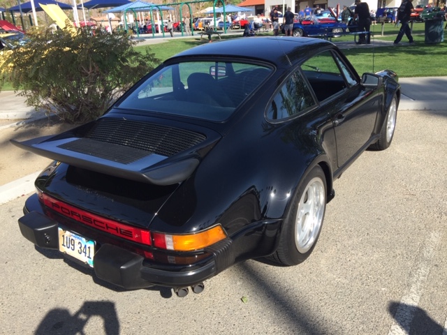

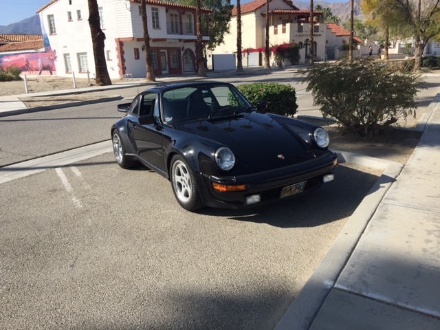

Shivers
post Mar 27 2023, 03:11 PM
Posts: 3,432
Joined: 19-October 20
From: La Quinta, CA
Member No.: 24,781
I took these saturday at our local car show. Looked at them today and thought of your targa.
