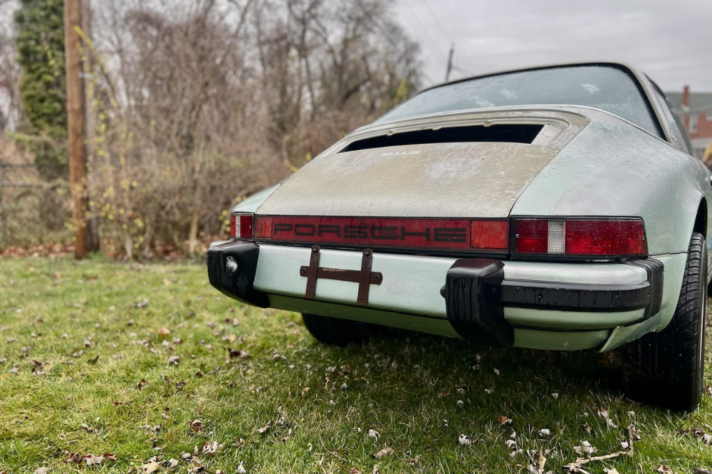

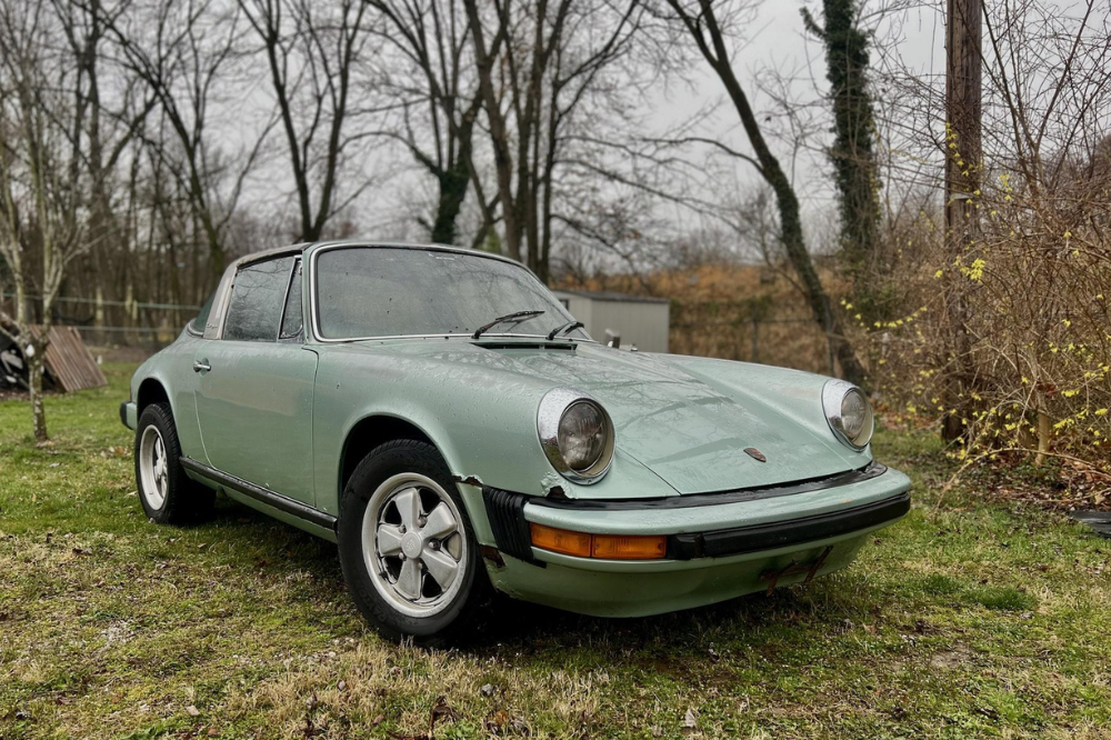

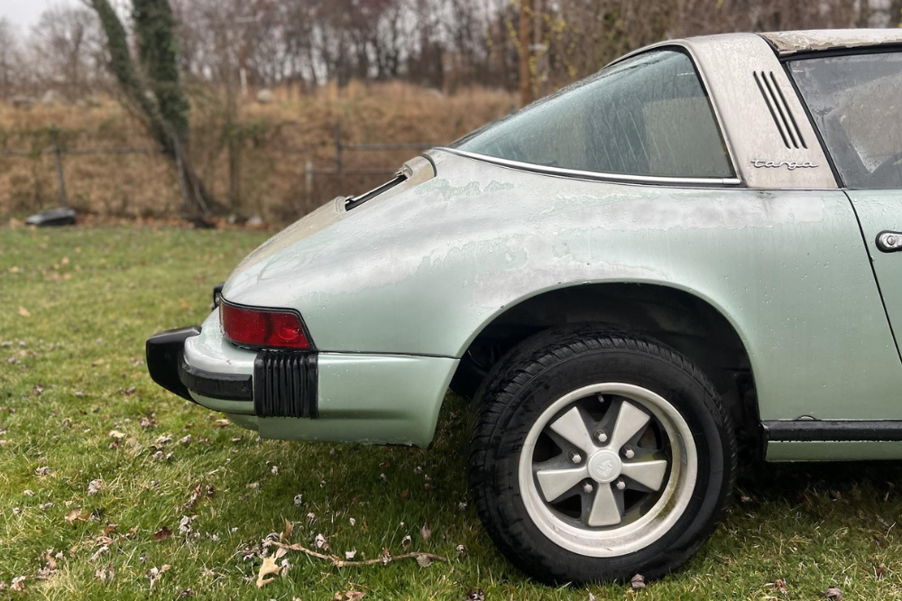

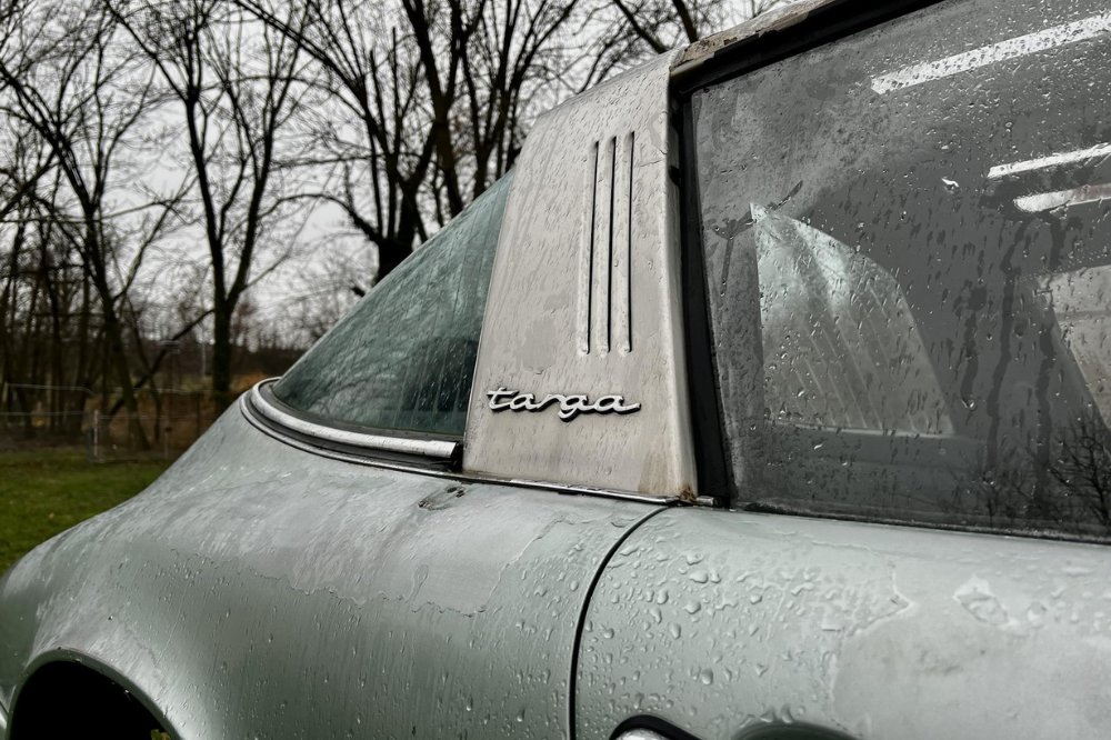

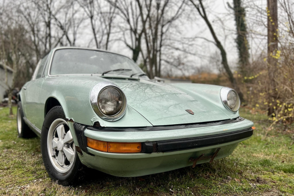

The car: This car came up about 8 miles from my house, is relatively rust free (my idea is rust free is different than most)
Being SUCH a cool car; first year G-body/Midyear, S motor, Ice Green metallic over a Targa... I simply could not pass it up.
I know mid years are kinda black sheep, but I'm pretty sure we like the black sheep around here. bye1.gif

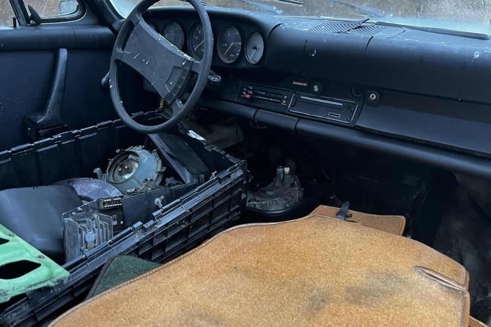

This 911 is MOSTLY complete, its missing seats, carpet, etc. (easy peasy)
It is not a roller. She is paired with the numbers match 2.7S motor and 915

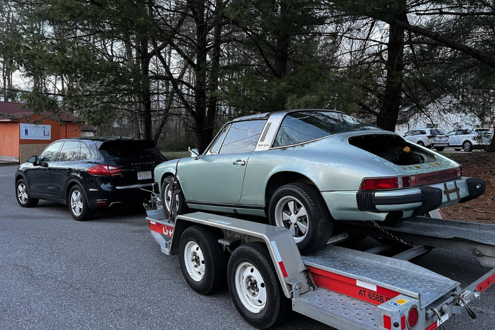

Loading up.

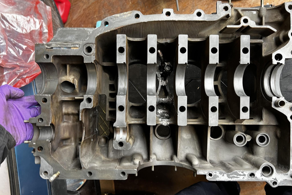

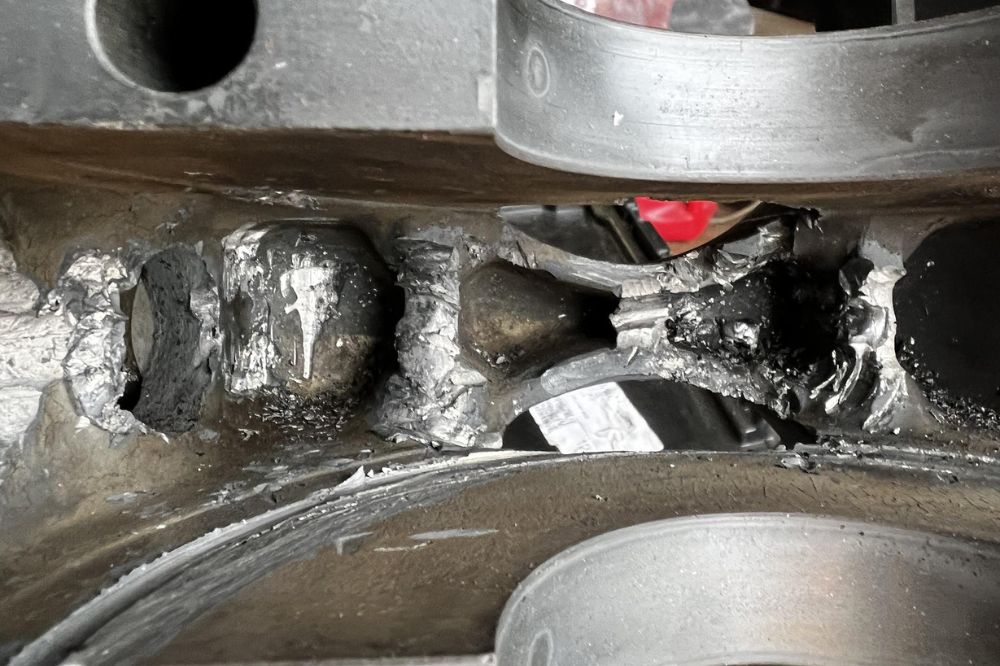

The engine suffered what I would call a catastrophic failure. Classic 2.7, right?
It appears to have thrown a connecting rod. The original case is ground down in cylinder #3(?) In the process, it looks like a push rod was smooshed into the case and the mating rocker arm snapped off.

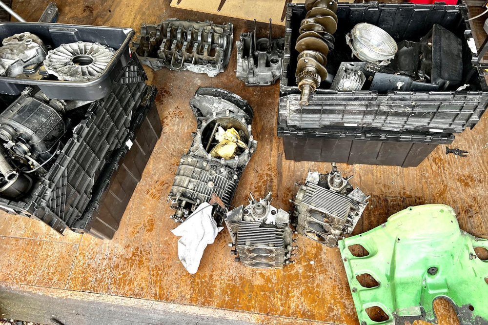

To make matters fun, the engine is entirely (and I mean entirely) dissembled into 5 bins. People love to take things apart, then just sell them, huh?
IPB Image
The good news: The bins are full of a ton of spares; Dizzys, lights, switches etc, (lots of stuff I can use for my 912 evilgrin.gif )
I suppose my main question is as simple as "Is this case savable?"

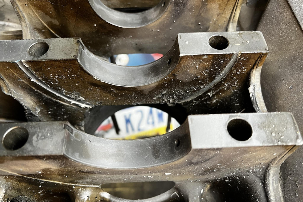

Here's some pictures of the original mag case.... repairable?
IPB Image
IPB Image
The worst half:
IPB Image

I would send the case to Ollies, in Vegas if I recall correctly. They are the best for anything /6 case
nditiz1
Jared what a find! Right here close to us!
Case looks repairable - looking at a wait time and some cost associated. Still looks cheaper than a brand new case.
Matching numbers only matters if you resell, also if you retain the bl9ck then people seem to like that so technically you can still say Matching numbers.
I vote option 3. If @mepstein does not have one on hand, jvcass up in NJ has a healthy 3.0. Great leak down for 15k. I think the CIS was not perfect for another 1k, but made it run and definitely saleable.

What's the undercarriage (rust) look like? That would be the biggest concern I would have.
jaredmcginness
QUOTE(nditiz1 @ Mar 25 2023, 07:57 PM) *
Will call ya tomorrow and go into a bit more detail. Not ready to plunk 15k down, but have been talking to Mark about this shades.gif
QUOTE(euro911 @ Mar 25 2023, 08:15 PM) *
The only noteable rust is the front suspension pan (that’s a weekend of effort for me). The frunk was wedged open, and had water and leaves sitting.
Other than that, all I can find is passenger cowl corners the passenger fender edge.
Torsion bar, quarters, floors, rockers are perfect.
Since I do rust repair as a side effort on these cars, It’s borderline a positive for me to get a car in this shape. smile.gif

Case is probably “technically” repairable but I’d be using penetrant dye to make sure it isn’t cracked from that rod punching it.
You’re in for at least $4k of case work with Ollie’s based on what I spent on a 2.4l and the case wasn’t beat up like that.
I’ll take the counter position - keep the 2.7L. So many have been swapped for 3.xL motors over the years. Eventually a nice matching numbers 2.7l is going to be a real find. Might take a long time though for that appreciation to materialize.

I think you got a deal. The case on my original 6 had water damage and the case was gone right where the oil sump screen was located. I am going to look for pics and will post the damage and repair. The original 6 case was absolutely worth saving and to keep your car numbers matching definitely worth looking in to.
moparrob
If you can find a clean 2.7 case, with time certs installed, I would build the 2.7 assuming the pistons and cylinders are usable. I know of such a case, but it is here in So. Cal. Otherwise, a certified running 3.0 in good shape will currently set you back about $15,000 with today's prices.

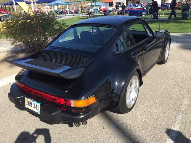

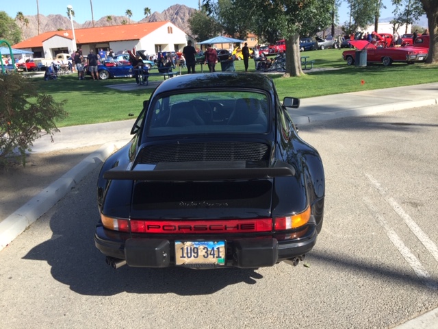

Shivers
I took these saturday at our local car show. Looked at them today and thought of your targa.

jhynesrockmtn
Love the color, targa and the fact it is still a narrow body middie. I'd focus on the rust repair, paint, interior and other mechanical bits and source a running motor. Set the matching numbers one aside and rebuild as time and $'s permit.
