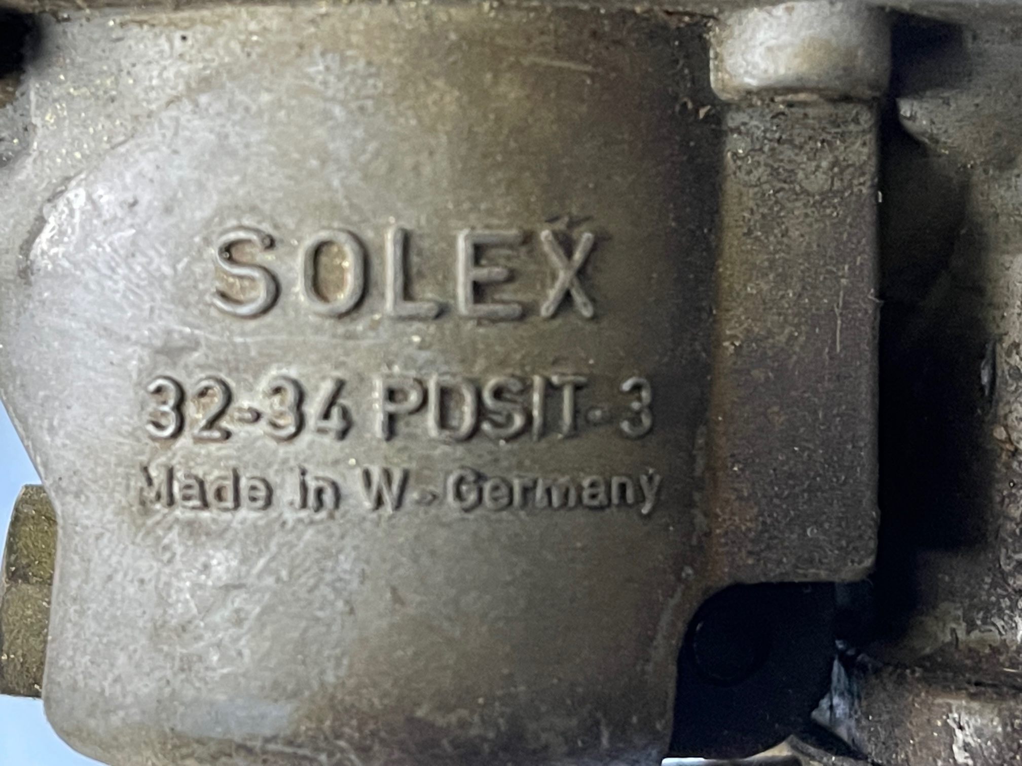

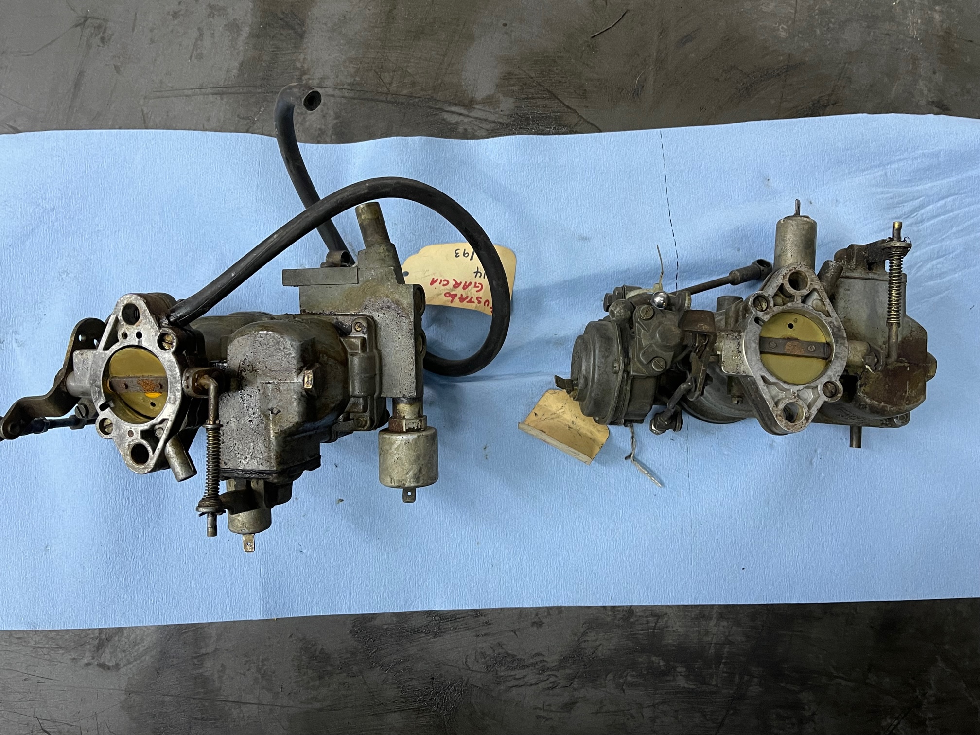

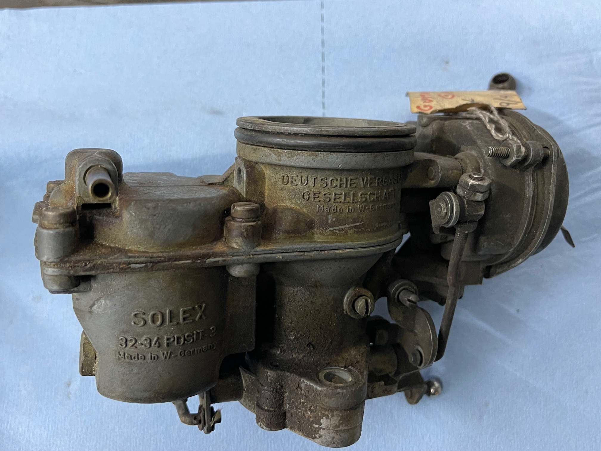

I’m told these Solex carbs came from a stock European delivered 914. Anyone have any info?

negative.
only one euro 914 had carbs - 74 + 75 1.8
40 pdsit.
could be wrong, but those might be off a type 3. maybe.

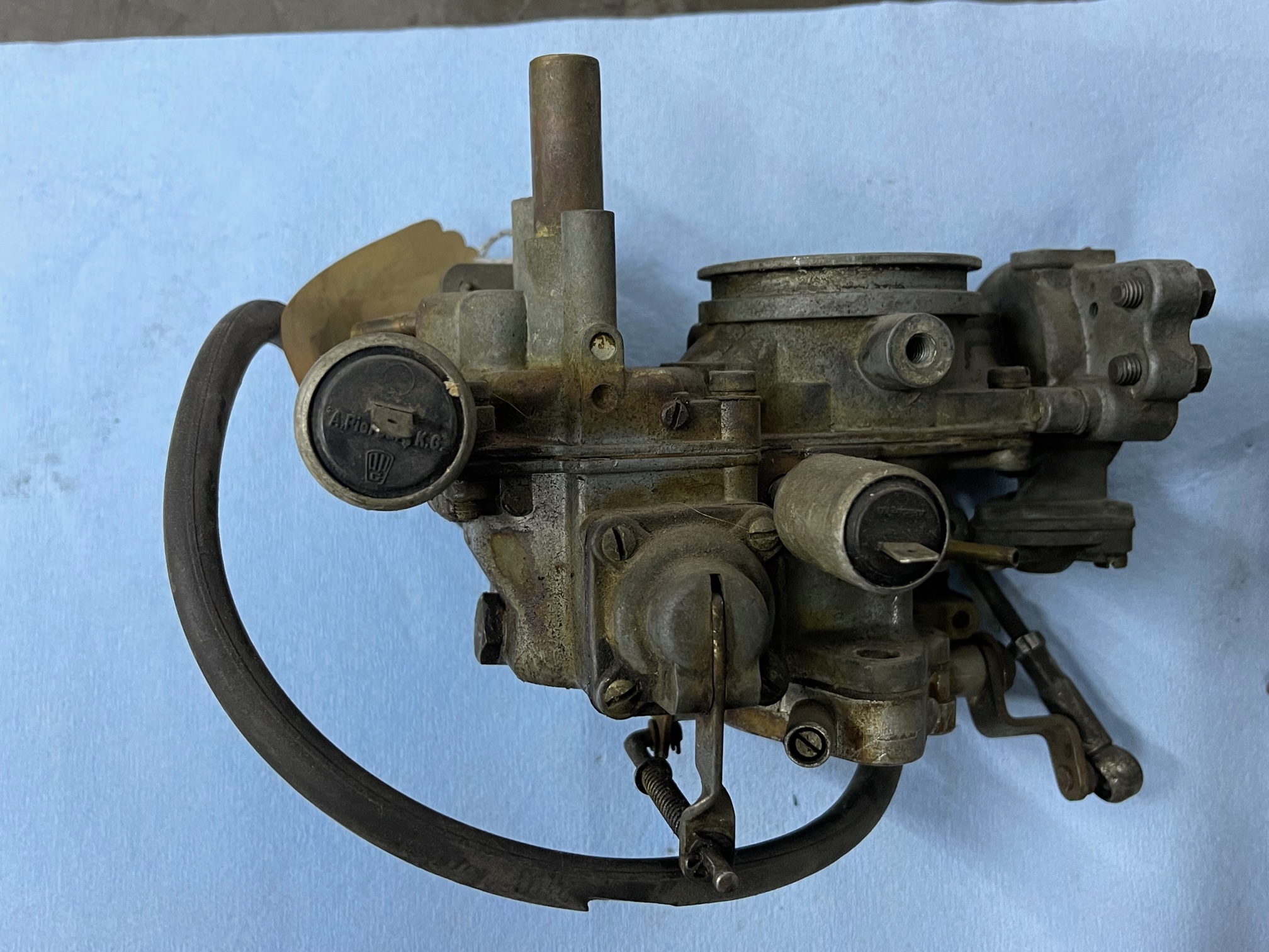

that extra solonoid hanging off one of them is pretty weird though.
nothing ever like that on the aussie twin carb pancake type 3 down here.

they are off a bus.
us version.
i just googled it.
the extra solonoid is something to do with EGR or early pollution gear in USA.
the euro stuff never had a carb like that one with the extra bit hanging off it.

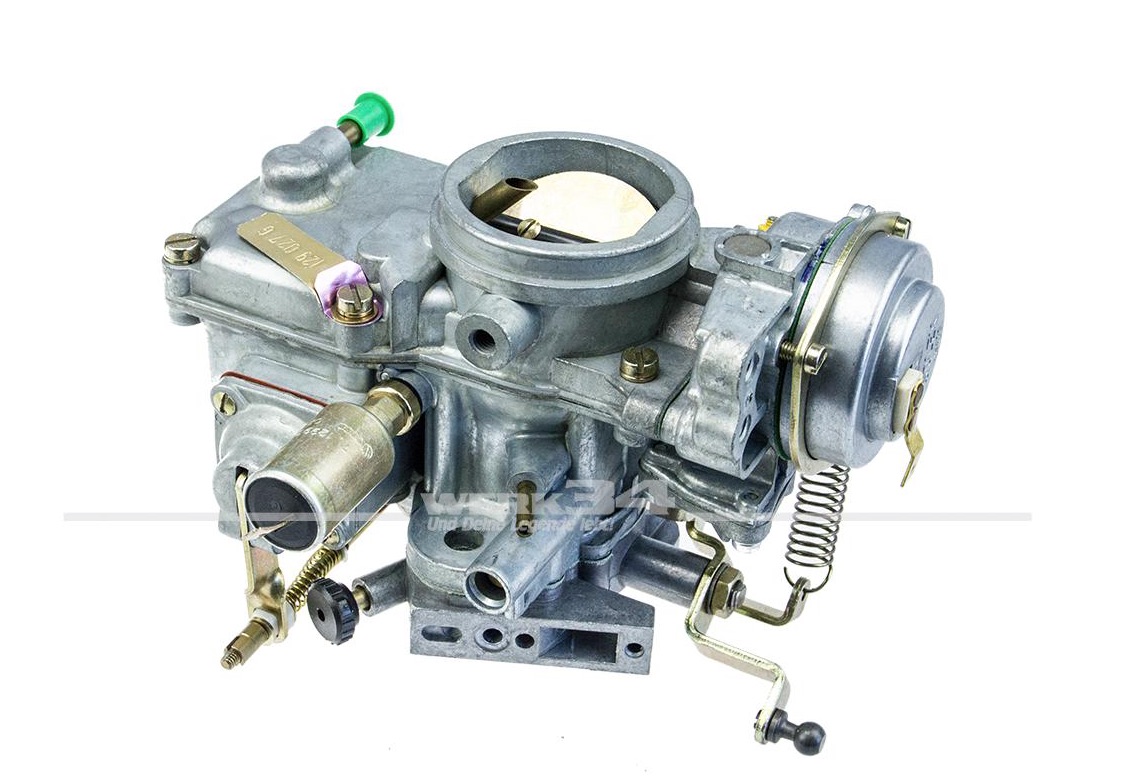

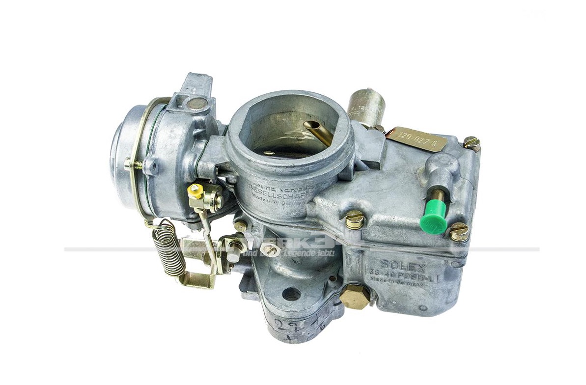

this is what the euro 914 1.8s ran.
don't think they are that easy to find.
think the story is normally were on a type 4 VW industrial motor!
(yikes the euro 914 was a truck engine (IMG:style_emoticons/default/biggrin.gif) )
i did a bit of poking around a few years back on the old AN engine front and had this on file. don't think there are any of these carbs floating around in aus. i did have a look around a few years back (was a back up plan in case my L jet did not come out of its coma (IMG:style_emoticons/default/biggrin.gif) ) might be a few in some back yard sheds in germany?

The Solex 40PDSIT AKA 36-40 PDSIT were the carbs used on the 914 AN engines, but the Solex 40 PII-4 used on the 356 & 912 and Super V engines are superior.
The Solex 32-34 PDSIT-2/3 could have been used on VW engine for the 311, 411 and vans.
