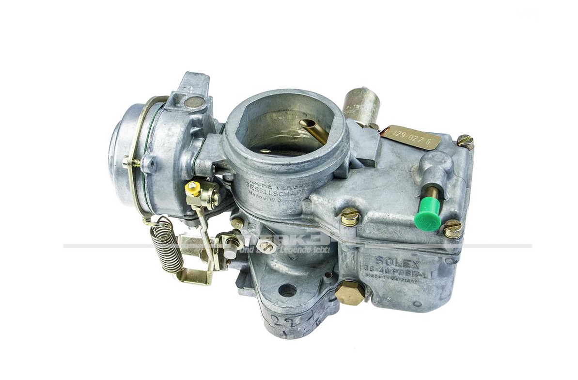

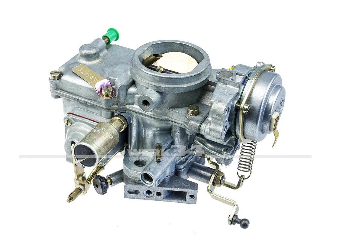

this is what the euro 914 1.8s ran.
don't think they are that easy to find.
think the story is normally were on a type 4 VW industrial motor!
(yikes the euro 914 was a truck engine biggrin.gif )
i did a bit of poking around a few years back on the old AN engine front and had this on file. don't think there are any of these carbs floating around in aus. i did have a look around a few years back (was a back up plan in case my L jet did not come out of its coma biggrin.gif ) might be a few in some back yard sheds in germany?

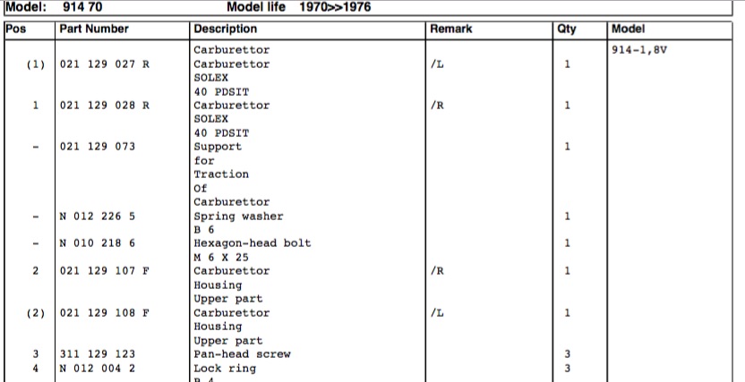

davep
The Solex 40PDSIT AKA 36-40 PDSIT were the carbs used on the 914 AN engines, but the Solex 40 PII-4 used on the 356 & 912 and Super V engines are superior.
The Solex 32-34 PDSIT-2/3 could have been used on VW engine for the 311, 411 and vans.
