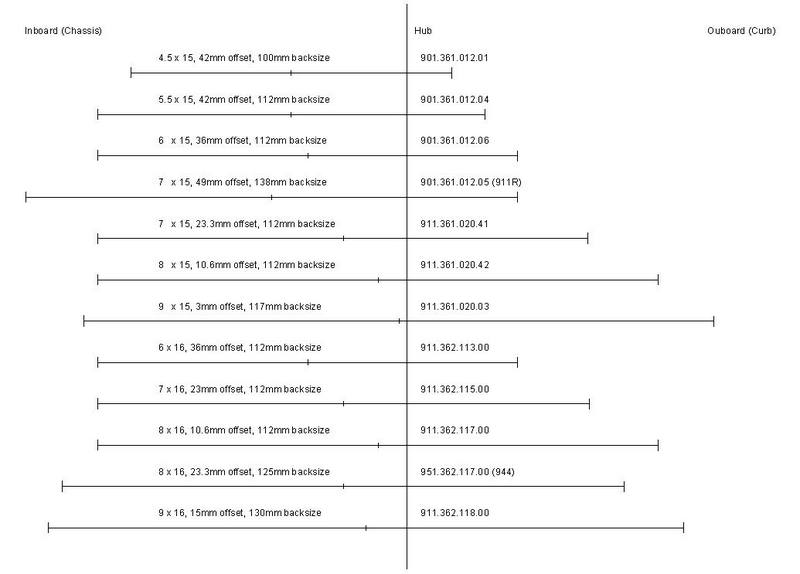

9J ...15s or 16s ?? 15x9s not so much..

QUOTE(sixnotfour @ Apr 2 2023, 09:41 PM) *
Great chart! Does anyone know the inner wheel well to fender lip dimensions for the RD and AA GT flares front and rear?

wheels don t vary , flare lips do..
Yes measure to outside of flare ,lips may vary...

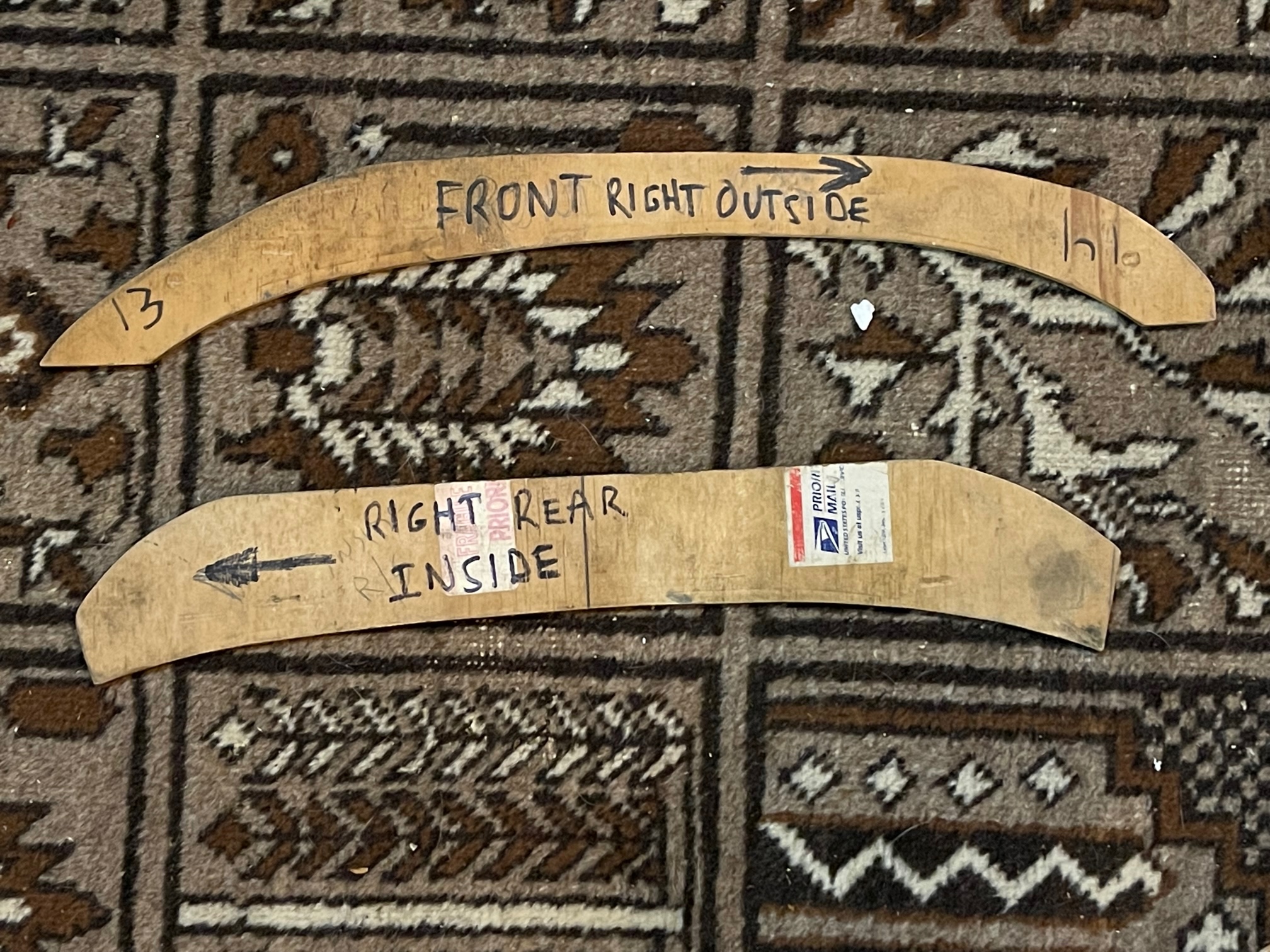

Should be fine. I have some wood templates that Rory made. It helps you bend the lip into a U shape instead of just trimming it short. I’ll post pics.

Rory's pic and info. I still have to dig up the wood templates.
"The flange is turned up, not trimmed.
I traced the curve of the wheel opening and cut a piece of 1/4" plywood to conform to that shape. We then clamped it to the inside of the fender and shaped it (body hammer) as you might find on a standard fender. This adds strength and doesn't take away too much tire clearance.
As for the wheel/tires in the rear .... no spacers. I have about 3/4" space on the outside on either side. Add 21mm spacers ? at that point it would be TIGHT.
On the inside each has about 1/2" clearance. I don't think 9" wheels will fit. Can I size up from a 225 to a ? 235 , 245 ? on my 8" sixteens ? don't know."

These are the wood templates that Rory used to turn up the inside of the flare. It gives a bit more clearance and keeps the edge of the metal away from the tire. It does change the profile to more of a folded over edge.

QUOTE(mepstein @ Apr 6 2023, 08:40 AM) *
Thanks for the suggestion.

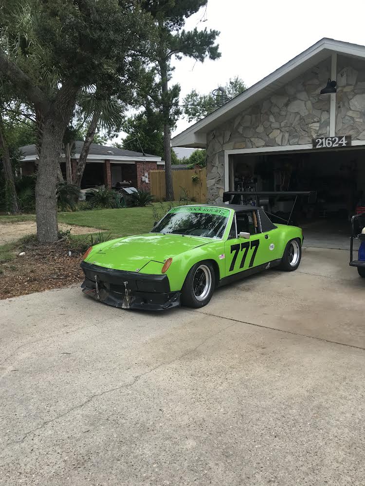

Steel flares, running 7 & 8s 15 maxilite's with 1/2 spacer on fronts.Attached Image
