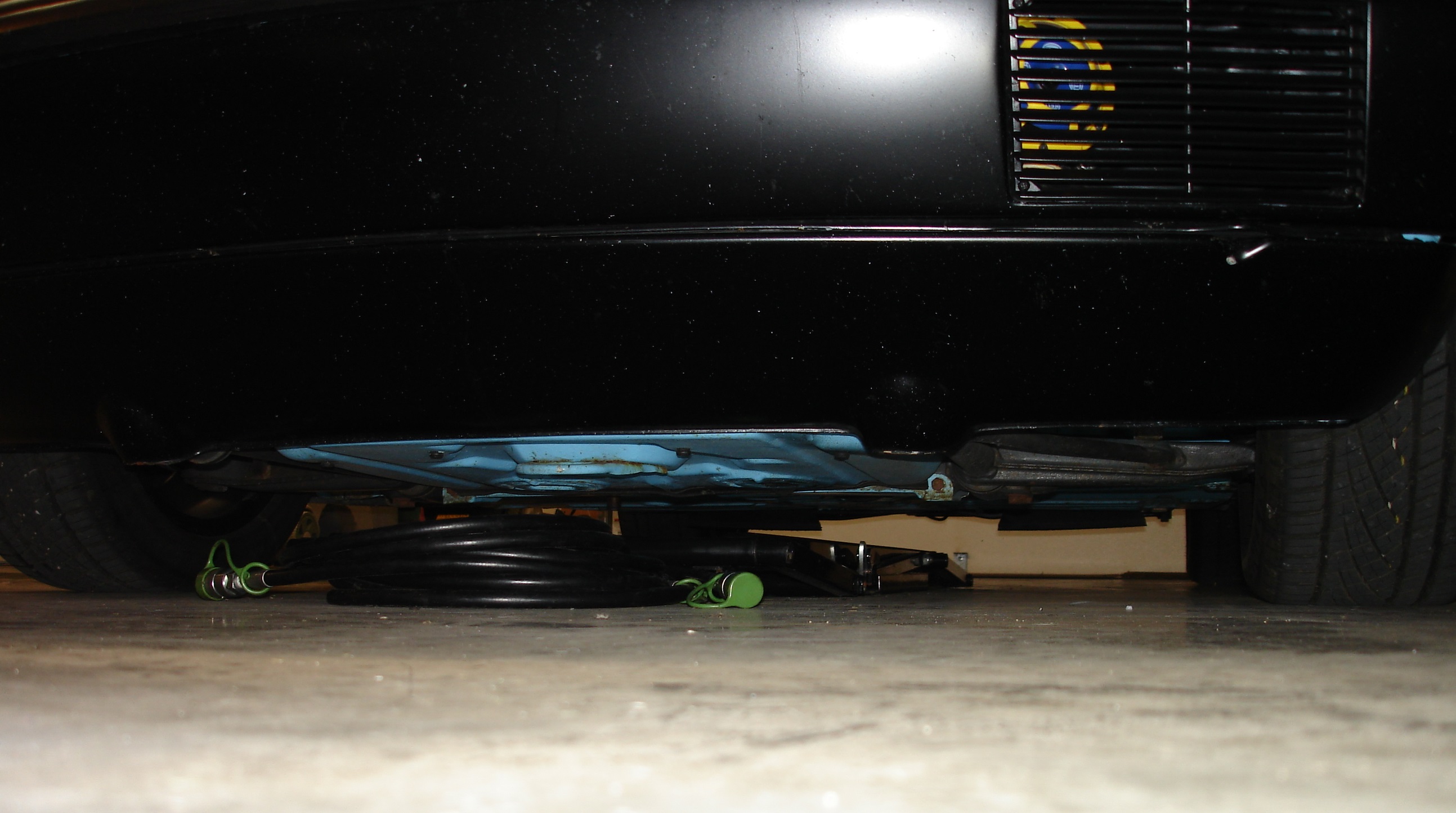

Have the Quickjack 5000 and Do not like the rubber blocks. I tried ONCE stacking them and the car almost fell off to the side.
Glad you did not have that problem.
I cut a couple wooden blocks to fit into the Quickjack trays, Very solid lift.
when pulling the engine, all I have had to do was remove the air filter housing. left the rear valence on.
Always store them under the 914, just put chalk marks on the floor where they go, coil the hoses in front. ready to go. easy to pull them out with the suplied tool to position them.
I have put tape marks on the Quickjack to line up with the original jacking points on the car, easy setup.
frequently leave the car in the air on the Quickjack for extended periods, winter projects.
