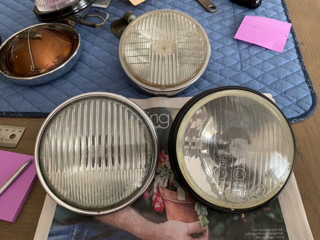

My "collection" of lights is a mixed bag: Chrome 118s with H3 bulbs and clear fog lenses are on the car (lower left in this picture):
The H3 bulbs draw 55 watts each. Since these are used mostly as DRLs, I may try to find a LED H3 replacement. Other lights in this picture are a 914 Hella 118 driving light (lower right), and a Cibie 43 ("Tango") fog light (upper center). The Hella driving lights used to be available at Performance Products for about $50, Cibie lights were about the same.

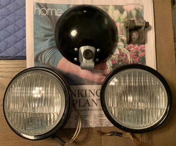

I recently cleaned up an old set of the original 115 fog lights--new lenses ands seals, repainted bezels, but no bulbs...
I remember these being pretty bad--and they would still pull 35 watts each. Maybe I'll go with a set of Spokeworks' LED boards later.

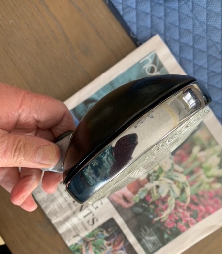

A quick size comparison between the 115 and 118 lights--note the width of the bezel:

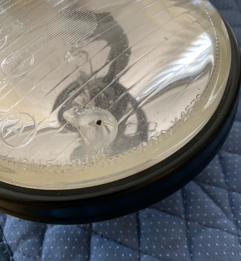

And yes, that's a chip in the 118 driving light (IMG:style_emoticons/default/icon8.gif)

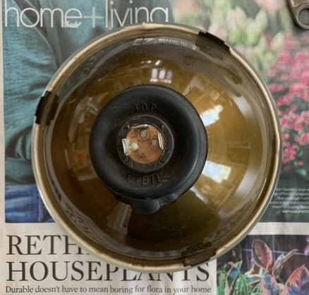

And not sure why, but on these lights Hella bonded the lens to the reflector using some kind of hard white stuff:
It appears to be the same stuff Cibie used to assemble their headlights back in the day:
While replacement lenses are available through Audette's, fixing the light will likely involve braking out the original lens and using one of 914Rubber's seals with the replacement. More on this later...

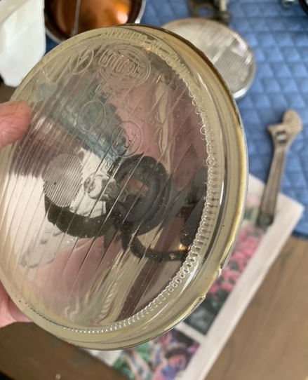

One other note--in messing with these lights, I found that the old Cibie 40 ("Tango") lens/relector assemblies are a pretty good fit for the Hella housings:
The Cibie unit is top center in this pic:
Another option that's only a little more work: the Cibie lens assembly fits the Hella 118 bezel. (IMG:style_emoticons/default/idea.gif)
I had these Cibies on a Volvo 240 while living in Seattle back in the day--my first experience with halogens: LET THERE BE LIGHT!
Might eventually try these on the 914 too. While the H2 bulb holder can be a little tempermental, they provide excellent lighting for their size....
